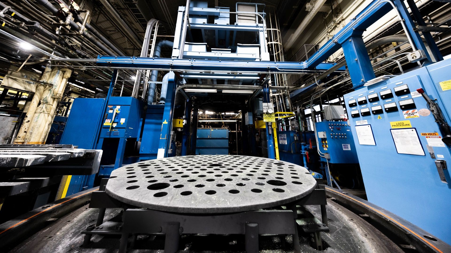

“AUGUST 10, 2026 By Chris Norris; A large steel-alloy inverted half dome descends from the ceiling in Plant 2 on the Lynn Component Manufacturing (LCM) campus — one of 10 ovens that treat parts made at GE Aerospace’s sprawling complex in Lynn, Massachusetts.
It’s imposing, massive, and enduring.
This particular “heat-treat” oven generates vacuum heat up to 2,400 degrees Fahrenheit to braze or alter the properties of metal parts so that they can withstand the intense heat inside a jet engine. A critical piece of equipment supporting multiple production lines in Lynn, the heat-treat oven has been a key process step for decades. Its operators have had to manage idiosyncrasies that sometimes led to unplanned downtime, jeopardizing on-time delivery of critical components for defense engines produced at the site.
That is, until earlier this year, when a cross-functional team at Lynn staged a kaizen built around total productive management (TPM), preventive maintenance (PM), and operator-performed maintenance (OPM) on the massive oven.
TPM is aligned with FLIGHT DECK, the company’s proprietary lean operating model, and it’s focused on improving equipment and process effectiveness through proactive ownership, loss elimination, and continuous improvement. The team chose to focus on the Lynn Plant 2 (LP2) heat-treat oven because a high volume of parts pass through it and any downtime caused by maintenance issues can result in delivery slowdowns. By using it as a “model cell,” the team aimed to develop a TPM standard process that they could then scale to other parts of the site. And so they set out to restore the machinery to its original specifications, reduce the need for corrective maintenance, and standardize maintenance practices and management of spare parts. After decades of intensive use, the team saw an opportunity to strengthen and sustain this key piece of equipment.
