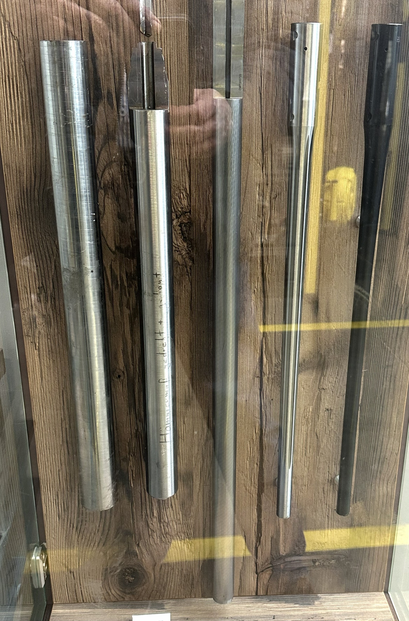

The company starts with long circular bars of steel which arrive at the plant already hardened and tempered. The solid bars are then cut, drilled, and reamed. The drilled blank is then processed in a cold-hammer forging machine. Four timed hammers forge the steel over a precision mandrel at room temperature (under 20°C). This compresses and stretches the metal to shape the rifling and the chamber simultaneously. Because this is done cold, it preserves the steel molecular structure and avoids introducing heat-induced straightness errors.

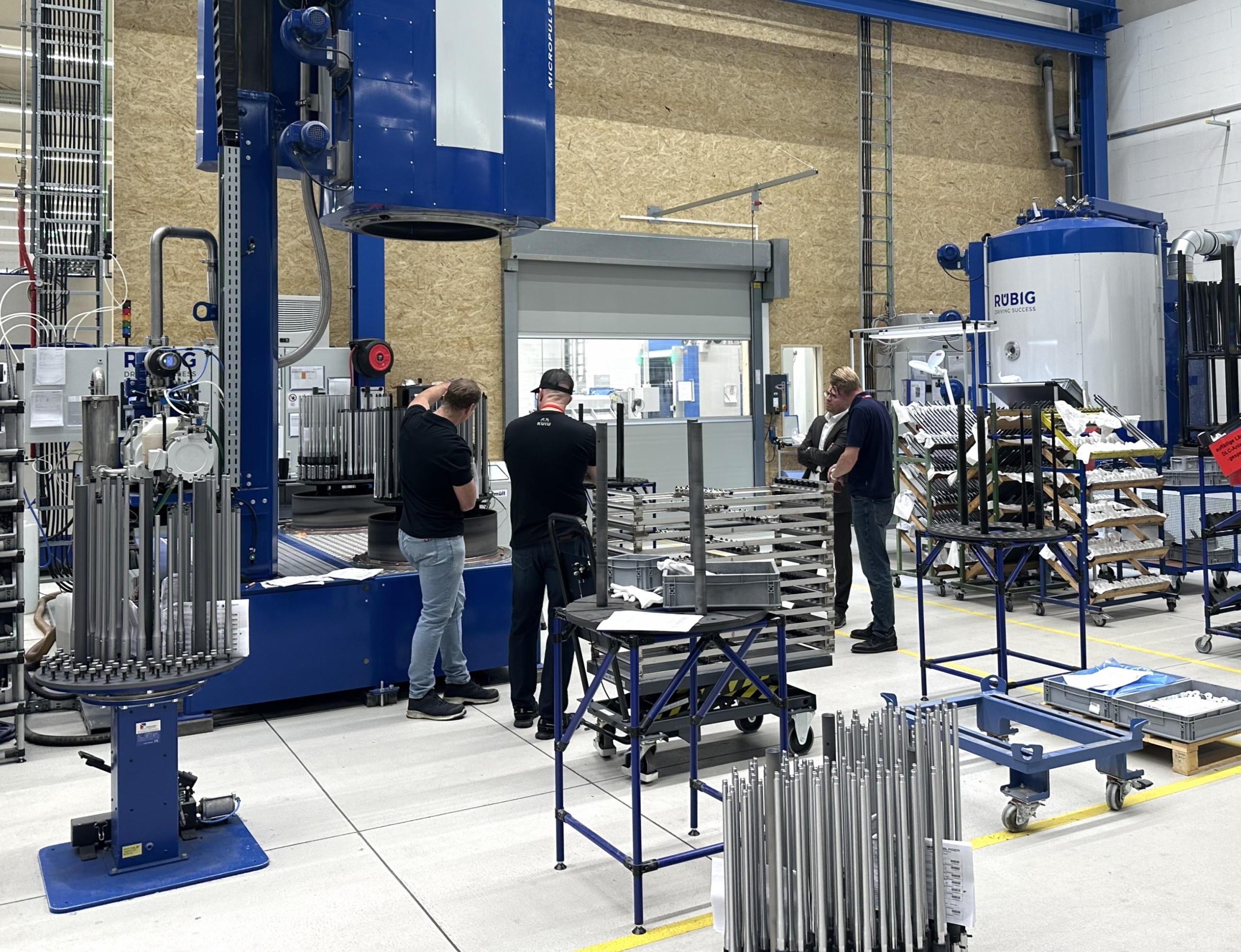

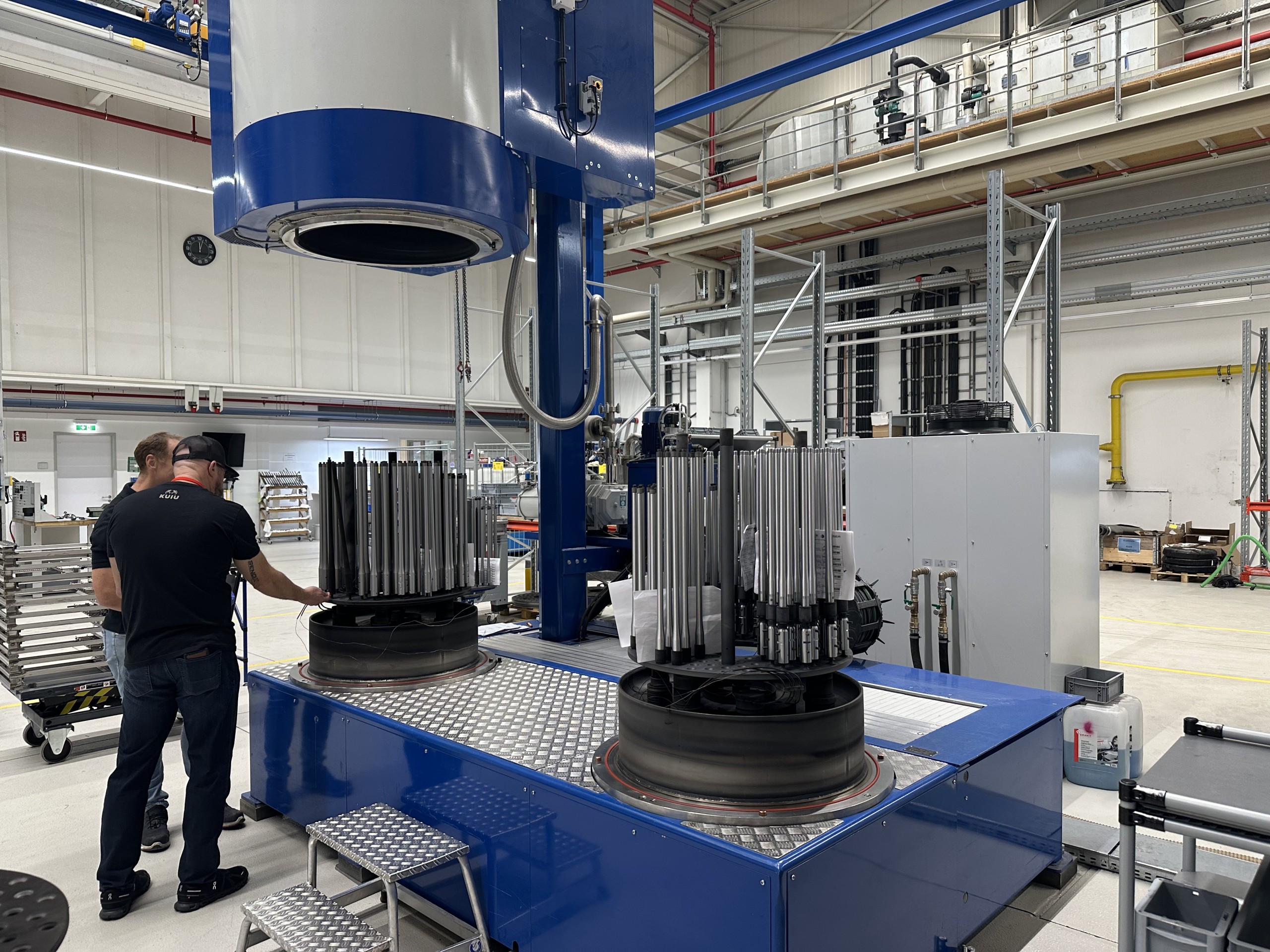

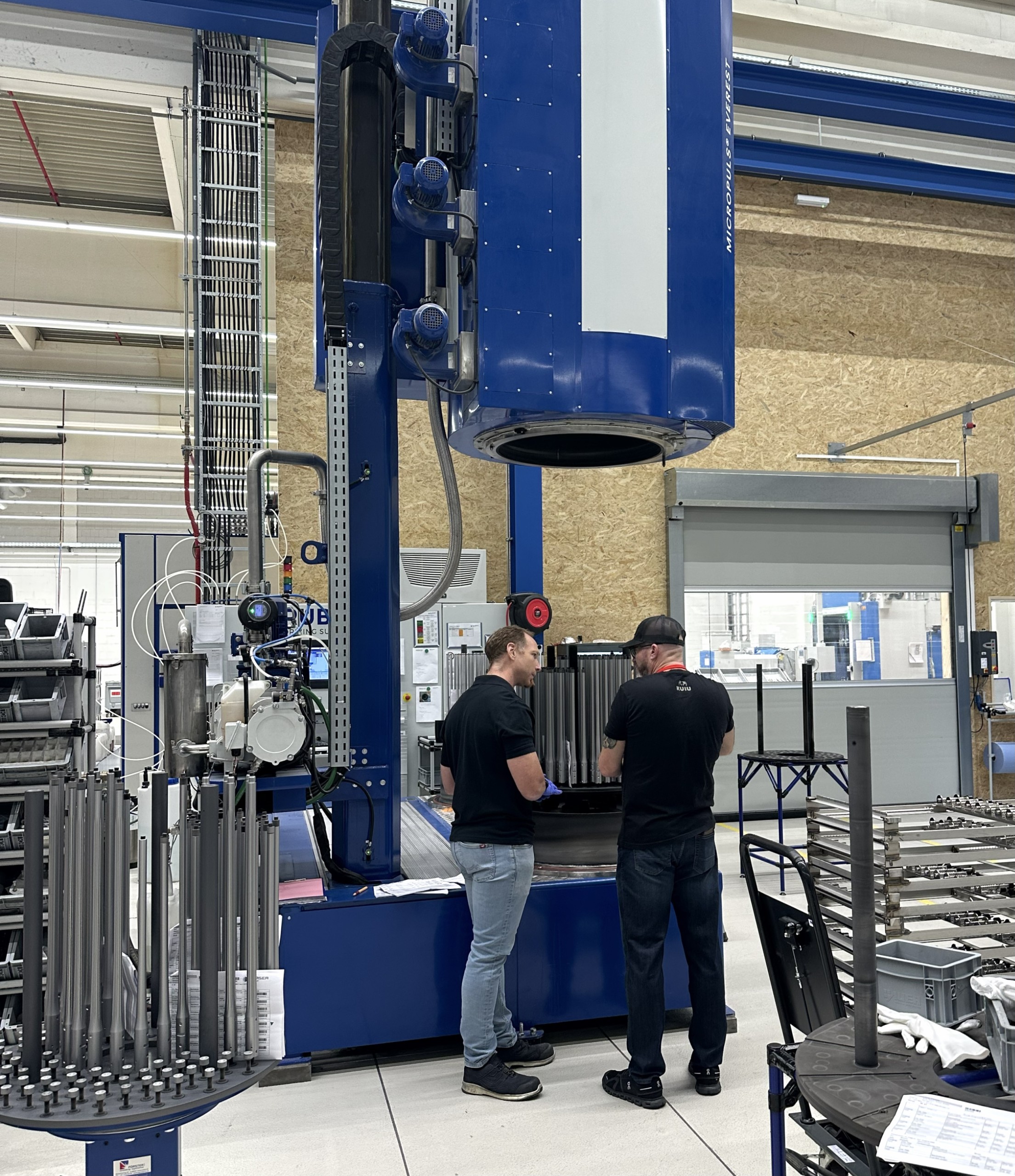

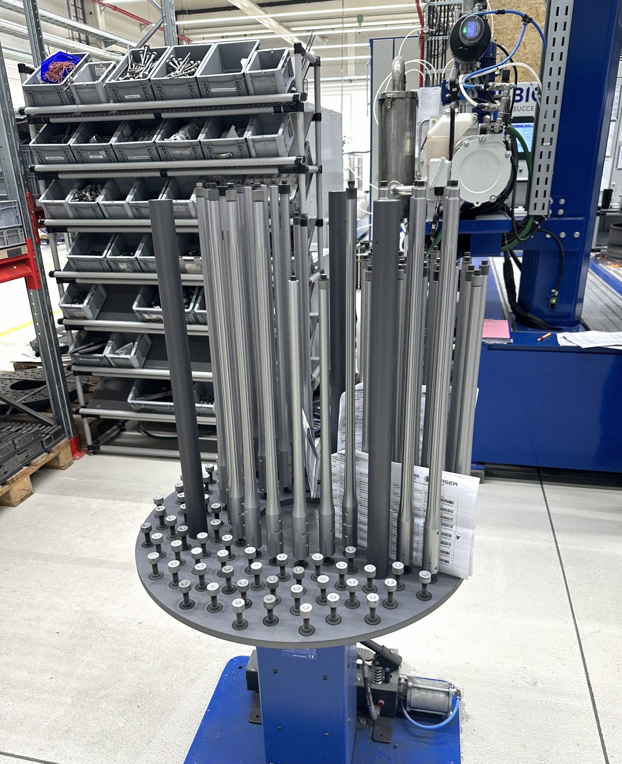

The heart of the heat-treating process is Plasma (Ion) nitriding which takes place in a dual retort plasma nitriding system provided by “Rubig” of Austria. Subsequent to this the barrels receive a DLC (Diamond-Like Carbon) finish which again takes place in a system provided by “Rubig”. The DLC system provides corrosion resistance, a highly scratch-resistant finish, as well as giving the barrels their very distinctive black color. While our knowledge of “DLC” is limited, we did learn from “Mr. George Immler”, (Heat Treat and Surface Treatment Manager) that settings for the process are entirely dependent upon the total surface area of the parts, meaning a successful result relies upon knowing the exact size and weight of the total load.
