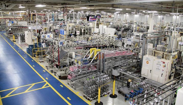

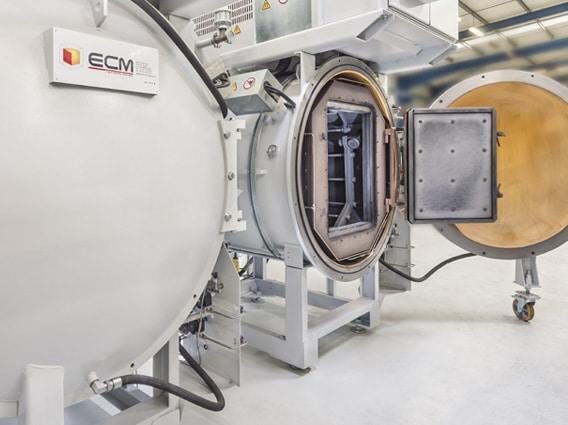

1) Ford Motor Company Sharonville, Ohio Transmission Facility,(64) ECM LPC Cells. We are quite comfortable in suggesting that the Ford Sharonville, Ohio Transmission facility is the single largest captive heat treat facility in North America. Ford was one of the first automotive companies to embrace vacuum carburizing and the end result is that this plant now has 64 ECM LPC cells with 20 bar nitrogen gas quench systems.
It is worth noting that this facility has almost 2.5 million cubic feet under roof with almost 2,000 employees; “The Ford Motor Company Sharonville Transmission plant is a transmission manufacturing facility located in Sharonville, Ohio, United States. Established in 1958, Sharonville has long been the backup site for overflowing work at the Ford Motor Company Livonia Transmission plant. It is also where the Ford Crown Victoria’s transmission was once assembled for over three decades. With the Crown Victoria now discontinued, the Sharonville transmission plant currently overseas production of the 64140 6-speed automatic transmission – also known as the Torqshift – destined for the Ford Super Duty line of heavy-duty trucks. Sharonville is where the Ford/GM 10R80 10-speed transmission is assembled. The facility also manufacturers individual gears for the 6R80, 6R140, 6F35, 6F50/55, 8F57 transmissions. These gears are then shipped to other Ford manufacturing plants like the Ford Motor Company Van Dyke Transmission plant and the Ford Motor Company Livonia Transmission plant

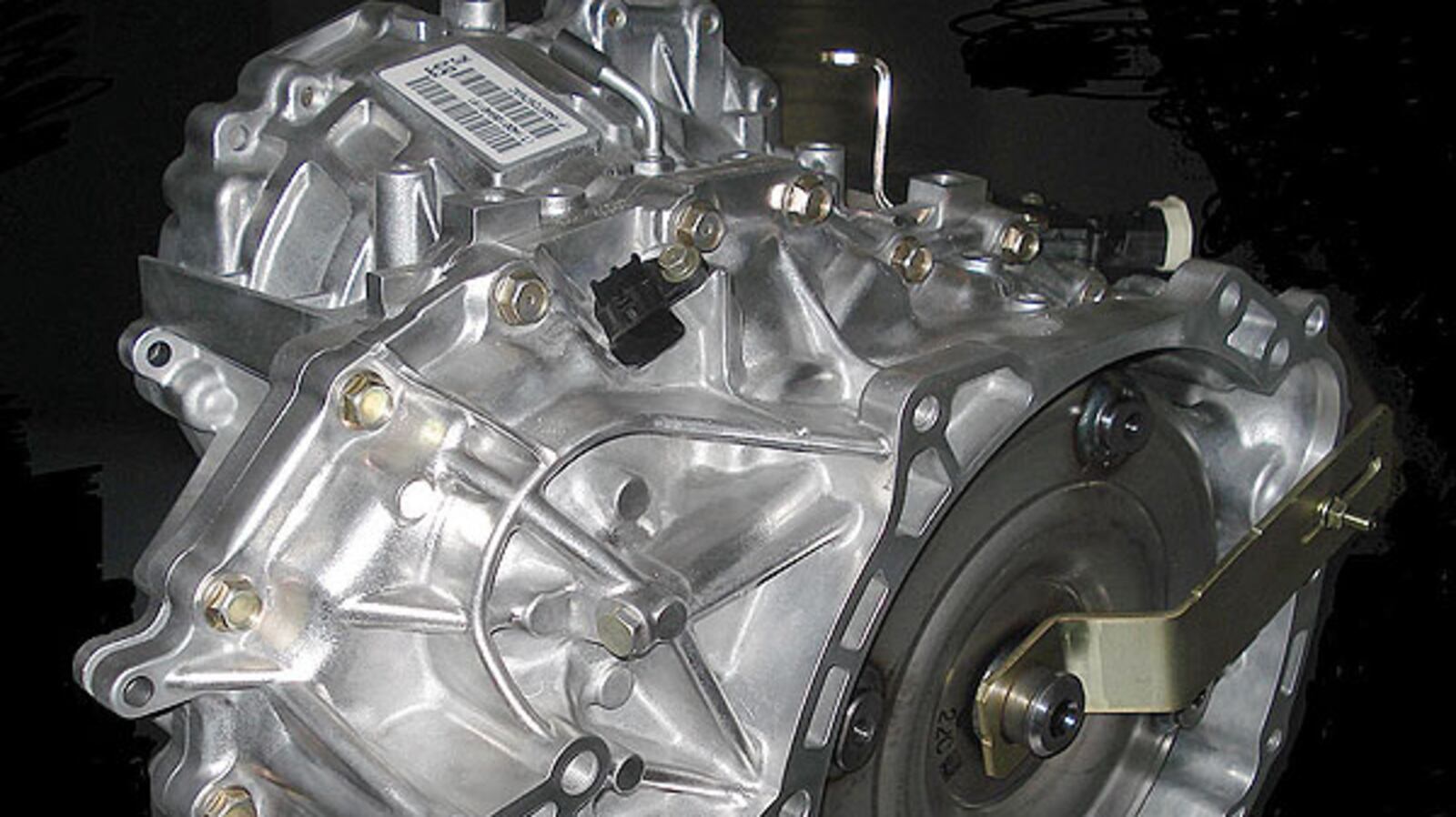

2) JATCO Aguas Caliente, Mexico,(60) ECM LPC Cells. A brand-new entry on our list is JATCO” (Japan Automatic Transmission Co., Ltd.) in Aguas Caliente in Mexico. The firm supplies continuously variable transmissions and maintains a very large vacuum carburizing (LPC) department which consists of 60 carburizing cells with hot and cold oil quenching along with gas quenching.

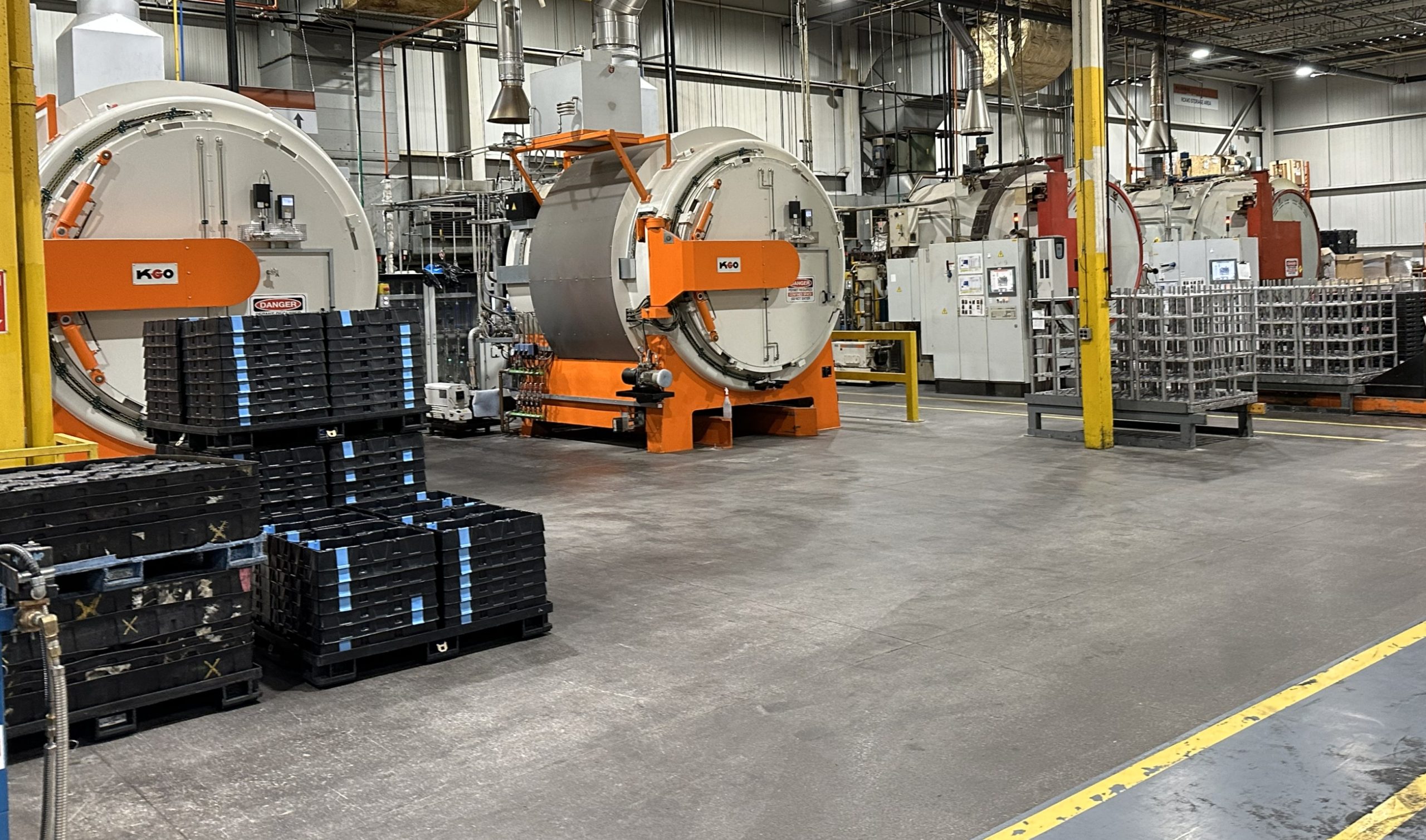

3) GKN Driveline, Newton, North Carolina, (39) ECM LPC Cells. In our third position we find another automotive parts supplier, GKN in Newton, NC. While not one of the first to invest in vacuum carburizing systems they certainly jumped on the bandwagon after vacuum carburizing proved it’s value. The company now has 39 LPC cells provided by ECM with 20 bar nitrogen quenching.

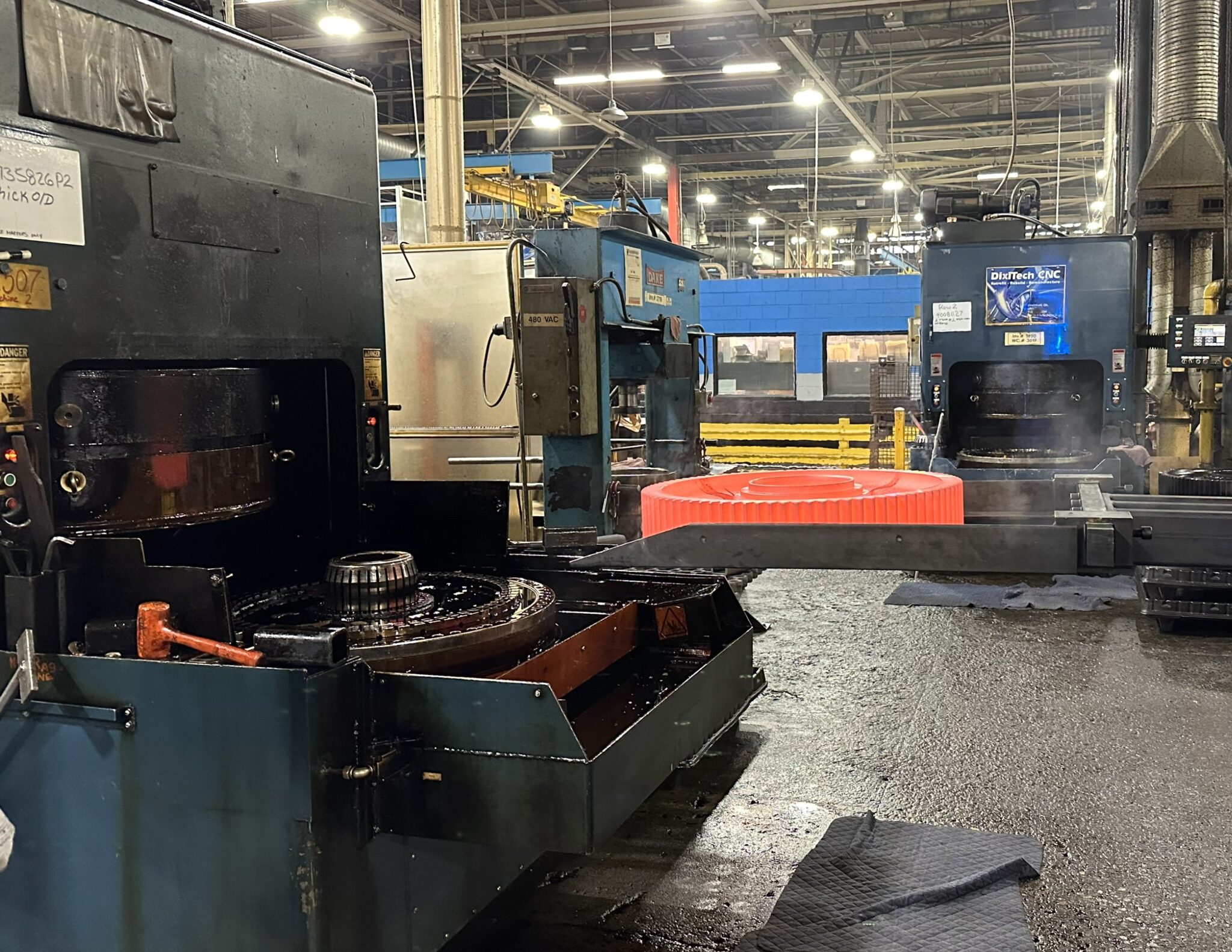

4) Allison Transmission, Speedway, Indiana, (38) Atmosphere Furnaces (various suppliers). In our fourth position we find the Allison Transmission Campus in Speedway, Indiana. This facility is the world’s largest manufacturer of fully automatic transmissions for medium- and heavy-duty commercial vehicles. Their very extensive in-house heat-treating department boasts the largest number of batch IQ furnaces in one location in North America, (25) 36”x 48” IQ Furnaces and (5) 30” x 48” IQ Furnaces. These furnaces are spread out over 4 locations on the same campus with a total of over 80,000 square feet. In total the heat treat department at Allison includes this equipment, sourced from a few different furnace builders including “Surface Combustion”.
(30) IQ Furnaces
(36) Temper Furnaces
(6) Pit Nitride Furnaces
(2) Rotary Furnaces
(12) Induction hardeners

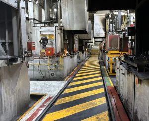

5)“Dauch Corporation”(Formerly Axle & Manufacturing Holdings), Silao, Mexico (approximately 31 atmosphere furnaces).In 2012 auto parts supplier American Axle & Manufacturing (AAM) formally opened a new plant in the city of Silao, Guanajuato, Mexico. Since that time this facility has grown to encompass roughly 10 different plants, 7 of which offer heat treatment. This posed an issue for “The Monty” in terms of ranking-does this qualify as a single location heat treat? At the end of the day, we decided that as this is one complex it will for our purposes be considered a single location. The amount of heat treating in this complex is staggering, 6 pusher furnaces (2 single row, 2 two row and 2 four row), almost 20 batch IQ units, 36″ X 48″ X 36″, several normalizing lines, two mesh belt carburizing lines and multiple tempering units, washers and endo generators. Furnace suppliers include AFC-Holcroft. For sheer throughput in terms of pounds per hour this must be one of the largest captive heat treats in North America-in terms of number of furnaces we are going to rank “Dauch Corp.”, in Silao as the fourth largest in North America.

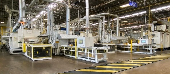

6) John Deere Waterloo, Iowa,Approximately (31)Atmosphere Furnaces. As one of the world’s largest manufacturers of agricultural machinery, heavy equipment, forestry machinery, diesel engines, drivetrains used in heavy equipment, and lawn care equipment we are sure the company needs no introduction. Their location in Waterloo, Iowa is substantial with a total of 31 furnaces which are a mixture of batch IQ’s, rotary hearth and continuous. The equipment comes from a variety of furnace suppliers including Ipsen, AFC-Holcroft & Surface Combustion. We have to add that this is a very clean, well organized facility which comes as no surprise.

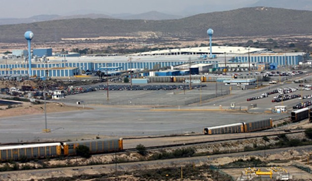

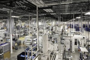

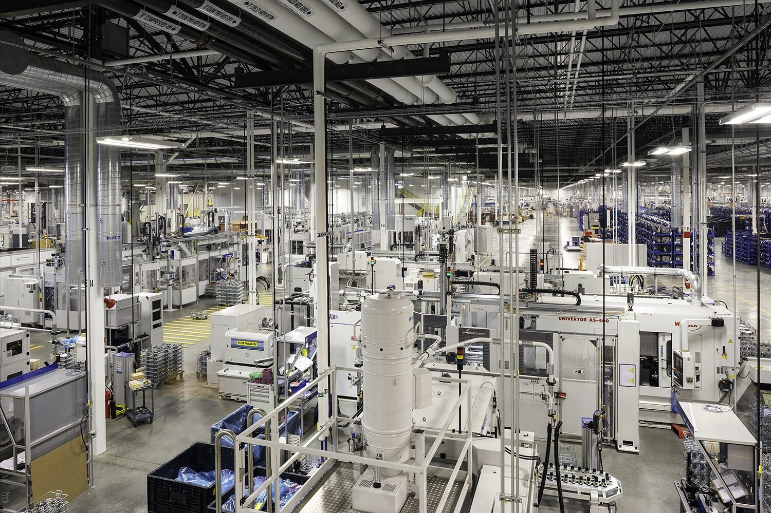

9)General MotorsRamos Arizpe, Mexico(30) ECM LPC Cells. The heat treating department of this engine and transmission components plantconsists of 2 ECM systems with gas quenching for a total of 30 cells.

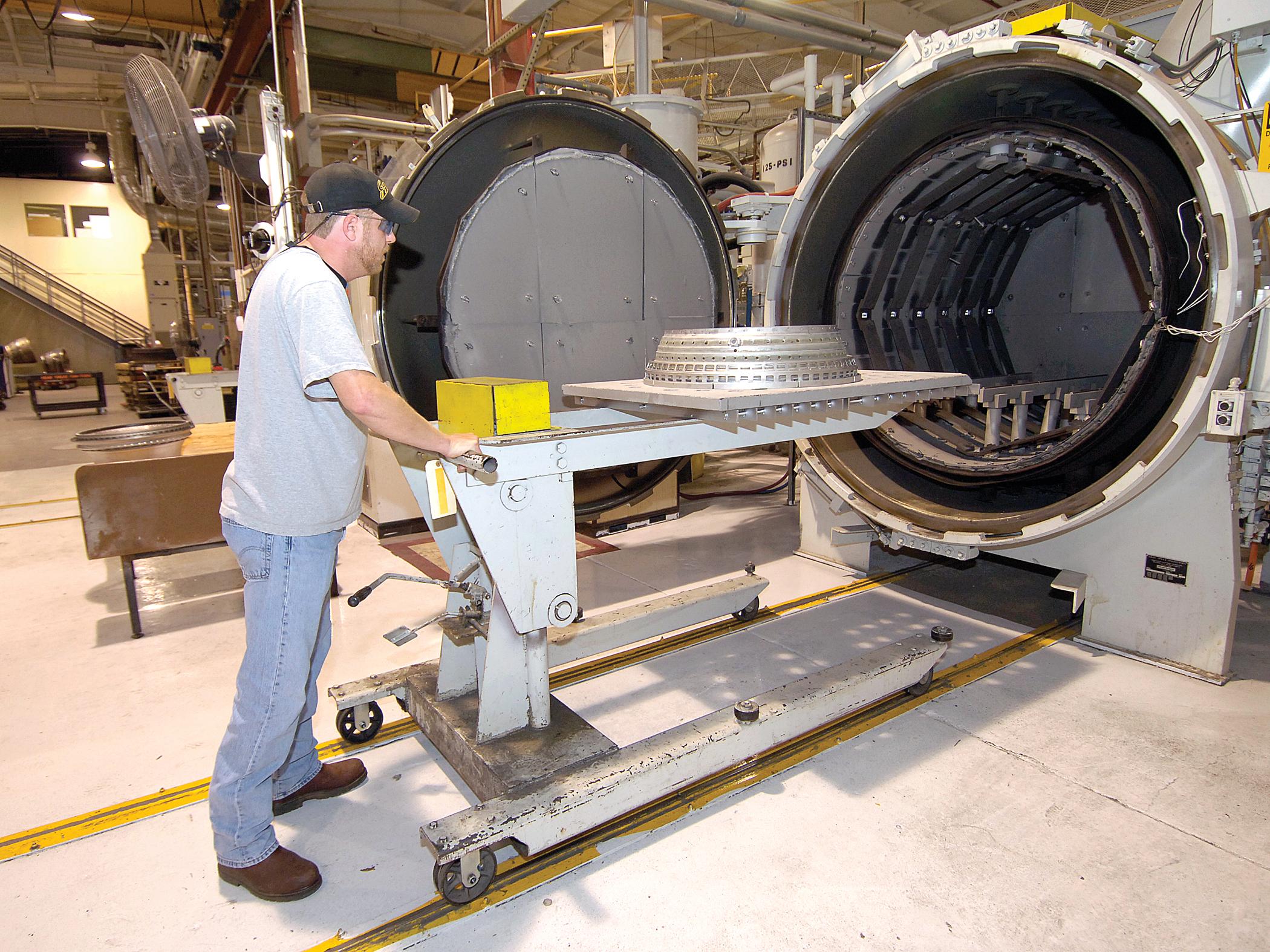

10) Tinker Air Force Base, Oklahoma.(27) vacuum furnaces. Tinker Air Force Base in Oklahoma is one of the largest US Air Force bases in the USA-to give you a perspective on the size with, 9,000 employees it is the largest single location employer in the state. This site at last count had 27 vacuum furnaces in various configurations which includes horizontal, bottom loading and oil quenching. Furnace suppliers include Ipsen.

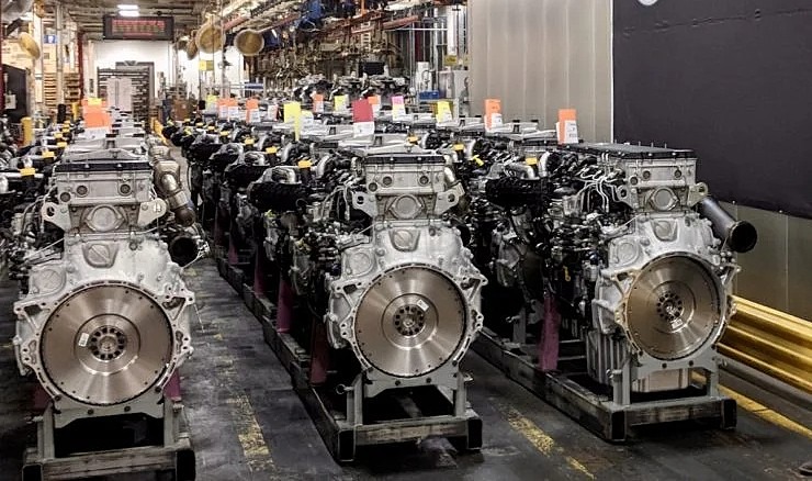

13)Detroit Diesel, Redford Michigan,(24) ECM LPC Cells. Detroit Diesel, a major American engine manufacturer, is headquartered in Redford Township, Michigan where it operates its massive 3-million-square-foot flagship manufacturing plant. The plant produces approximately 400 engines, 250 transmissions, and 1,300 axles every single day. Their heat treatment department consists of 24 ECM LPC cells with gas quenching for heat treating large truck axle rings and pinions.
