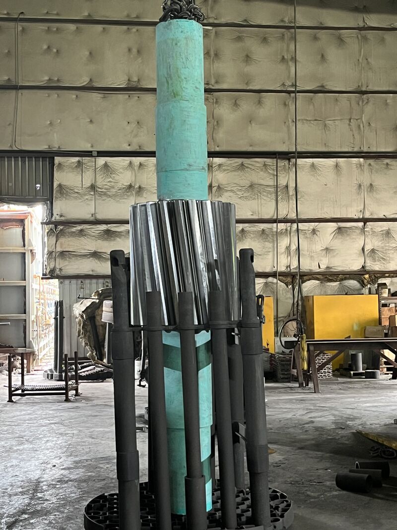

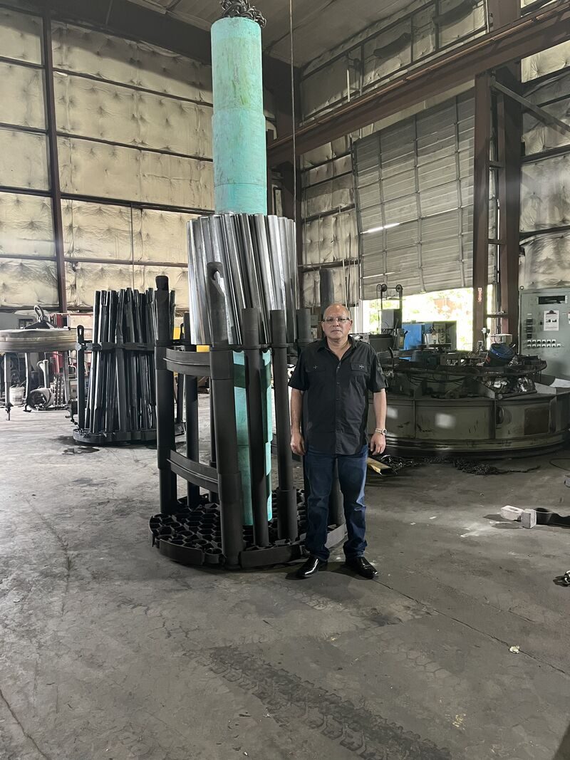

As mentioned previously our belief is that the largest commercially available pit carburizing furnaces are located at “Worldwide Heat Treat” in Houston, Texas, whose largest capacity furnaces have working dimensions of 100″ diameter X 144″ deep and capable of 60,000 pound loads.
Based upon this capacity and the sales generated “The Monty” will be adding “Worldwide” to our list of the “52 Largest North American Commercial Heat Treaters-2026” which will be published May of this year.
We leave you with these two recent photos of Worldwide showing some typical parts the company runs and the owner, “Mr. Robert Gutierrez”
