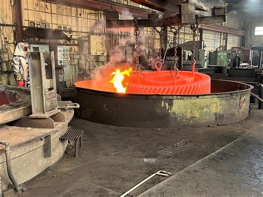

“Overton Gear” , Chicago, IL. Up to 80″ diameter X 100″ deep, 20,000 pounds

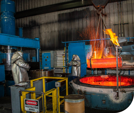

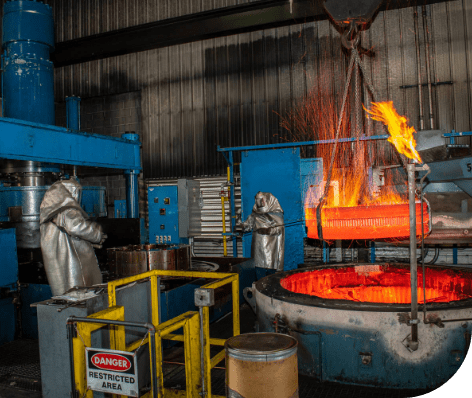

At the end of the day the customer went with commercial heat treater “Worldwide Heat Treat”, in Houston, Texas who as far as we can tell has the largest commercially available pit carburizing furnaces in North America with several pit furnaces, the largest having working dimensions of 100″ diameter X 144″ deep and capable of 60,000 pound loads.

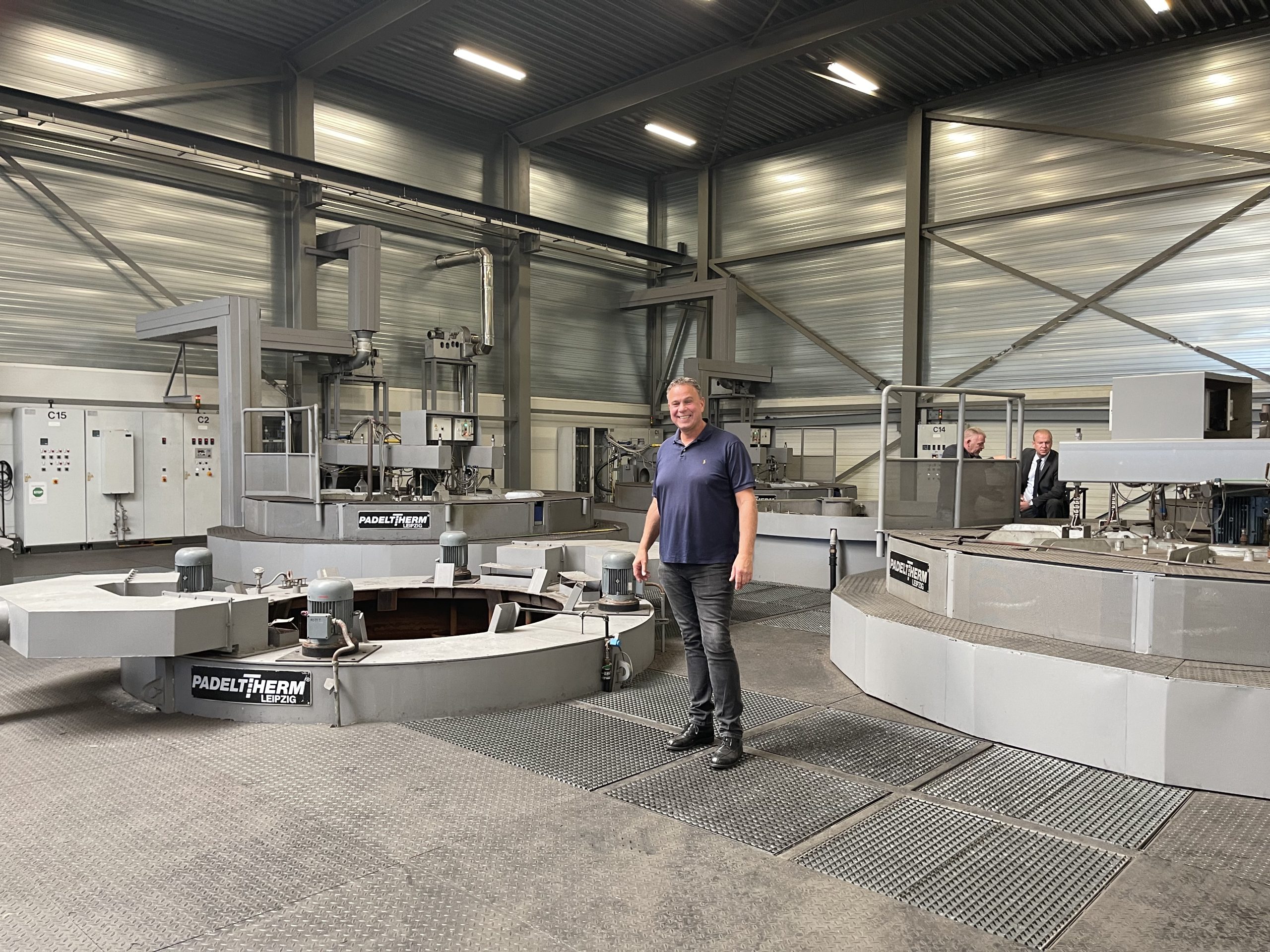

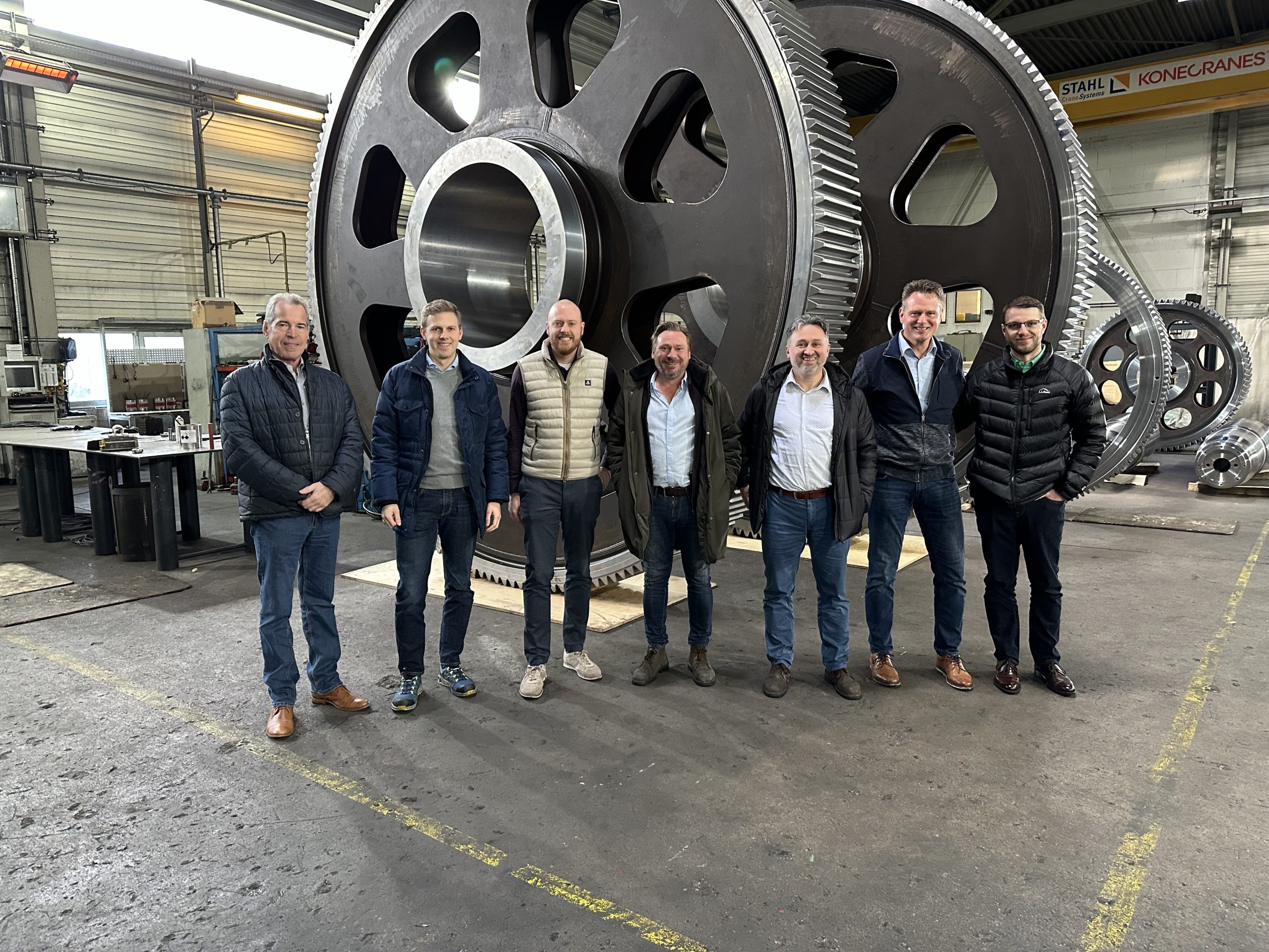

It’s interesting that there is such a difference between North America and Europe when it comes to large component carburizing capabilities. We at “The Monty” put this down to the fact that pit furnaces are far more common in Europe than North America and also the presence of so many ‘windmill” manufacturers in Europe which require enormous gears. This has encouraged commercial heat treaters to install furnaces capable of handling these components.
Two European examples include “Carburizing of Large Gears-“Haerterei Reese” in Germany and “Dominial Heat Treatment-The Interview” in the Netherlands-both of whom can handle parts anywhere up to 100,000 pounds.
