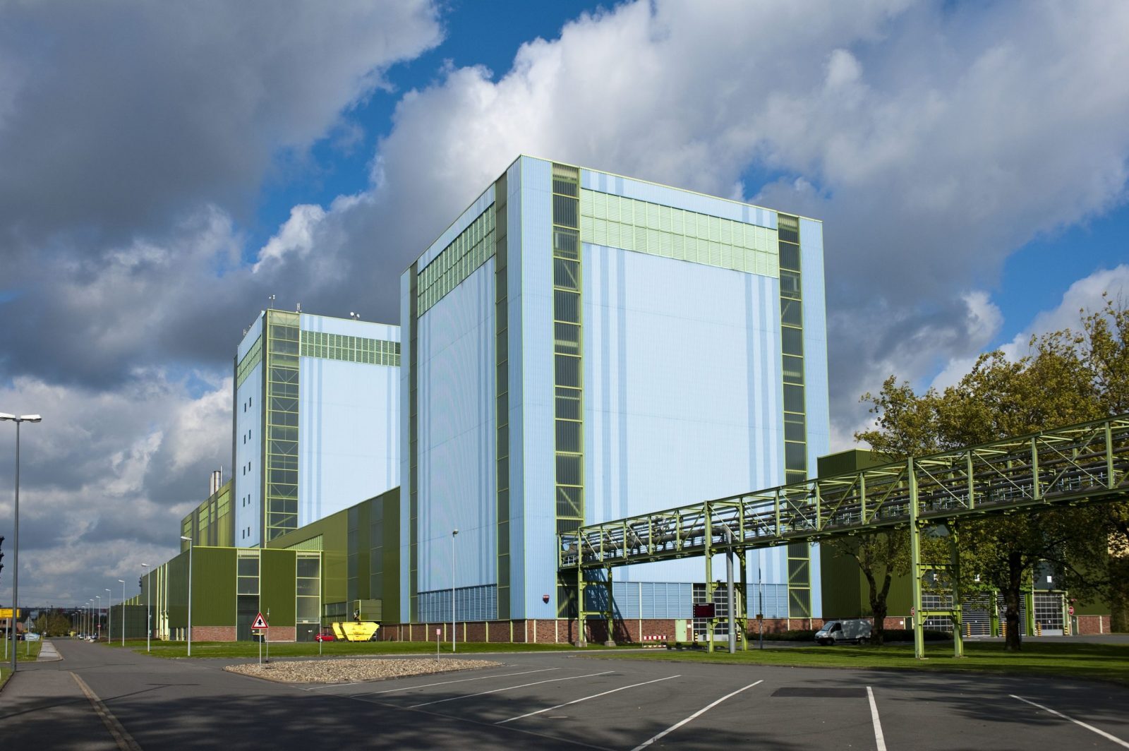

thyssenkrupp Steel Europe awards WS Wärmeprozesstechnik GmbH order to retrofit FBA 8 combustion system
Within the scope of a modernization project, thyssenkrupp Steel Europe AG will upgrade the combustion system of the FBA 8 galvanizing line, which is located at the Dortmund plant. The newly implemented heating system will provide drastically lower emissions.
The purchase order for delivery, assembly and commissioning of 195 modernized self-recuperative burners has recently been placed with WS Wärmeprozesstechnik GmbH. The heating system will achieve exceptionally low NOx emissions due to proven double P-tube design and the patented FLOX® combustion process. The retrofit is to be completed by mid 2022. Detailed planning will keep line down time to a minimum for the duration of the retrofit.
In the future, the tkSE plant in Dortmund will operate three vertical strip lines, positioning it as one of the most advanced and modern sites for annealing and surface treating of steel strip globally. Up to 2.000.00 tons of steel can be processed annually, once all three lines are in full operation. tkSE employs and fully relies on proven and environmentally friendly heating technology. A technology that even today is suitable for a future with green combustion gases. After the conversion, approximately 800 low emissions burners will be in operation at the Dortmund facility.
