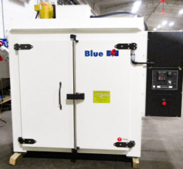

“Blue M®, a global industrial and laboratory ovens manufacturer, announced the shipment of a Class A safety oven to the medical industry.
Designed for ease of move-in and installation, this Blue M Class A oven was modified to an overall height of 79” and width of 45” to accommodate the ceiling height and doorway dimensions at the customer’s facility.
The safety oven has a temperature range of 15°C above ambient to 316°C. The temperature is controlled by a Watlow EZ Zone PM controller with advanced PID control algorithm. The controller offers TRU-TUNE™ adaptive control for tighter control and auto-tune for a quick, efficient start up.
The interior chamber has dimensions of a 48″ W x 24″ D x 48″ and is constructed with 304 stainless steel. All of the seams and ports of the interior chamber are Heli-Arc welded vapor tight to prevent fume infiltration and buildup of flammable materials between the chamber walls. The unit includes five (5) 304 stainless steel slotted shelves with rolled fronts for ease of product loading. Each shelf is capable of holding a 75lb product load.
 “Blue M offers customers the flexibility to request engineered-to-order modifications to our standard oven designs. This Class A oven features custom exterior dimensions to accommodate the customer’s facility ceiling height and doorways. This is the second unit with these special dimensions that this customer has ordered.”– Jonathan Young, Blue M Product Manager”
