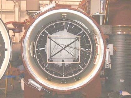

The temperature control that is desired.  (in reality) is at the component itself/load. When conducting a temperature uniformity survey, the minimum requirement to establish the degree of temperature variance with the process chamber is 9 (nine).
Fig 3 Nine-point thermocouple temperature uniformity survey being prepared.
Once you have defined the area (within the process chamber), label the front door of the furnace with the dimension’s and location of the accurate temperature uniform zone within the process chamber. All work but then be processed within that defined envelop.

Fig 4 Vacuum furnace temperature uniformity survey.
