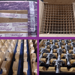

COST SAVINGS TIP #5: Packaging
Unless specified, it is assumed that parts will be returned in the same packaging they are received. Using reusable dunnage can be a great cost saver as there are fewer boxes to dispose of and fewer damaged parts. Pre-racking can also be a significant cost savings.
