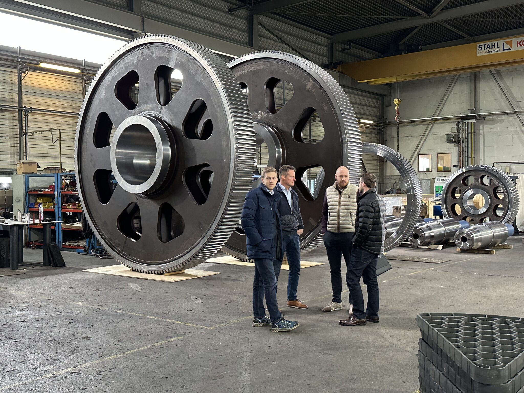

As an update to this article we now have approval to post these photos of what are fairly typical parts for Haerterei-typical for them perhaps but not for 99% of captive and commercial heat treaters around the world.

These photos don’t really do justice to the size of the pit carburizing facility but they at least give you an idea about how very large gears are heat treated.”
