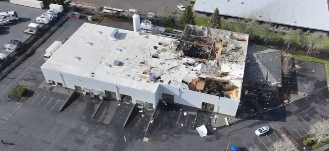

February 4/2026 “The Monty Heat Treat News” had a news item entitled “Massive “HIP” Explosion at USA Commercial Heat Treater”, we followed this story up with another related article entitled “Are Hot Isostatic Pressing (HIP) Accidents Common?”.
We now have updates on both stories, the first update looks at the explosion from the standpoint of a local family and includes photos of the building which housed the furnace after the explosion; “Canby Family Displaced After Industrial Explosion Damages Home”.
