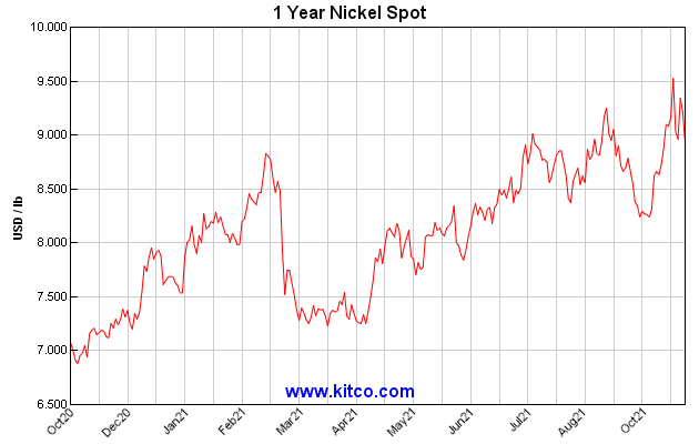

Nickel Pricing; We start off with a commodity which has historically always effected the bottom line of heat treaters and furnace builders-nickel. All high temperature alloy components used in furnaces have some % of nickel, this  can be as high as 72% in some types of Inconel material (alloy supplier Cronite offers a chart showing the composition of various materials used in heat treating heat_treatment.pdf (cronite-group.com). Currently spot nickel prices stand at slightly over $9.00 USD/pound which by historical levels is not tremendously high, however as can be seen in the chart below this represents a price increase of over 30% in the past year (interestingly enough nickel pricing peaked back in 2007 at levels almost twice what they currently are. Pricing came back to earth during the 2009 recession).
So while pricing has always been rather volatile it has been steadily climbing during the Pandemic and with warehouse stock inventories steadily decreasing over the past year there is no reason to think pricing will go anywhere but up.
