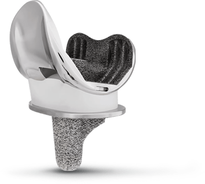

(AI Overview; Vacuum heat treating is a critical process for orthopedic implants—such as hip, knee, and spine replacements—to ensure they meet the rigorous mechanical and biocompatibility standards required for long-term human use. By 2026, this technology has become standard for processing advanced materials like titanium, cobalt-chromium, and 3D-printed alloys.
Core Benefits for Orthopedic Implants
  • Oxidation Prevention: The vacuum environment removes oxygen and reactive gases, preventing the formation of brittle oxide layers or discoloration on the implant surface.
  • Material Purity: It maintains the inherent biocompatibility of the metal, ensuring the implant does not leach harmful substances or trigger immune responses once inside the body.
  • Enhanced Mechanical Properties: Precise heating and cooling cycles optimize the implant’s hardness, fatigue strength, and wear resistance, which is essential for load-bearing joints.
