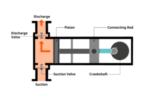

Working Principle of Piston pumps:
Piston vacuum pumps also operate on the principle of positive displacement. Though originally developed for pumping liquids in agricultural and domestic settings, they have been adapted for vacuum generation in a range of industrial processes.
The pump is driven by an electric motor connected to a crankshaft and connecting rod assembly, which converts rotary motion into the reciprocating movement of a piston within a cylinder. The pumping cycle consists of the following phases:
  1. Suction Phase
  • Vacuum generation begins as the piston moves downward (away from the cylinder head), the volume inside the cylinder increases.
  • This creates a pressure drop, and now pressure inside the cylinder is lower than that of the vacuum furnace, drawing in gas through the inlet (suction) valve, which opens as the chamber pressure falls.
  1. Compression Phase
  • When the piston moves upward (toward the cylinder head), the chamber volume decreases, compressing the gas, raising its pressure.
  • The Suction valve closes to prevent backflow of gas.
  1. Discharge Phase
  • Once the gas pressure exceeds atmospheric pressure, the outlet (exhaust) valve opens to release the compressed gas.
  • The piston completes its stroke, and the cycle repeats.
By such reciprocal back & forth movement of the piston, gas is evacuated from the furnace, generating vacuum.

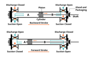

A common variation is the double-acting piston pump, where the cylinder is divided into two chambers on either side of the piston, each with its own suction and discharge valves. As the piston moves in one direction, one chamber draws in gas while the other simultaneously compresses and expels it. When the piston reverses, the roles of the chambers switch.
