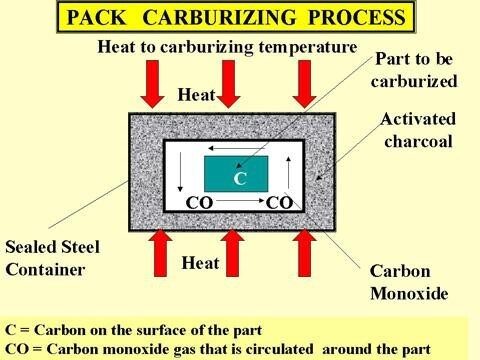

Pack carburising is a method of creating the conditions with the steel being treated so that carbon defuse into the surface of the steel. Once the carbon has defused into the surface of the steel, the whole process is allowed to cool down to room temperature and the steel remove from the container in which it was originally placed for the carburising procedure.
The following illustration shows the cross-section of a simple steel box type constructed process furnace, which provided the heat source for the carburising procedure. Within the interior of the furnace is placed a steel container which carries both the carburising medium and the steel which is to be carburised. The steel container is sealed with a lid which is further sealed using either fireclay or mud.
The very simple carbon rich source that is used for the Pack carburising procedure is that of simple charcoal.
A simple carburizing box made from Heat Resisting Stainless Steel. Typical Pack Carburizing Mediums. Wood charcoal (will produce a carbon rich atmosphere, but with no knowledge of the carbon output)

In this presentation, we are focusing our attention on the pack carburising method. The pack carburising method relies on the use of a carbon rich material. One can also make use ordinary charcoal,(such as barbecue charcoal). However the carbon output from the charcoal is never consistent. Companies did at one time manufacture their own brands of carburising granulate which consisted of charcoal, and an activator known as Barium Carbonate.
The process method produces the release of carbon monoxide (CO) which is derived from a solid carbon source. This activity is initiated at the surface of the steel to be carburized. The resulting decomposition is nascent carbon and carbon dioxide. The action is to release the carbon monoxide which is caused by thermal activity (temperature/heat) on the carbon rich source material.
The activity is assisted by an Energizer such as (previously stated) Barium Carbonate (BaCO3) or potassium carbonate (K2CO3), or sodium carbonate (NAaCO3). The energisers (whichever one is utilised) are present to aid the initial production of CO2 from the carbon rich source material resulting in the formation of carbon monoxide (CO) which is the active gas at the surface of the steel being carburized.
