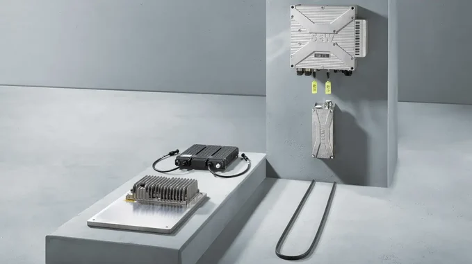

This system also incorporates our own MOVITRANS® wireless power transfer technology, a robust, contactless energy transmission solution we’ve relied on in-house for over 20 years. MOVITRANS delivers power magnetically through an air gap, enabling seamless energy transfer to mobile systems like automated guided vehicles (AGVs) and transfer carts without physical connectors
In this application, MOVITRANS, paired with infrared communication, allows the external loader to operate completely cable-free. This eliminates wear-prone components such as cable tracks, significantly reduces maintenance, and improves overall system reliability. It’s a perfect example of how we apply SEW-EURODRIVE innovations not only for our customers, but also to enhance our own manufacturing performance and efficiency.
