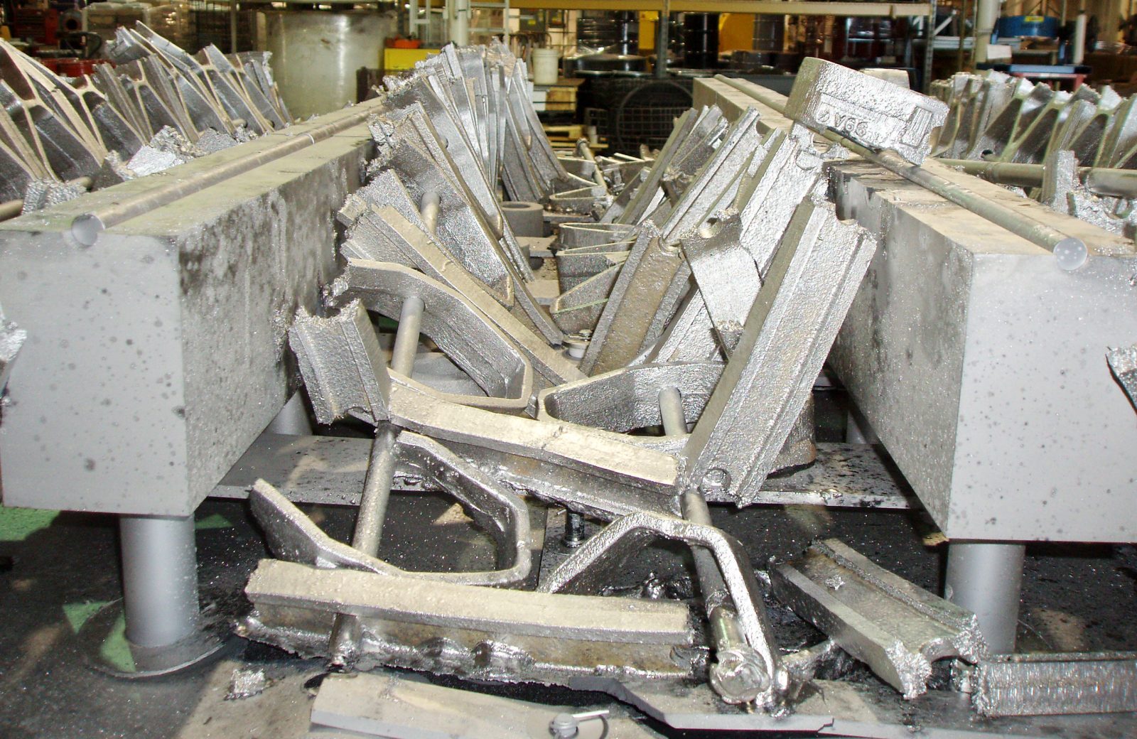

We learned a good lesson on eutectic melting a couple years ago when a clean-up run was performed in one of our furnaces at 2400°F without prior removal of a work grid. The high nickel alloy cast fabricated grid was sitting on molybdenum support rods positioned on the furnace graphite support rails.
Figure 1: Eutectic meltdown between the high nickel alloy cast fabrication grid and the molybdenum load rods. This was an expensive mistake, in excess of $150,000.

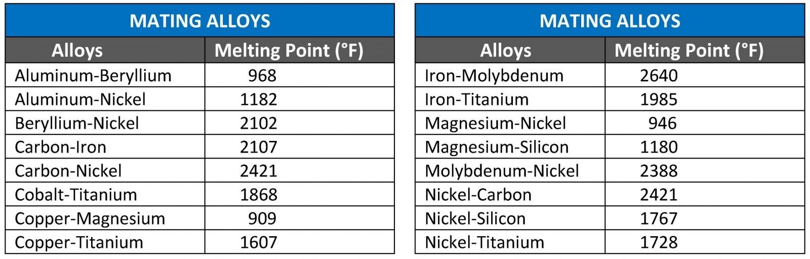

Table 1 shows some alloy mating combinations and the eutectic melting points.

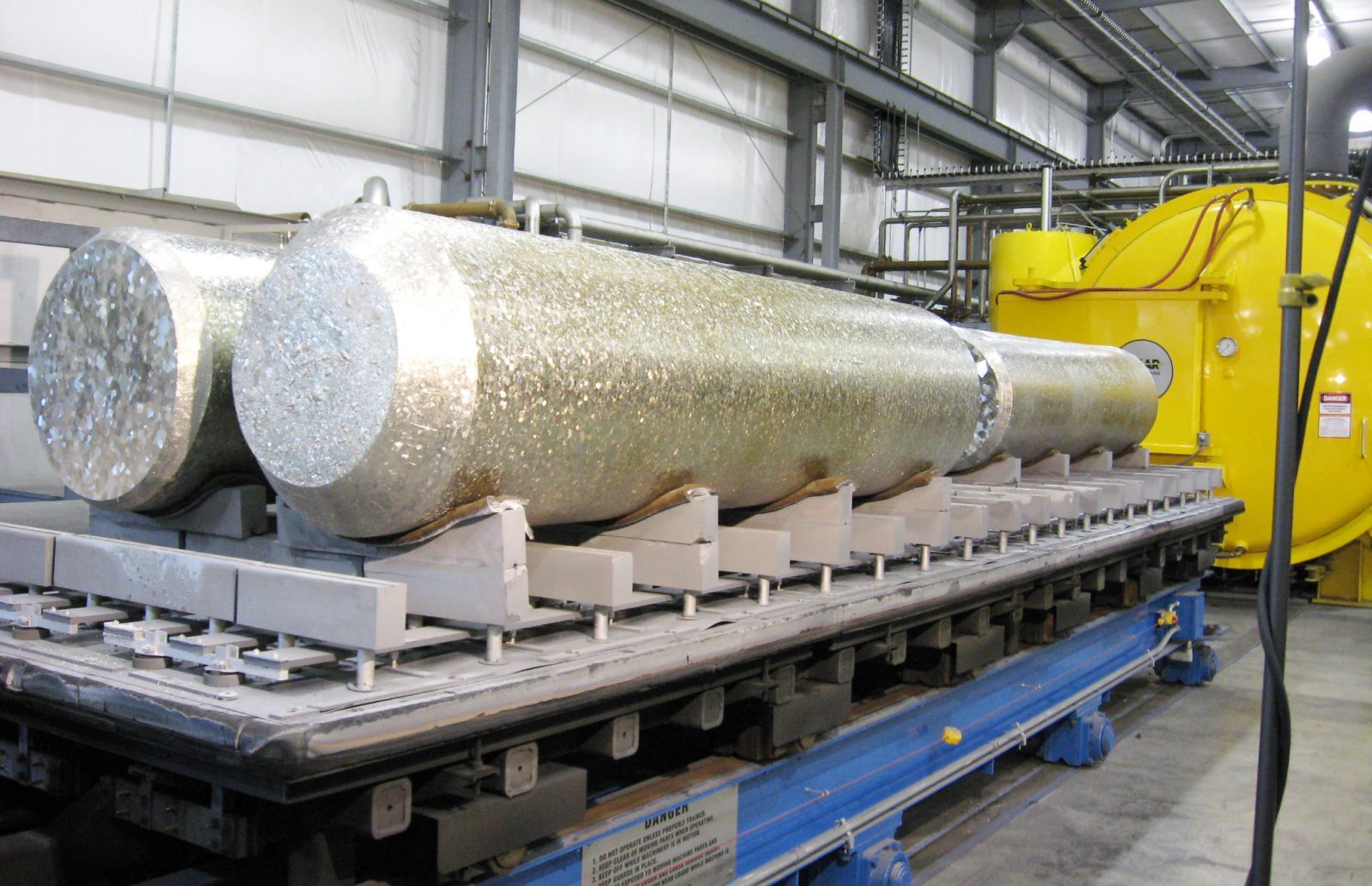

A eutectic barrier is the insertion of a material between the two mating metal surfaces that might be heading for a eutectic melt at elevated temperatures. This barrier material must be capable of withstanding the process’ maximum temperature to be effective.
The most effective barriers are:
  • Refrasil cloth or Kaowool blanket
  • Thin Ceramic plates
  • Ceramic fixtures of different shapes
  • Stop–off paints of different types
Refrasil is a clothlike material consisting of more than 96% silica (SiO2) that resists oxidation and most reactive melting. Most Refrasil textiles will not melt or vaporize until temperatures exceed 2650°F.
Kaowool is a good insulation and barrier when used in a blanket form.
Ceramic, high purity alumna can take the form of flat plates or individually designed fixtures to fit a particular application.

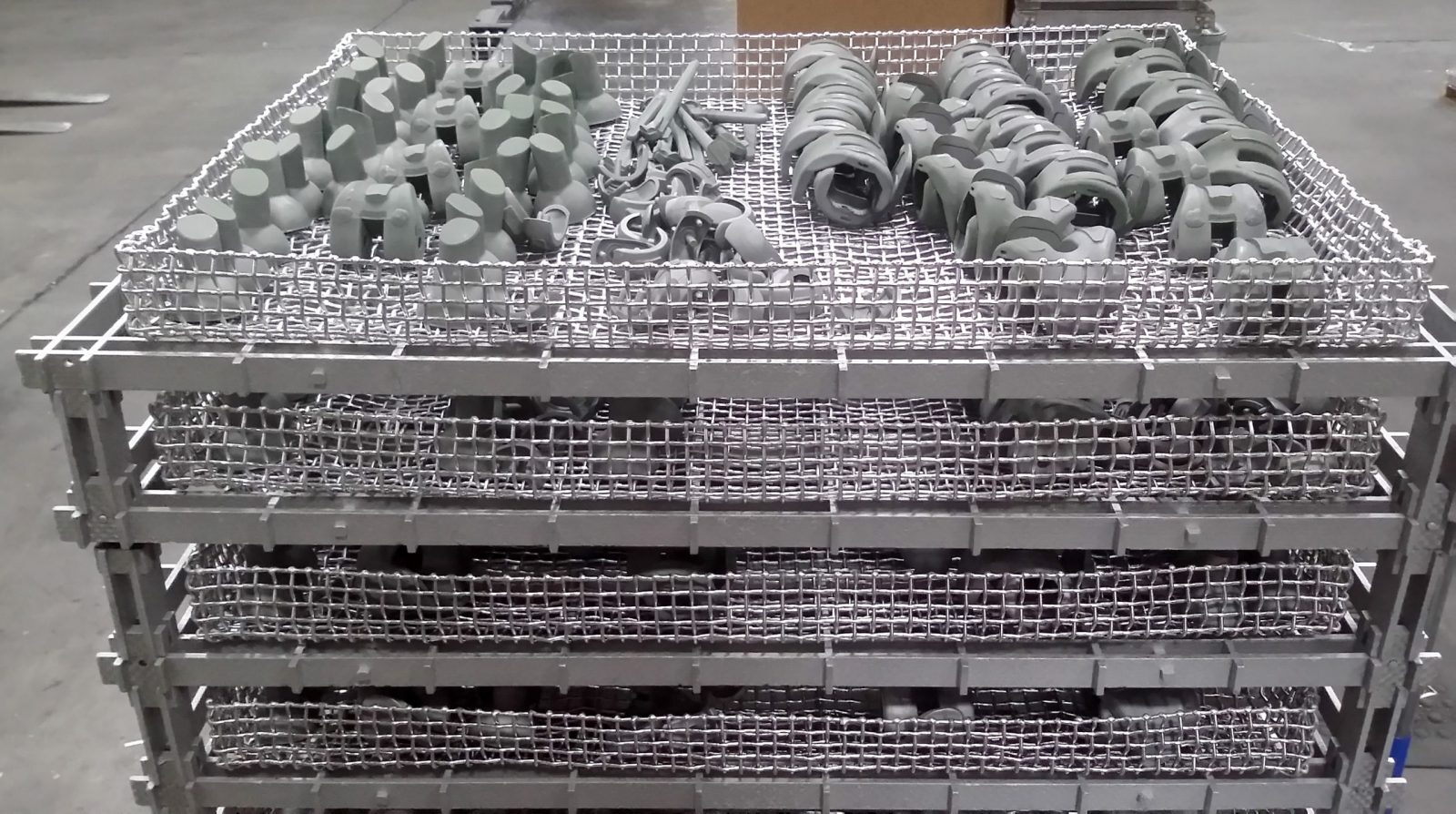

Stop-offs are designed to protect metal surfaces from the flow of molten brazing filler metal, or to prevent metal surfaces from adhering or sticking to each other.

1. Kaowool Barrier: Typical load of Titanium logs on Kaowool with graphite fixturing. Processing temperature is 2350°F for 24 hours in high vacuum.

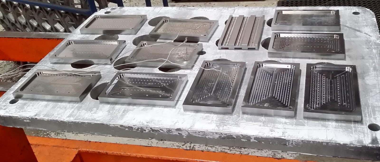

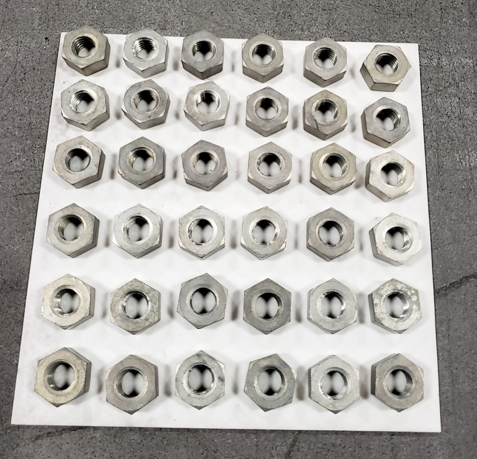

3. Ceramic Plate: Demonstrates the use of a thin ceramic plate to separate the fastening nuts from the graphite support plate. This process is for a sintering procedure to 2500°F.
4. Ceramic Plate: Typical load of nickel iron alloy, MuMetal, fixtured on Alumina sheet with graphite support. Processing temperature is 2150°F.

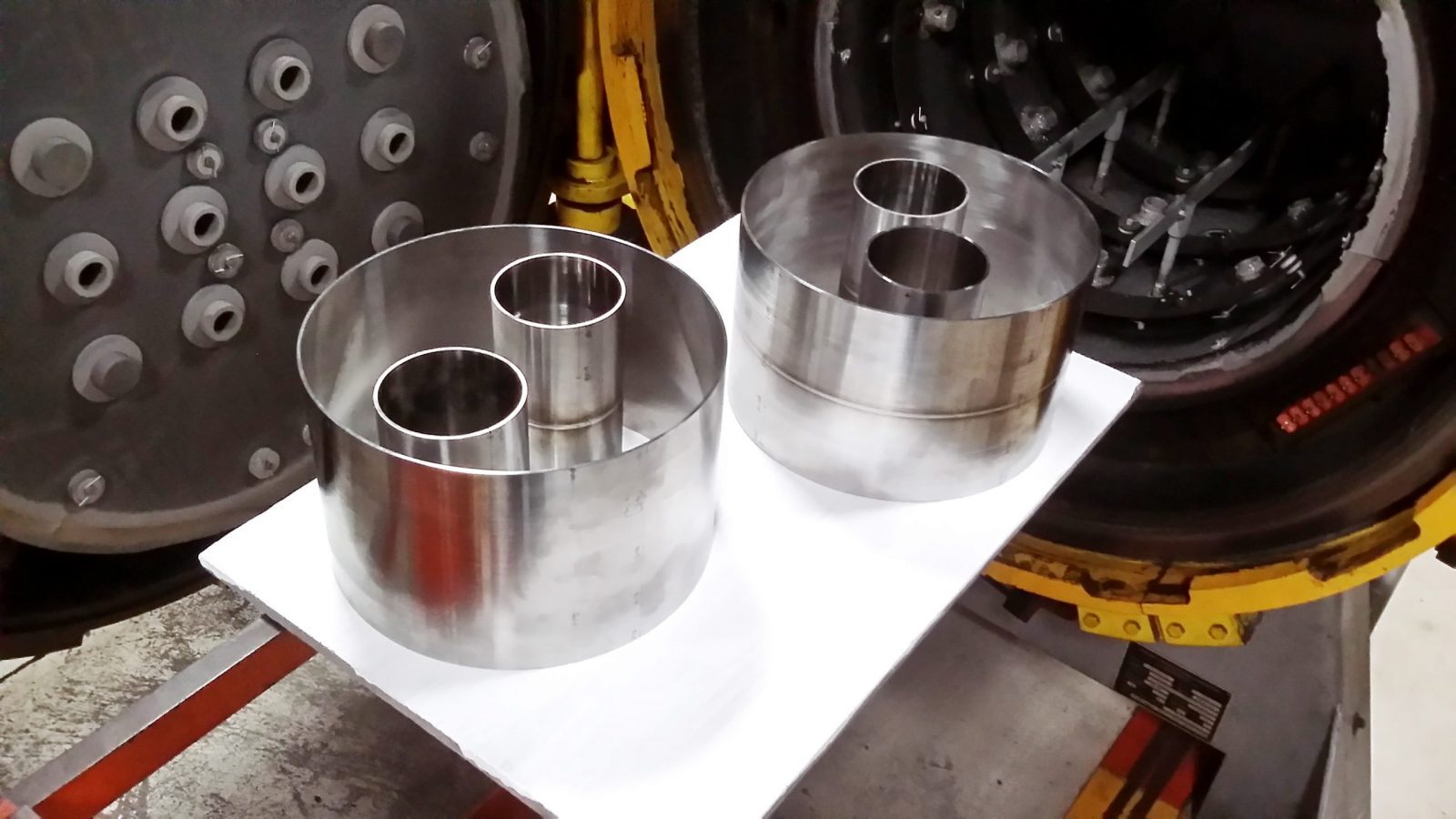

6. Stop-Off Barrier: Typical load of 420 stainless steel molds processed on graphite plate utilizing Wall Colmonoy Inc. white stop–off. Processing temperature is 1900°F.

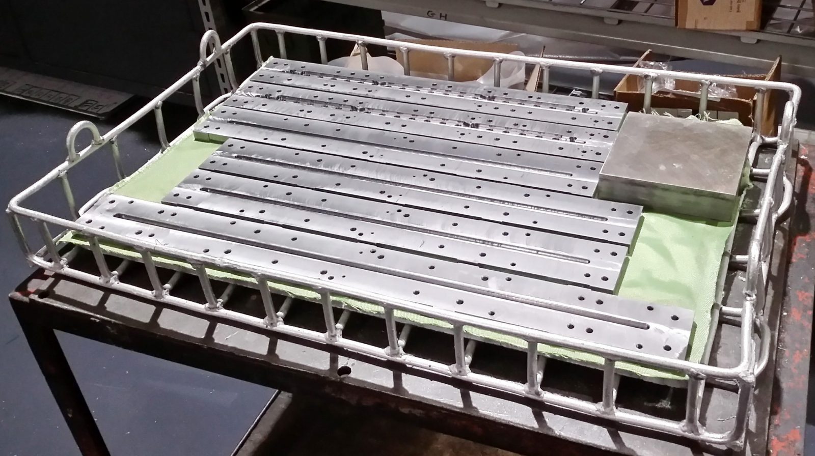

7. Green Stop–Offs: Typical load of orthopedic implants fixtured with alloy 330 screens utilizing Wall Colmonoy stop–off fixtured in CFC grids. Processing temperature is 2175°F.
