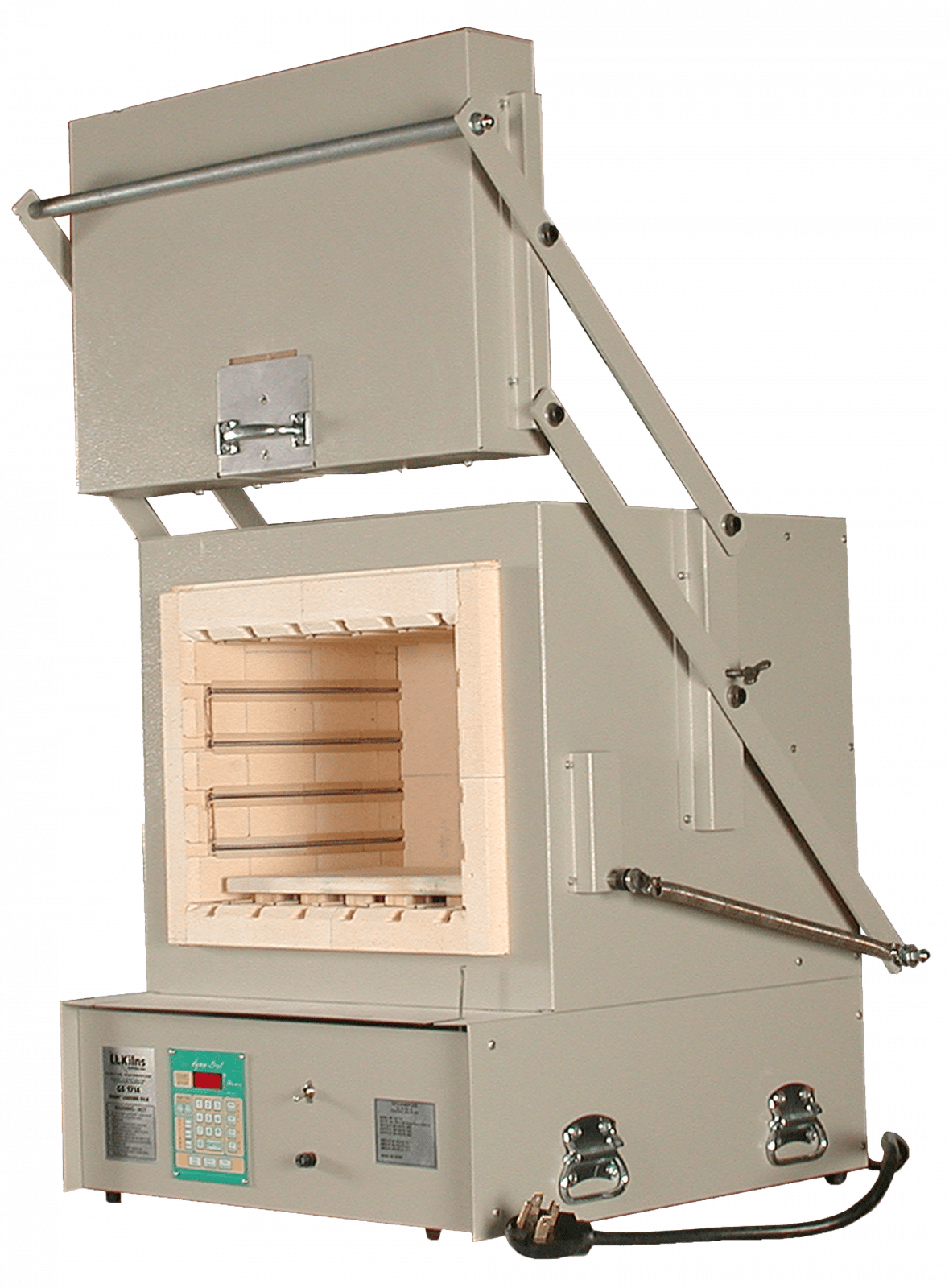

The Model GS1714 has internal dimensions of 17” wide by 12” high by 14-1/2” deep. It has an operating voltage of 208, 220, 240 volts single phase, 60 or 50 hertz. Included is a spring-assist vertical lift door that allows for effortless loading and unloading, even at high temperatures.  The furnace is equipped with a Bartlett program control and overtemp with an option for a Eurotherm 1/16 DIN microprocessor-based program control with solid-state relays. This allows for adjustable PID logic and finer temperature control around setpoint.
The furnace is constructed from 3” lightweight IFB firebrick, backed up with 2” of board insulation. The elements are supported in hard ceramic element holders. This allows for long element life and they are easily replaced. The elements are located on both sides as well as the top and bottom. This allows for equal heat distribution from all sides, and with the industrial control option, has proven to achieve a uniformity gradient of ±7.5°F.
Standard units include a sheathed thermocouple, a slot in the door for access into the furnace, a bench-mounted, powder-coated CNC machined case, ceramic hearth plate with standoffs, a door limit switch that turns the power to the elements off if the door is opened, an on/off toggle switch with control fusing, and a power plug. An optional angle iron stand and vent kit are available.
