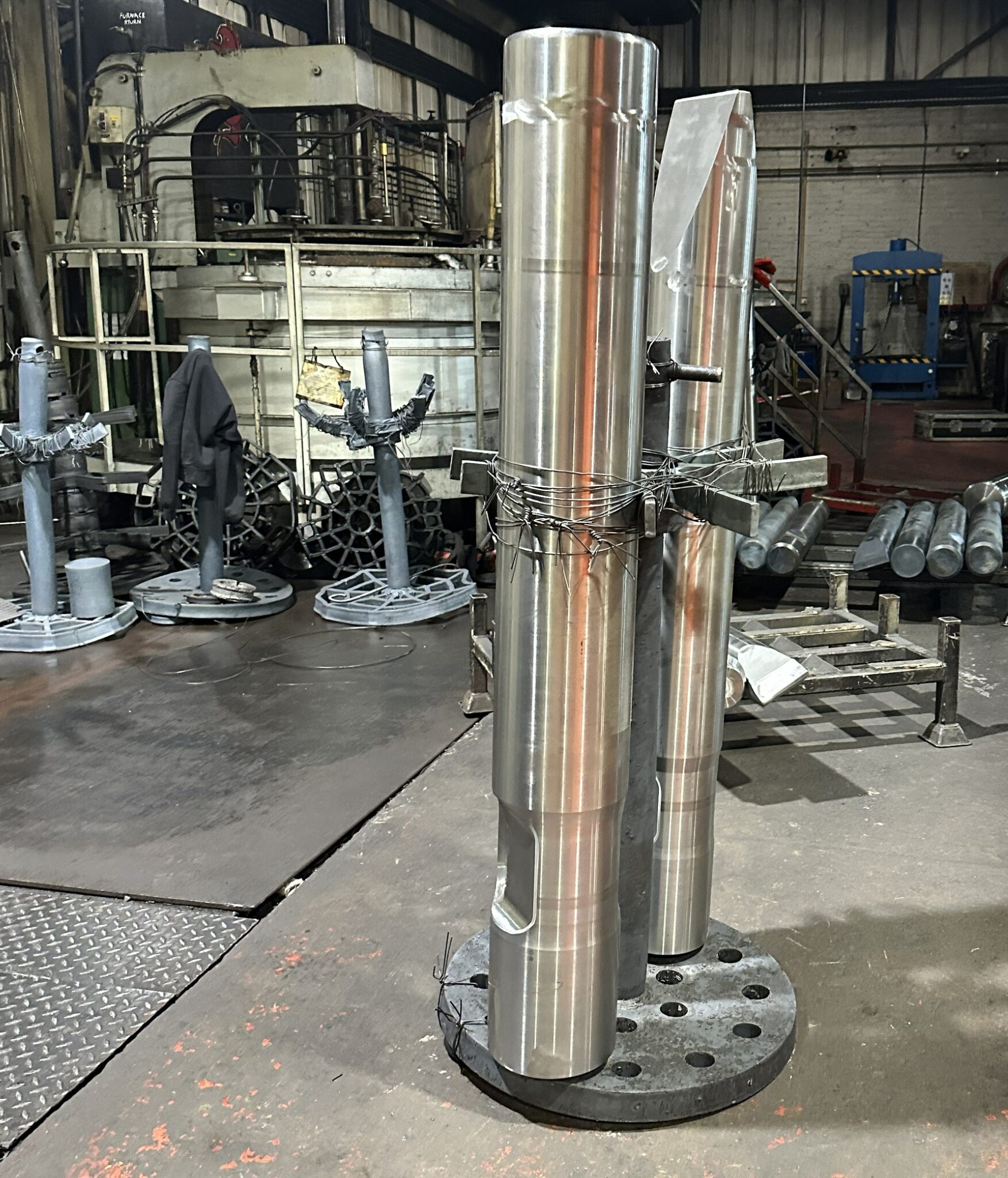

Rockbreaker Tools Prior to Oil Quenching

Rockbreaker Tools Prior to Heat Treatment

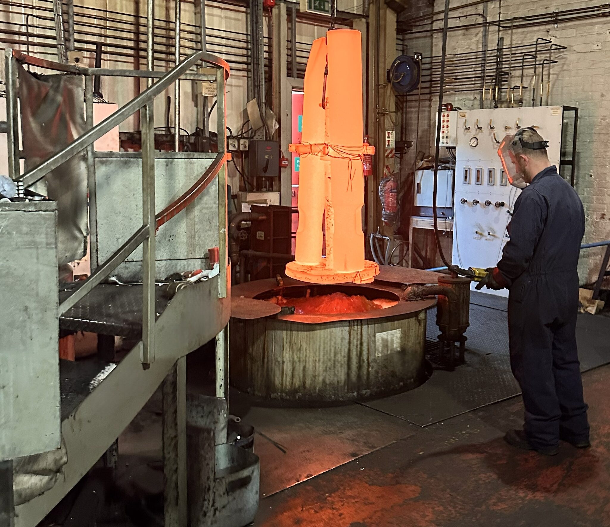

This being our first experience with hydraulic hammer tools we weren’t entirely sure what to expect, as it turns out the heat treatment process for hammer tools is very similar to rock drills-carburizing in pit furnaces using an endothermic atmosphere with oil quenching-in the case of “Caldervale” the company has two reasonably large pit furnaces.

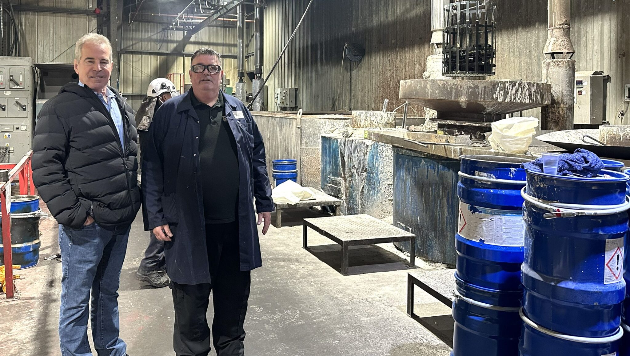

The centerpiece of the entire department is a substantial “salt” system offering the “QPQ” process-for those not familiar with this process we have this brief summary;
Nigel Troth, Sales Manager, SSi Europe, Jim Hamilton, Technical Sales Manager Caldervale Group
“QPQ” is a thermochemical surface treatment process that uses “quench, polish, quench” to significantly improve a metal’s wear resistance, corrosion resistance, and fatigue strength. It involves three main steps: an initial quench (nitrocarburizing) to form a hard compound layer, followed by a polish to improve the surface finish, and a final quench (oxidation) to create a corrosion-resistant oxide layer. This process results in a durable, black surface that can replace other treatments like chrome plating and minimizes distortion in the treated parts.”
