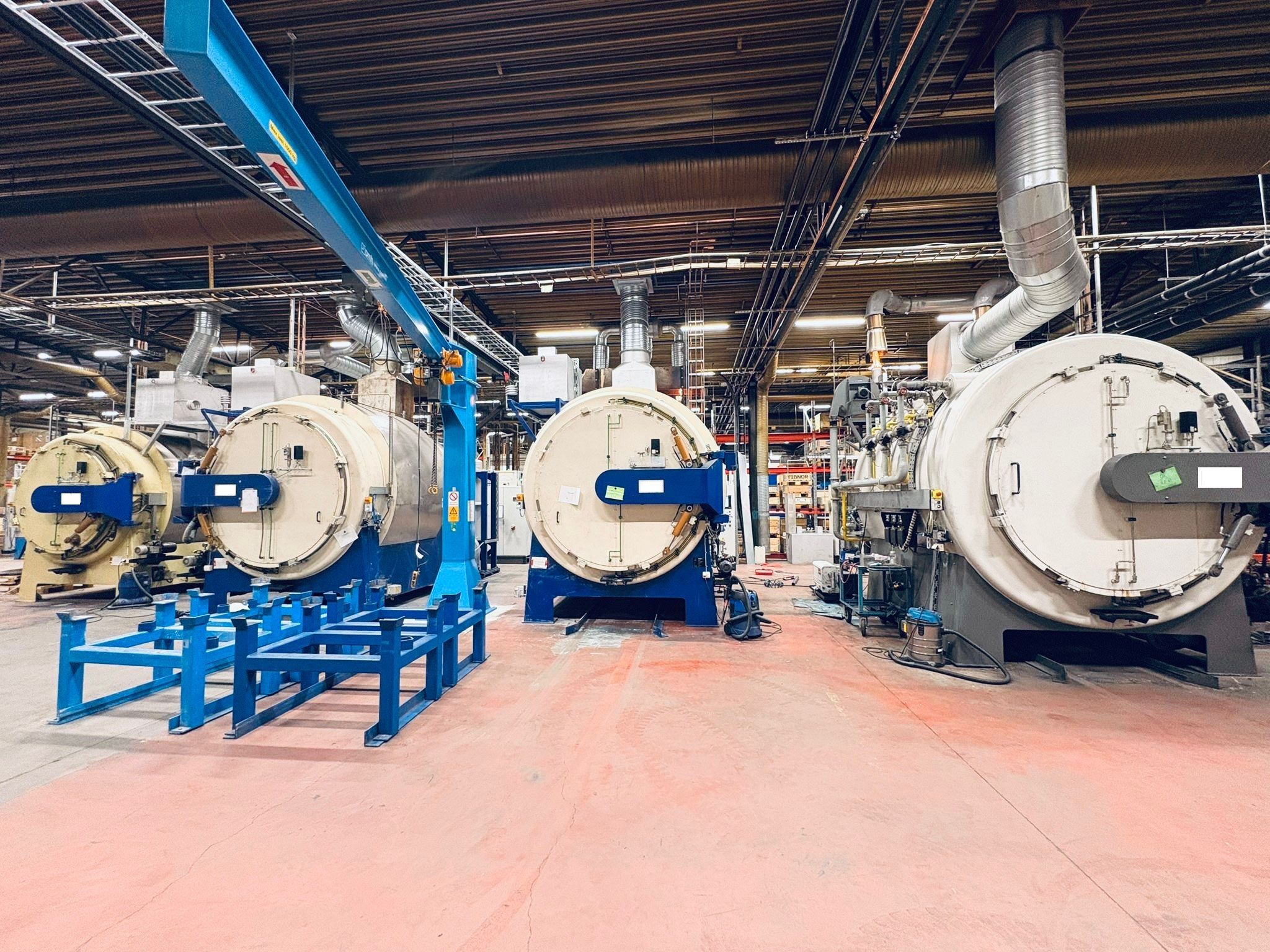

Recently the company completed a Swedish plant merger which is now complete. While the Värnamo plant offers several heat treatment processes (more details below) their focus is on nitriding which is very obvious when you look at this picture which features several large nitriding furnaces at least some of which are from German furnace builder KGO (not sure about all of the furnaces as there are no name tags). This photo shows the completed facility which is now operating at full capacity.

In the beginning of 2020 we also decided to shut down 2 of our last mesh belt furnaces, one manufactured by Sarlin and the other one by Safed. Even though a market still exists in Sweden for small parts and components that are processed in this type of furnace, pricing and the age of the furnaces made it easy to decide about our future.
At the same time, we made a decision to expand our sealed quench line so we can grow with this type of process that we are experts at. The market is growing, our customers are growing as well so we decided to adapt and expand in order to be more competitive in the market.
We bought a new RTQ size 10 furnace, a new tempering DC-10 furnace with protective atmosphere and we decided to replace the old loading/unloading car with a new one. All 3 machines were manufactured by Ipsen, who also provided the rest of the line. Our line is very long (40 meters) and really wide, so we ordered a custom-made unloader to fulfil our standards.
After we sold the old belt furnaces we did overhaul 2000 square meters in the oldest part of the plant, fixed the ventilation system, cleaned walls and painted them, filled old oil pits and installed a KGO gas nitriding furnace. This is a new process for us in Värnamo, but our colleagues in Anderstorp are experts in this area and their training and support is extraordinary. This is just one of the benefits of being part of the Aalberts Group, investments, growth and knowledge is limitless. Mirko Dandic, Plant Manager”
