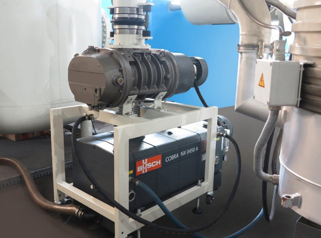

VHP has traditionally used oil lubricated rotary vane vacuum pumps to supply all the ovens. These vacuum pumps act as the forepumps of three-stage systems incorporating booster and oil diffusion vacuum pumps. This vacuum pump arrangement can achieve ultimate pressures of up to 1 x 10-5 mbar in the oven process chamber. If required by the process, the pressure can be increased by introducing controlled amounts of nitrogen.

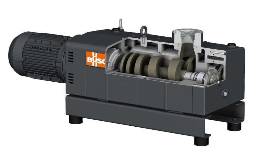

A few years ago one of these rotary vane vacuum pumps was replaced by a COBRA NX screw vacuum pump. This dry-compressing vacuum pump is a development by Busch, and has been designed specifically for heat treatment applications. No operating fluids are present in the compression chamber, making contact between the pumped medium and oil or other operating fluids impossible. This is achieved by two screw profiles which contra-rotate in the compression chamber without making contact with each other or the housing. This simple construction makes the COBRA NX a robust and economical forepump for the vacuum supply system.
The COBRA NX is in operation in a three-shift system, and as pointed out by VHP directors Frank Wallberg and Bernd Raabe, no servicing work was carried out so far. They also observed other advantages: the power consumption remained the same as the old vacuum pump, but the substantially increased pumping speed allowed heat treatment processes to be carried out more rapidly. The low noise levels generated by the COBRA NX test unit were also a pleasant surprise. Both VHP directors agreed that the COBRA NX is the ideal forepump for their future requirements, and when ordering new ovens will insist on models equipped with COBRA NX screw vacuum pumps.”
Fig. 1: COBRA NX screw vacuum pump as the forepump of a three-stage vacuum system. The booster vacuum pump is mounted directly to the COBRA NX by flange connection
Cross-section of a COBRA NX screw vacuum pump
