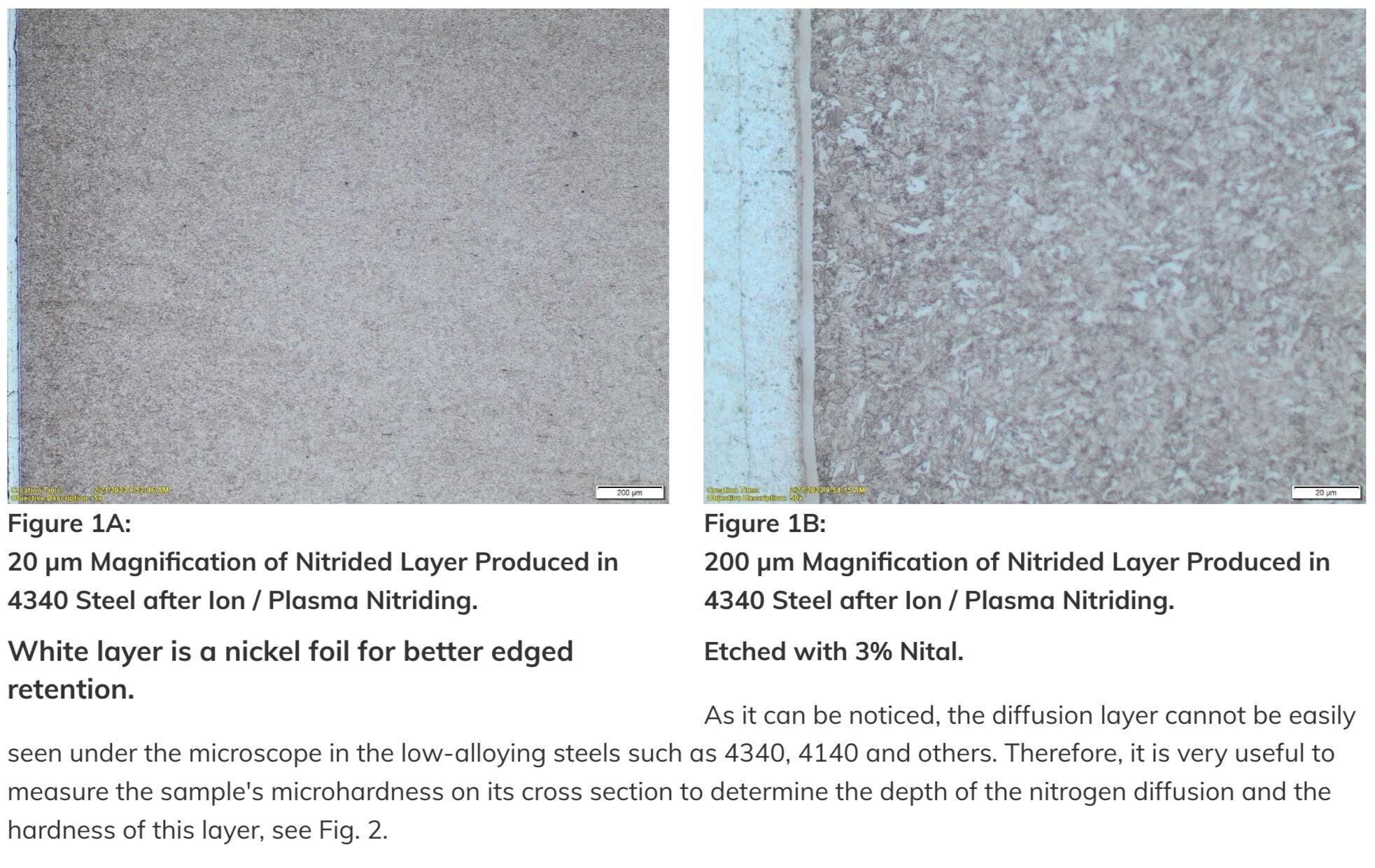

Low-Alloy Steels
The typical nitrided layer formed in these steels has two sub-layers: the compound zone and diffusion zone, see Fig. 1 a & b. The compound zone increases wear and corrosion resistance and the diffusion zone enhances the bending fatigue strength of the component.

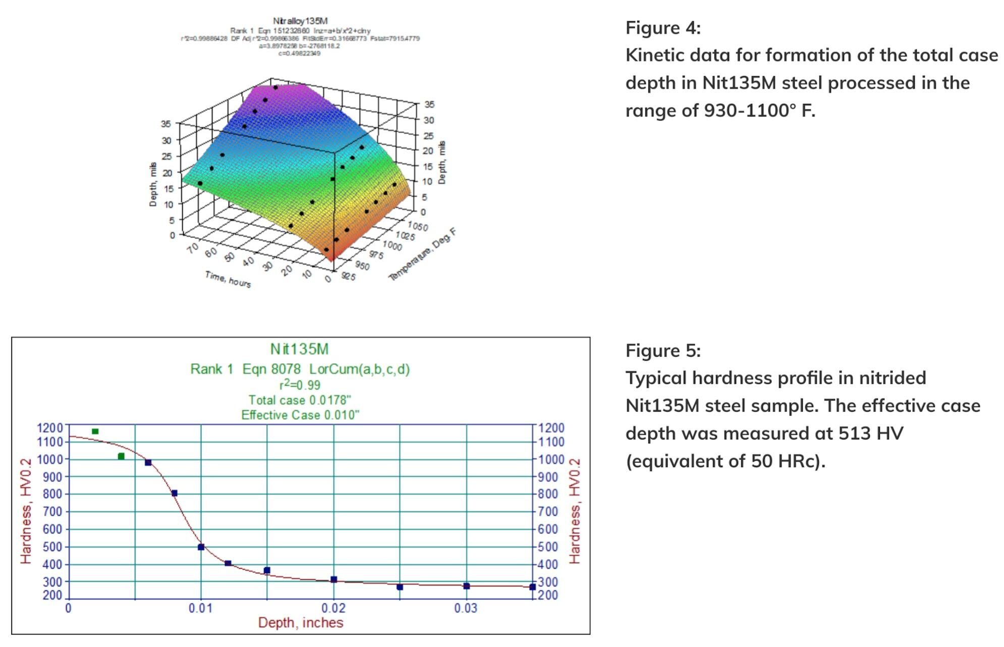

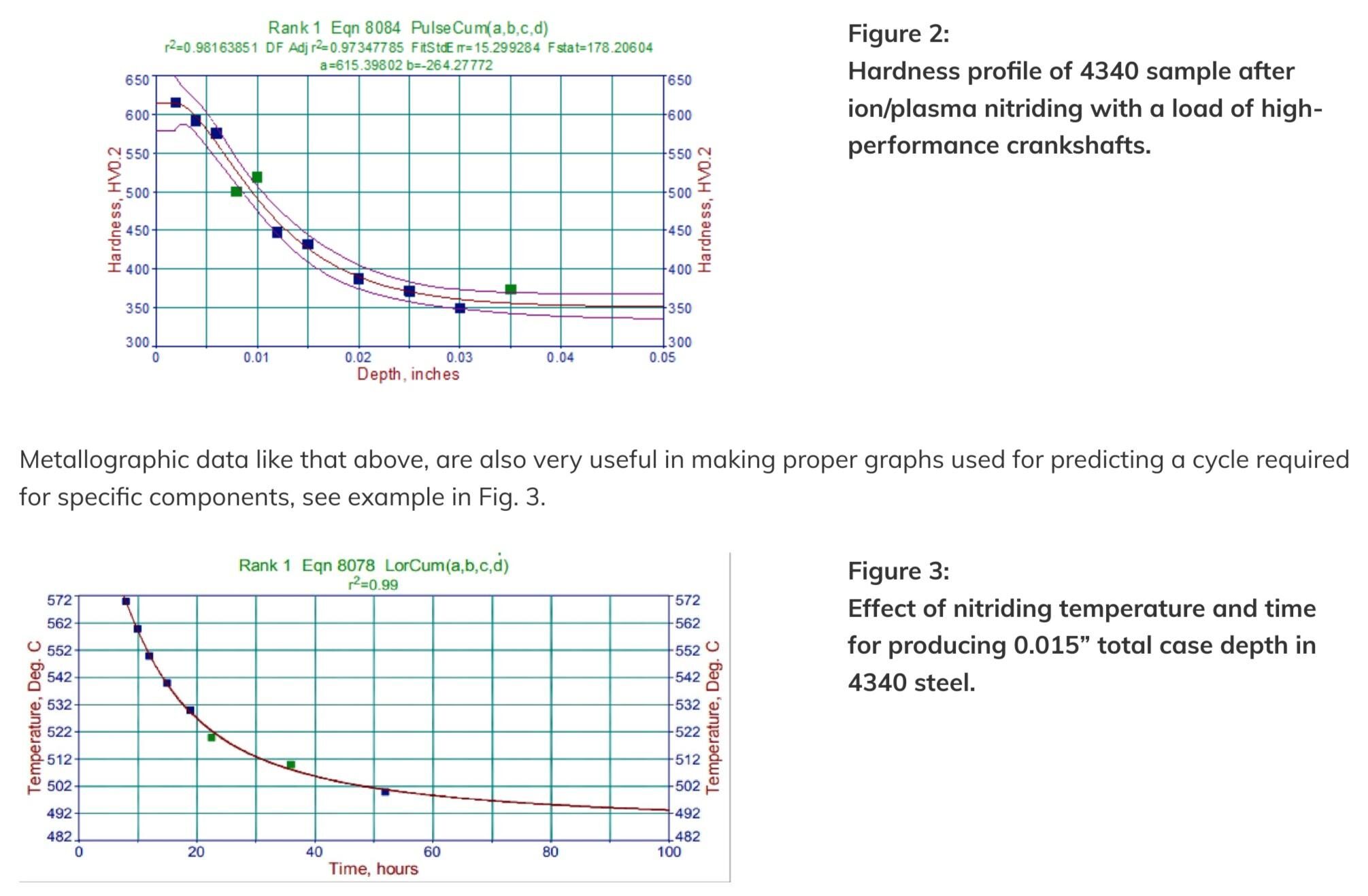

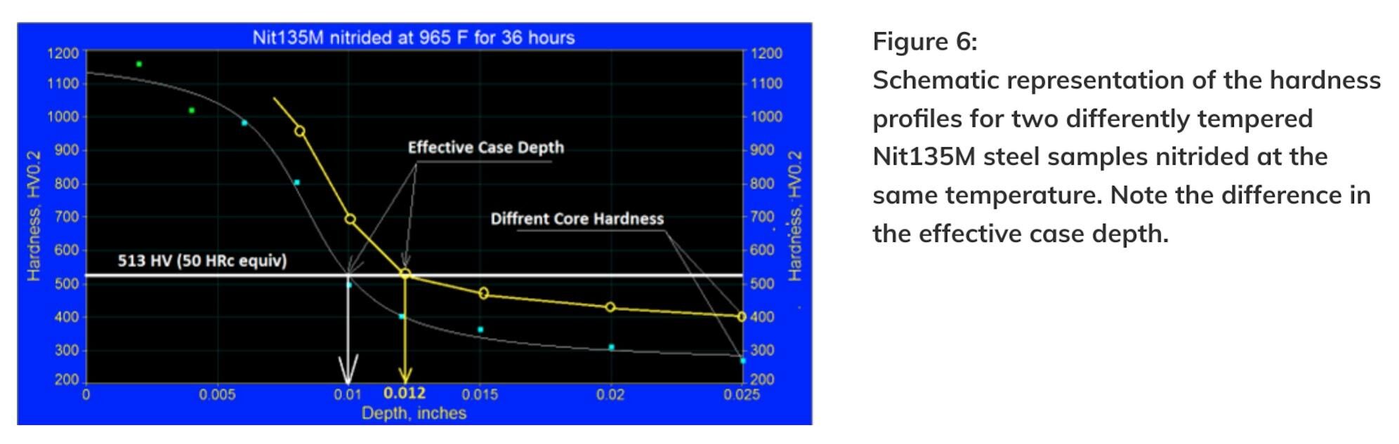

Data like those presented above can be also be used for making more sophisticated 3-D graphs illustrating nitriding kinetics for various steels such Nit135M, 4140 and others. These information help metallurgists at Advanced Heat Treat Corp. to write proper cycles for specific steels and the specific case depth requirements and properly set them for variously heat treated steels with different core hardnesses. A typical kinetic graph is shown for Nit135M steel, see Fig. 4.
It should be noted that the effective case for this specific, Nit135M steel was >50% of total case depth, Fig. 5.
However, it should be remembered that the relationship between the effective case depth’s percentage of the total case varies depending on steel and its tempering temperature. Therefore, it is important to note that the thickness of the effective case depth depends on the core hardness of the sample used for certifying the load and it may be different than in the actual parts. As mentioned before, this depends on the tempering temperature of the steel, see Fig. 6.

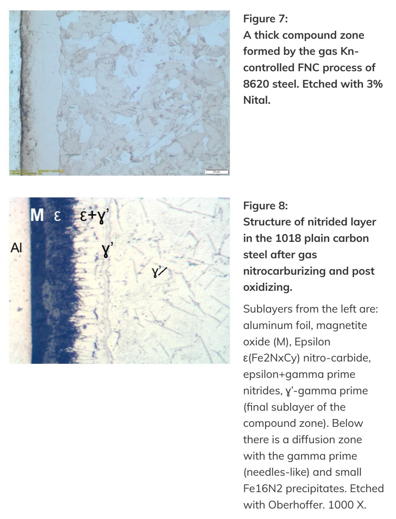

Plain Carbon Steels
Nitriding of the plain carbon steels such as 10xx, 11xx, 12xx and similar is oriented on formation of the compound zones of sufficient, larger than in the low-alloy steels, thicknesses. This is caused by the fact that these steels do not form sufficiently hard diffusion zones and also that their typical applications do not require a high bending fatigue strength but rather wear and corrosion resistance. There is a variety of the compound zones structures formed in these steels. Some of the examples are shown below.

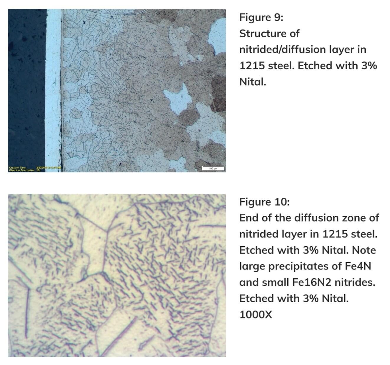

It should also be noted that the total thickness of the nitrided layers in these steels can be assessed by microscopic evaluations without a need for the microhardness testing. Diffusion layer in the carbon steels has typically precipitates of the gamma prime, ɣ’ (Fe4N) or Fe16N2 nitrides visible in the structure, see Fig. 9 and 10.

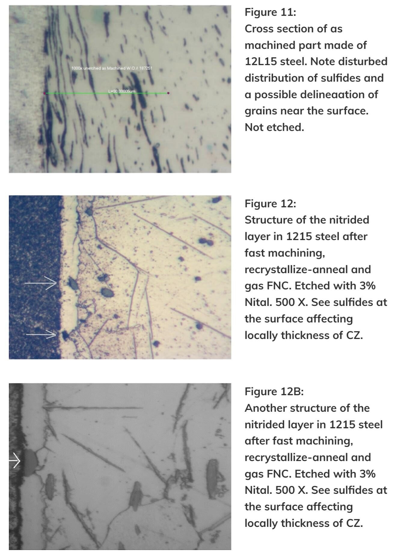

Identification Surface Defects Affecting Nitriding
Surface condition of steel parts have tremendous effect on their ability to accept thermochemical treatment such as nitriding or nitrocarburizing (Ref. 1 and 2-3). Too aggressive machining leading to distortion of the steel structure, its cold work, burnishing or inducing tensile stress at the surface may completely stop or inhibit nucleation of nitrides at the surface (Ref. 1-4). The same, negative effect on nitriding can be expected from surface contaminations, if the metalworking fluids and coolants are not completely removed from prior nitriding or FNC (Ref. 2-4). On the other hand, compressive stress induced by machining or shot peening into the surface may have a very positive effect on formation of the nitrided layer (Ref. 4).
The risk of producing unwanted stress condition by machining is very high and therefore general industrial/heat treating practice is to perform the stress relieving or recrystallize-anneal operation after rough, aggressive machining. After that, final machining should be applied to remove any remaining surface defects or conditions before nitriding or nitrocarburizing can be applied.
Machining operation affects surface structure of 12xx steel components resulting in distorted grains and a possible smeared surface. Insufficient stress relief/recrystallization after that may result in a condition, which affects nitriding or FNC processes resulting in waviness as well as insufficient thickness of the compound zone. Also, effects of sulfides presence in the steel cannot be overcome easily. Sulfides are a physical barrier to diffusion of nitrogen into the steel and if they are present near the surface (and they are!), they reduce effectiveness of nitriding, see Fig. 11. Such voids are very likely to occur since the sulfides are present everywhere and they may locally stop or limit diffusion of nitrogen. These phenomena cannot be controlled by any action of the machinists or heat treaters. Potential defects and surface imperfections of the steels affecting formation of the nitrided layers can be metallographically discovered and analyzed, see an example in Fig. 11 and 12.
It should be observed that there is a clear negative effect of sulfides on formation of the compound layer and potential for a local imperfection in properties of it. Nevertheless, those inclusions have no practical effect on wear resistance of the steel but may have negative effects on their corrosion resistance. [email protected]
