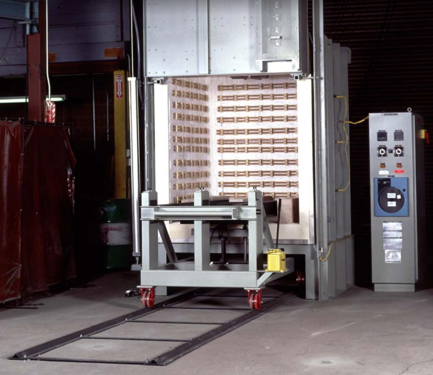

“JANUARY 14, 2021. L&L Special Furnace Co., Ships Box Furnace to New Pratt & Whitney Facility; Our understanding is that this box furnace is destined for the new Pratt & Whitney facility in Asheville, NC,  a location which will feature a brand new heat treating center. This project was announced back in 2020 and the plant is scheduled to open in early 2022.
​“L&L Special Furnace Co. has shipped a highly uniform box furnace to a major aerospace manufacturer located in the southeastern United States. The state-of-the-art-facility will be opening soon and be a central part of a new heat-treating center for aerospace and military components. The Model FB666 is a front-loading box furnace with a pneumatic vertical door. Its working dimensions are 60” wide by 60” high by 60” deep. There are a series of castable piers and an alloy grid that supply a very stable work platform for various part sizes and configurations.
​The furnace has a high-convection, air-cooled fan for air circulation and excellent uniformity at low temperatures. It was surveyed for performance prior to shipping and obtained certified temperature uniformity of ±10°F from 500°F to 2,000°F. There is also a venturi cooling system to aid in the cooling of the furnace interior along with an external modulating case cooling blower that provides fresh air intake to keep the furnace case temperature low during operation.
A manual 2,000lb. loader with rails and incorporated stops allows for the furnace to be easily loaded and unloaded. The loader moves on two low-profile rails and is indexed to the furnace front. Positive stops keep the furnace loader in line and prevent accidental impact with the rear or sides of the furnace.”
