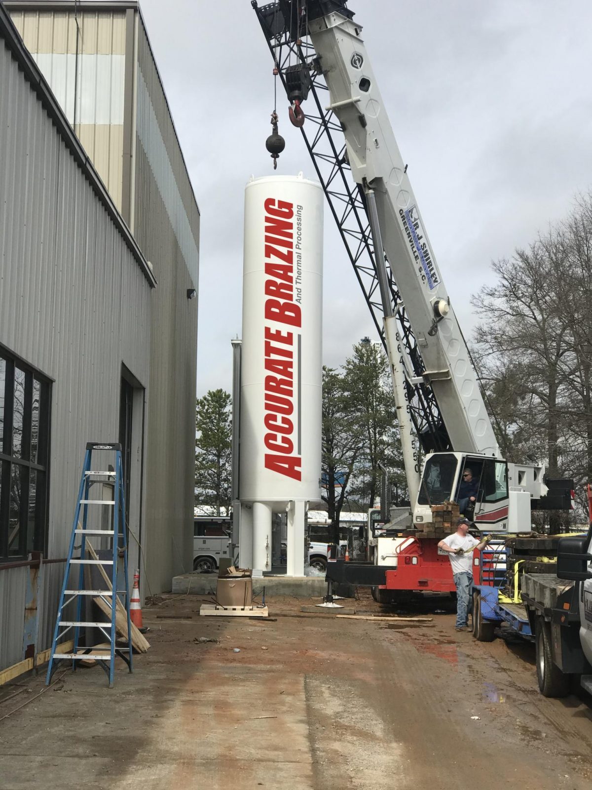

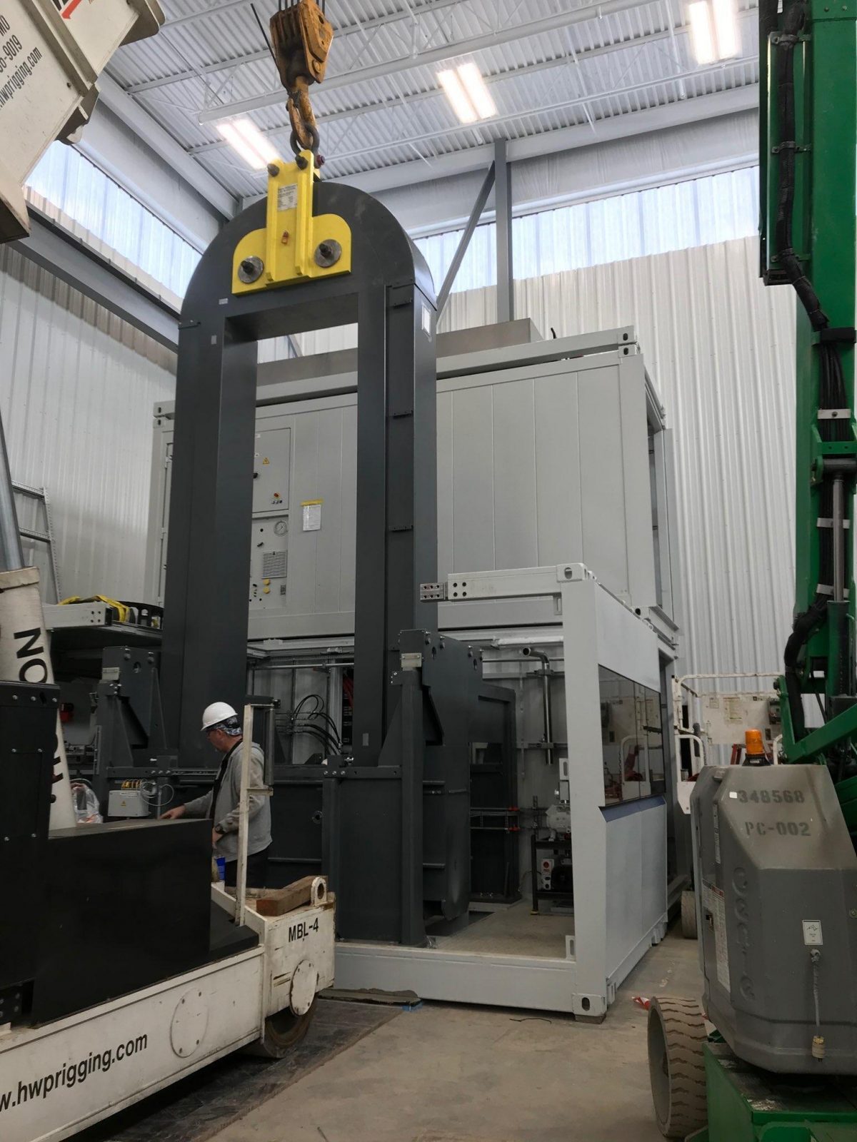

In early 2019 Accurate Brazing announced that they were joining a growing trend around the world by investing in a Hot Isostatic Press. The decision proved to be such a success that in November of 2019 the company announced they would be adding a second system (the November 2019 press release is below).  Things are proceeding as they should and these two photos show the installation as of just a few days ago. The third picture shows part of the vacuum department.
