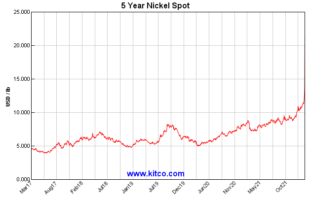

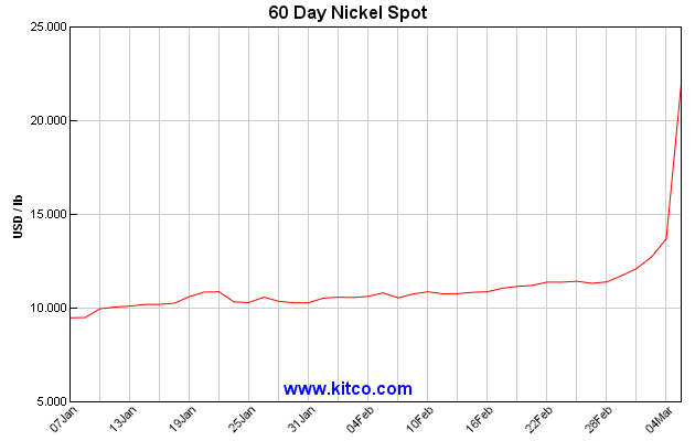

These graphs really demonstrate how quickly things have changed.
