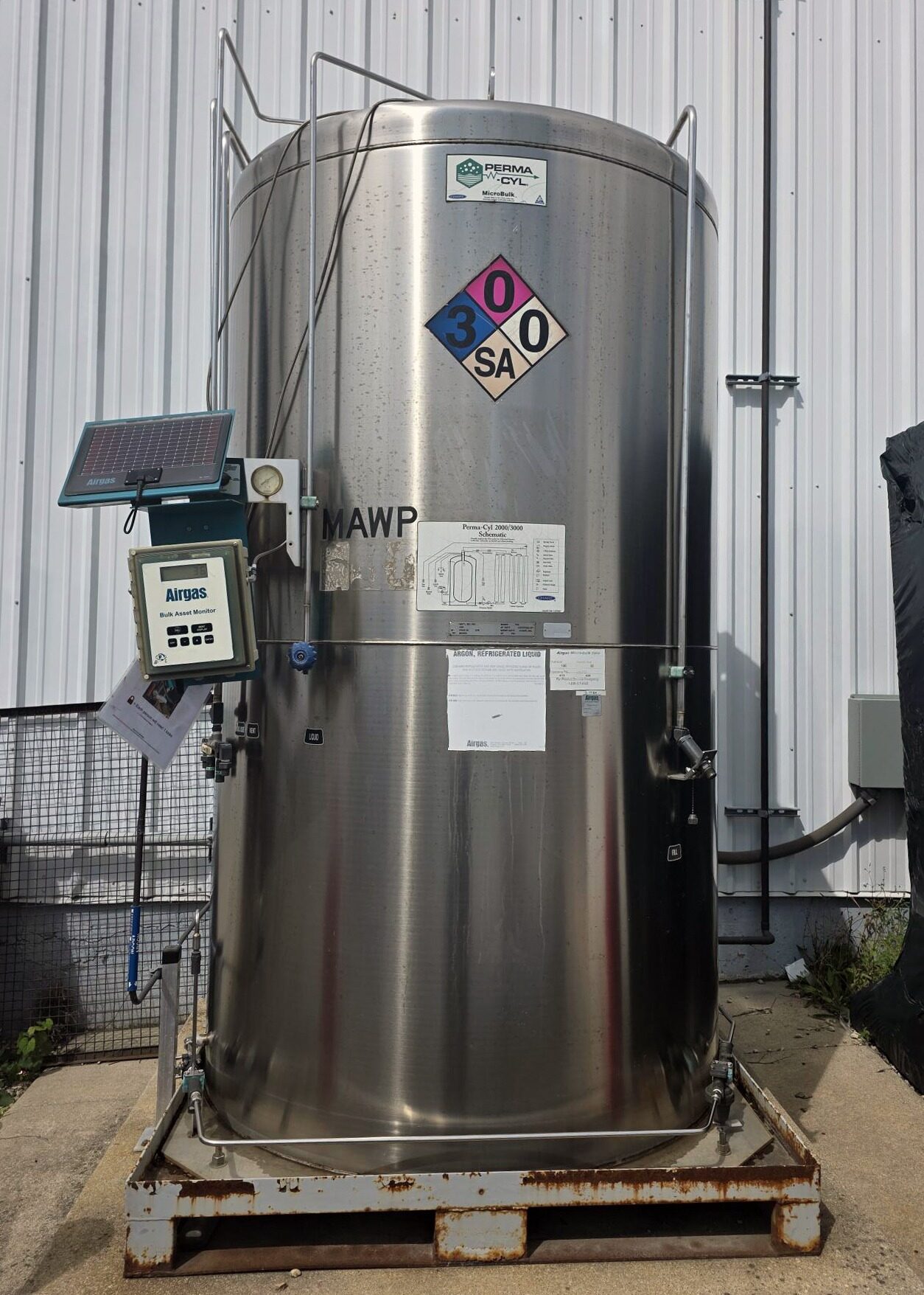

Argon Gas Tank

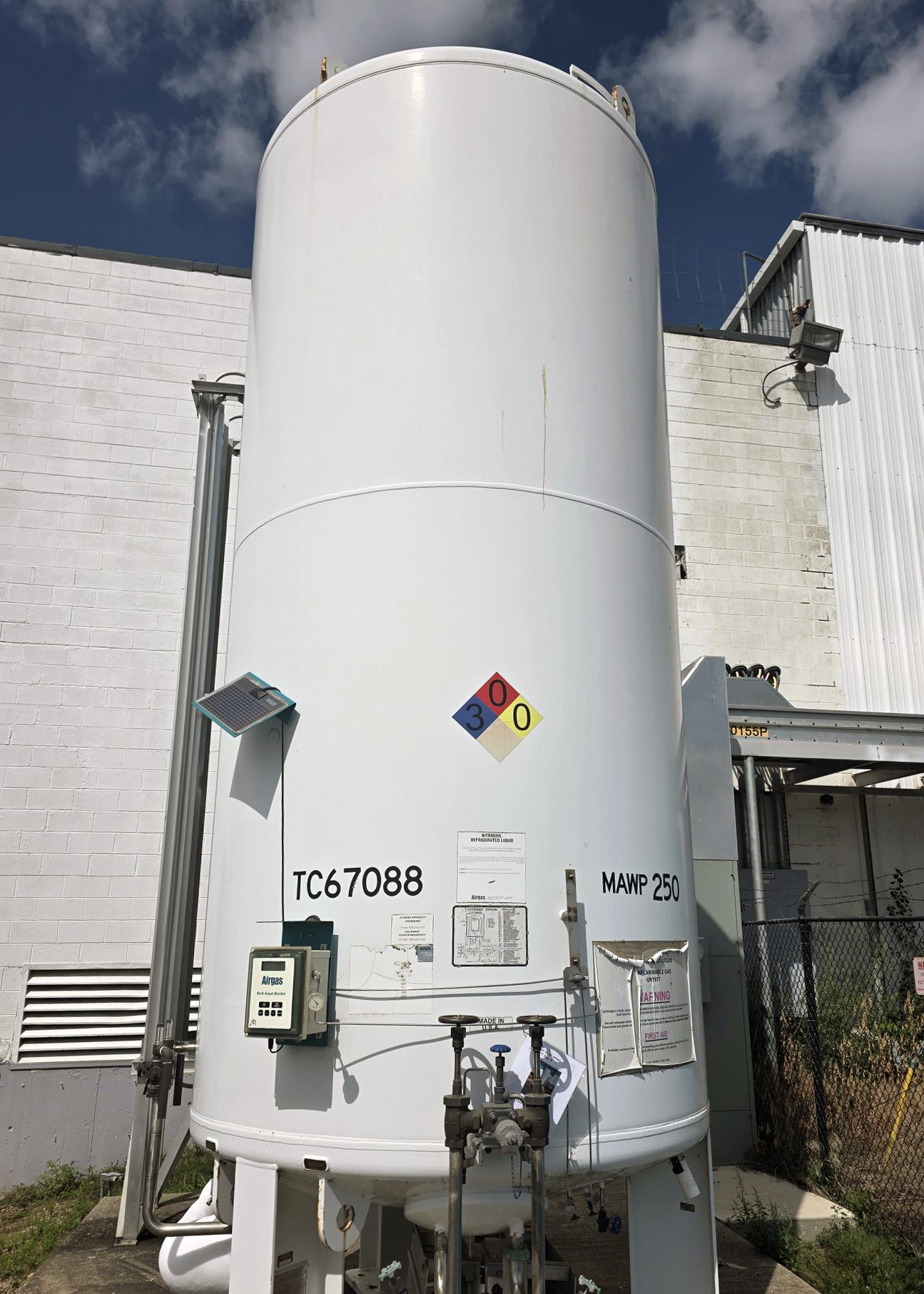

Nitrogen Gas Tank
Leaks not only waste process gases but also introduce atmospheric air into your vacuum furnace and can lead to discolored parts and an unsafe environment for your operators. Even the smallest leak from a pressure test warrants attention and response. Plumber’s putty can be a reasonable short-term solution to a very minor leak, but it should continue to be monitored and tested at a higher frequency when discovered, until the lines have been evacuated and a more permanent solution can be implemented.

Process Gas: Argon (and other heavier-than-air process gases)
Argon is an inert gas frequently used for quenching in the aviation industry. Aviation relies on argon to avoid even the slightest chance of nitrogen embrittlement during quenching. Argon can also be used for other processes, including partial pressure and convection heating.
Because Argon is a noble gas, the fact that it is non-reactive helps maintain the chemical integrity of parts processed in the chamber, preventing oxidation and contamination. Argon, however, is an expensive gas, which means its used less frequently across other industries than nitrogen gas, unless argon is explicitly specified.
Argon is heavier than air, which is fortunate when used for partial pressure heat treating in particular – there’s less sublimation into an atmosphere made of these heavier atoms. Argon can provide a protective blanket around parts in the chamber as they are quenched, preventing distortion and delivering clean parts free of unwanted nitriding effects.
Because argon is heavier than air, when it is released from a furnace without being pumped out, it sinks to the lowest areas it can find. Factories operating furnaces that use argon will want to monitor any proximate low-lying confined spaces nearby, like pits for machines, or sub-grade rooms like basements for the presence of argon.
Though argon itself is non-toxic, when argon is allowed to accumulate inside a pit or low-lying area, it displaces the typical oxygenated atmosphere that was there, making those spaces potentially dangerous for maintenance teams that need to descend.
It’s strongly recommended that any person that enters these areas follow their confined area protocols, including wearing personal gas sensors on their lapels, as close to their faces as possible. Additionally, there should always be a spotter nearby that can confirm the safety of the person entering the confined space.
If it is suspected that a low-lying area has accumulated argon, evacuate that area and assess the hazardous conditions. Should you also suspect the possibility of other heavier-than-air gases may have also accumulated there (like propane), remove any possible sources of ignition and use multi-gas detectors to discover what else may be in the atmosphere within that space.
Removing argon requires forced air ventilation, with the exhaust fans and ductwork placed as low as possible within the affected area, keeping any blower motors safely distant from the opening to eliminate the possibility of accidental combustion of any other accumulated gases. Maintenance technicians should always wear the appropriate types of PPE when working in these conditions.
