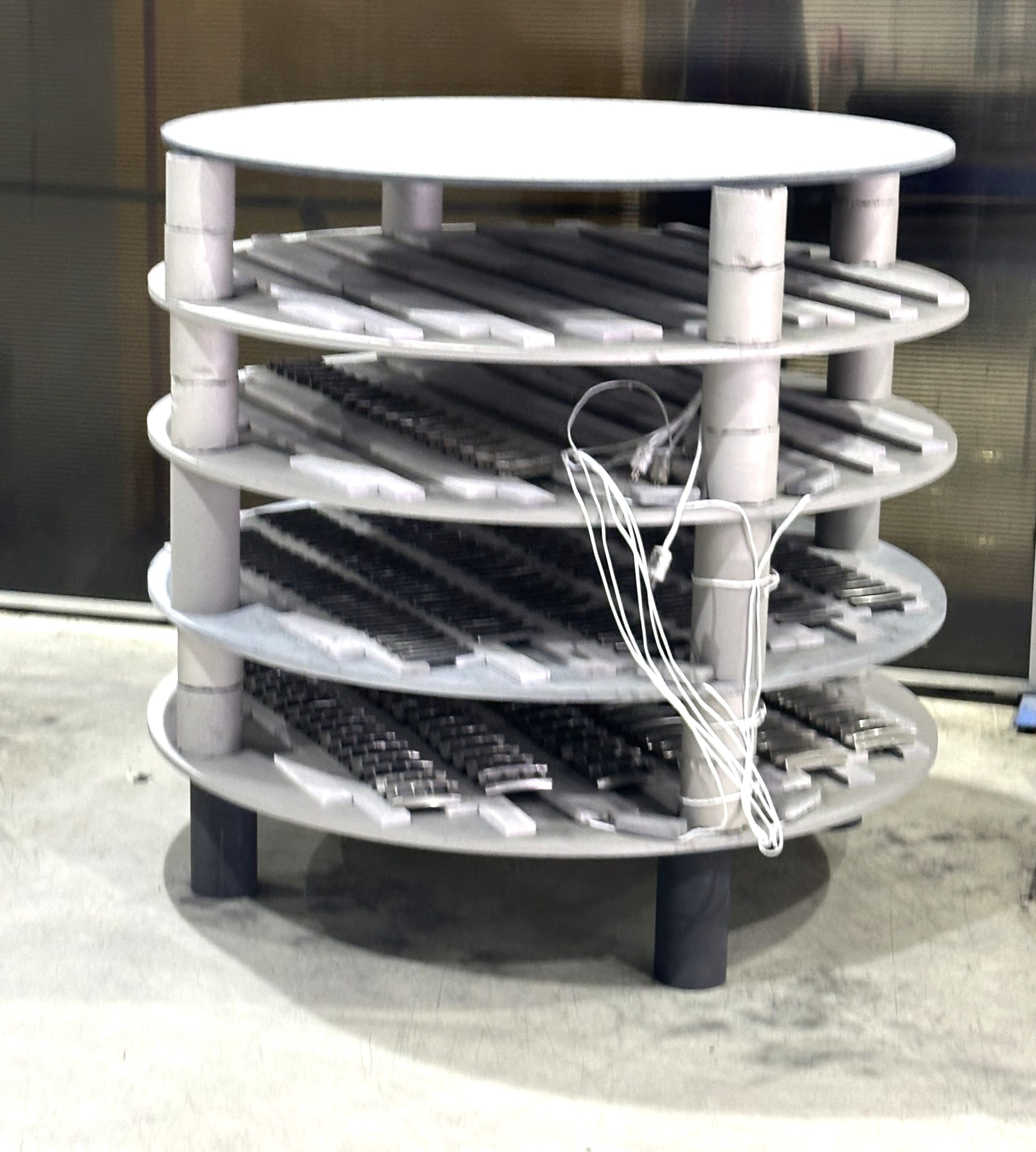

Included in this article are photos from 3 “Barnes Aerospace” locations and one “GE” facility. In the case of the “GE” facility, what can be seen is a fixtured load preparing to go into an “Ipsen” bottom load vacuum brazing furnace (which is not shown).

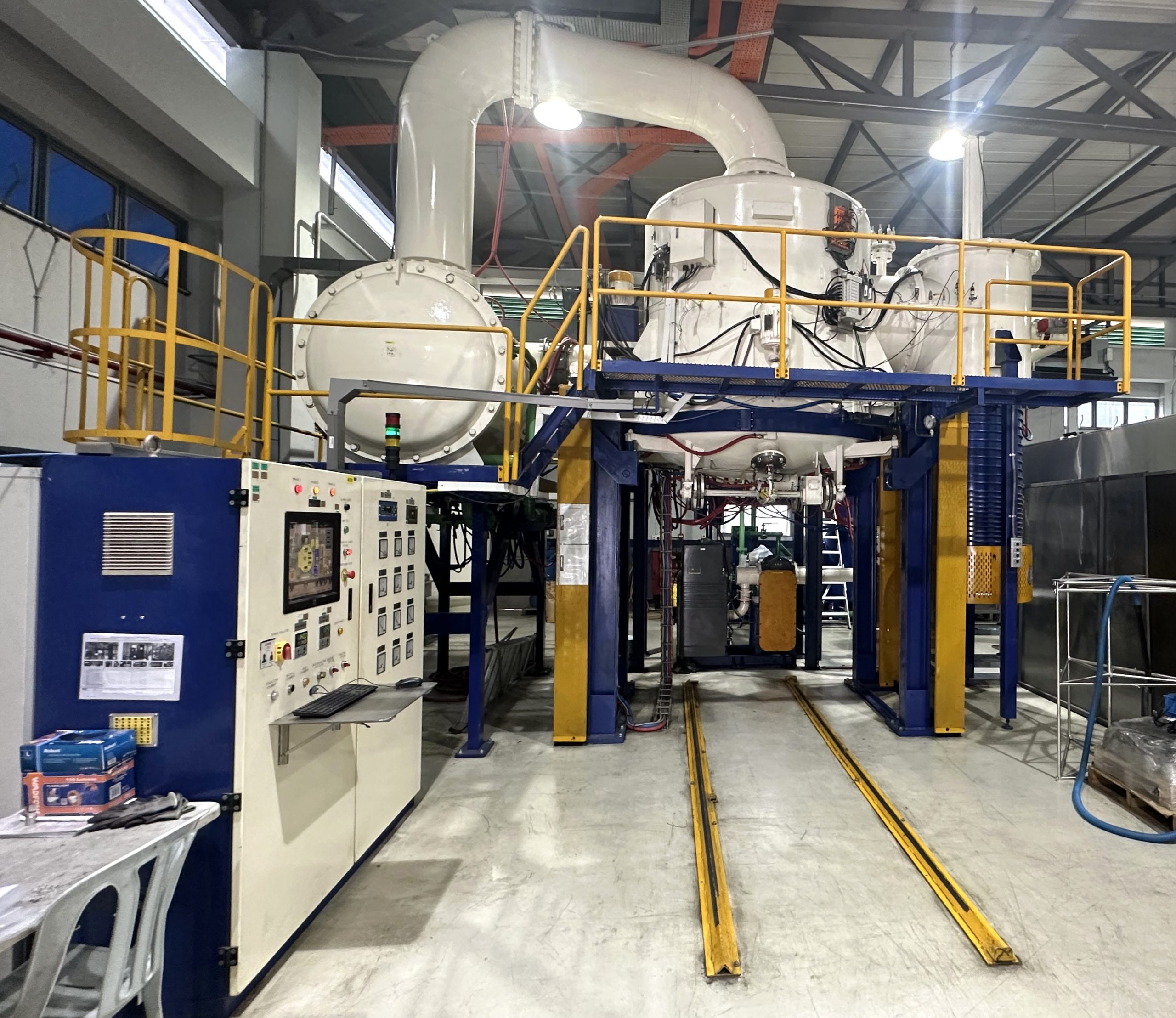

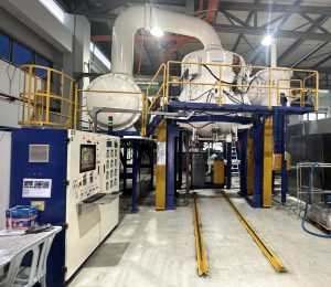

Another photo shows a rebuilt “Ipsen” bottom load vacuum furnace with working dimensions of 48″ diameter x 54″ high, capable of 1100C with 2 bar argon quenching and a 35″ diffusion pump.

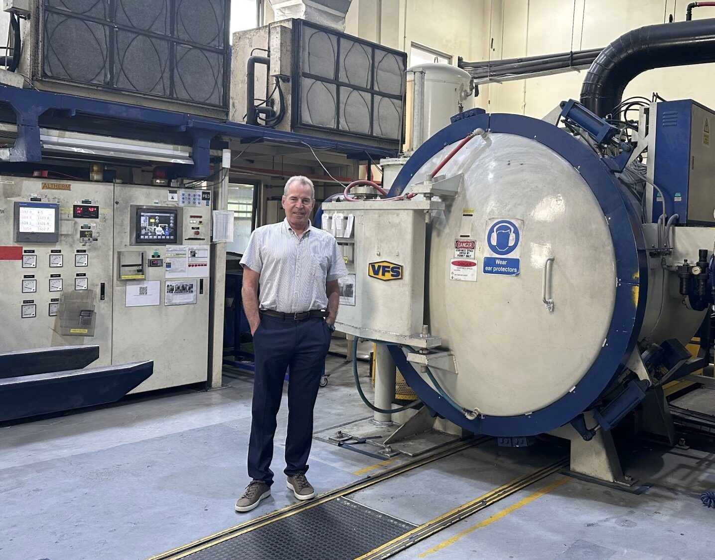

Other photos show two older horizontal “VFS” (Vacuum Furnace Systems) furnaces at a second Barnes location.

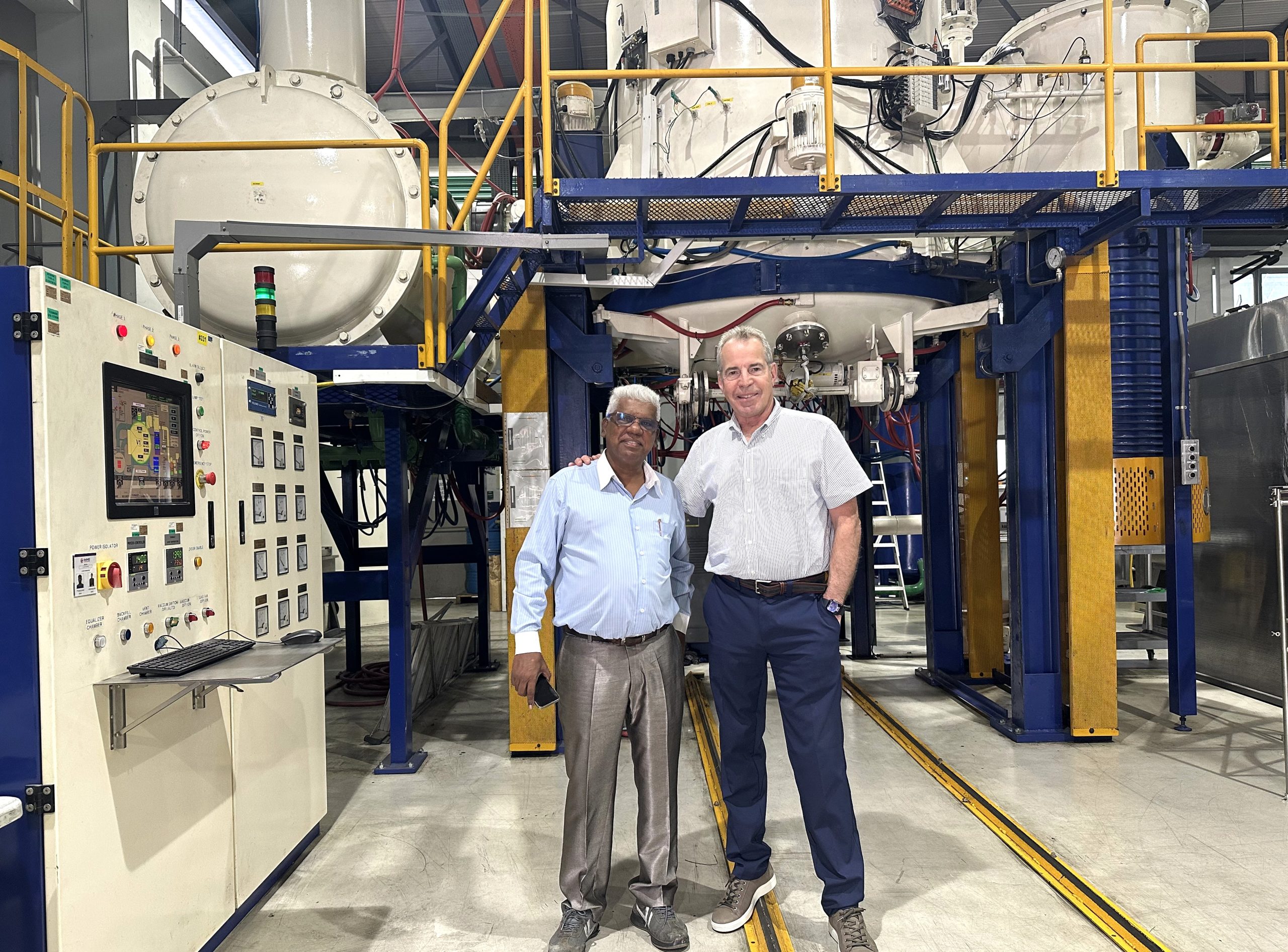

Our host for these visits was “Rui Shan Engineering”, a furnace rebuilder with a location in Singapore and a manufacturing facility in Thailand with 16 people. “Mr. Christopher Rajendran”, Owner., is shown in one of these photos, his partner “Mr. John Muraly” was not available during our visit.
