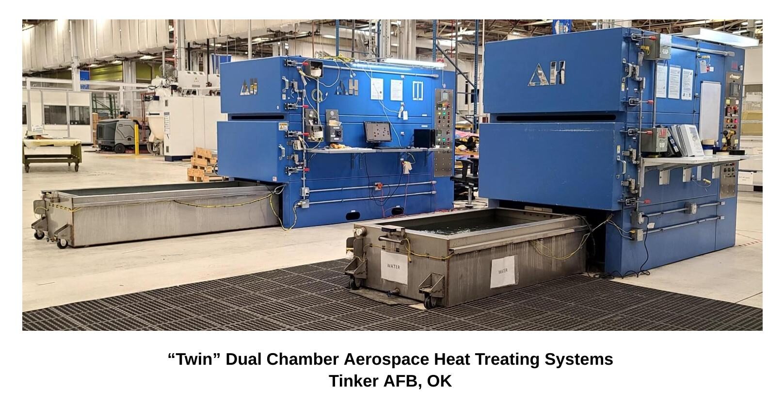

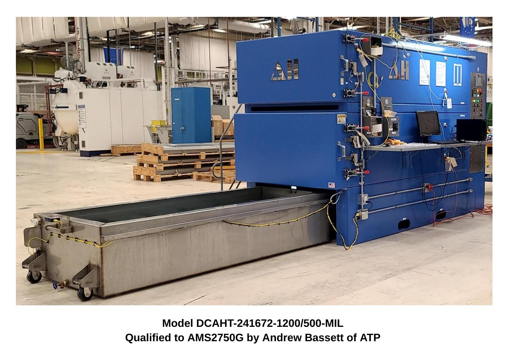

Oklahoma City – Tinker AFB: DELTA H® recently delivered the first heat treating system certified to AMS2750G for heat treating aviation grade aluminum for military aircraft. The new system is the second installation at the massive depot facility and placed side by side with the previous DELTA H Dual Chamber Aerospace Heat Treat (DCAHT®) system installed in 2015. Third party services for calibration and qualification were performed by Andrew Bassett of Aerospace Testing and Pyrometry and completed within one day on site. The certifications for instrumentation, Temperature Uniformity Surveys and System Accuracy Testing were completed through ATP’s new Aerospace Compliance Software (ASC) to AMS2750G.
The newly installed DCAHT® features a certified TUS volume of 24” wide, 16 inches high, 72 inches long, with an upper chamber convection oven operable to 500°F, and a lower chamber convection furnace operable of 1200°F. In addition to aluminum, the system can be used for PH stainless steel aging, as well as titanium and ferrous alloy processes. Both chambers qualified as Class 1, and were certified as Class 2 for aluminum applications. Honeywell controls and recorders are featured and include remote computer control, data entry, process monitoring and produce irrefutable batch records with quench delay.
