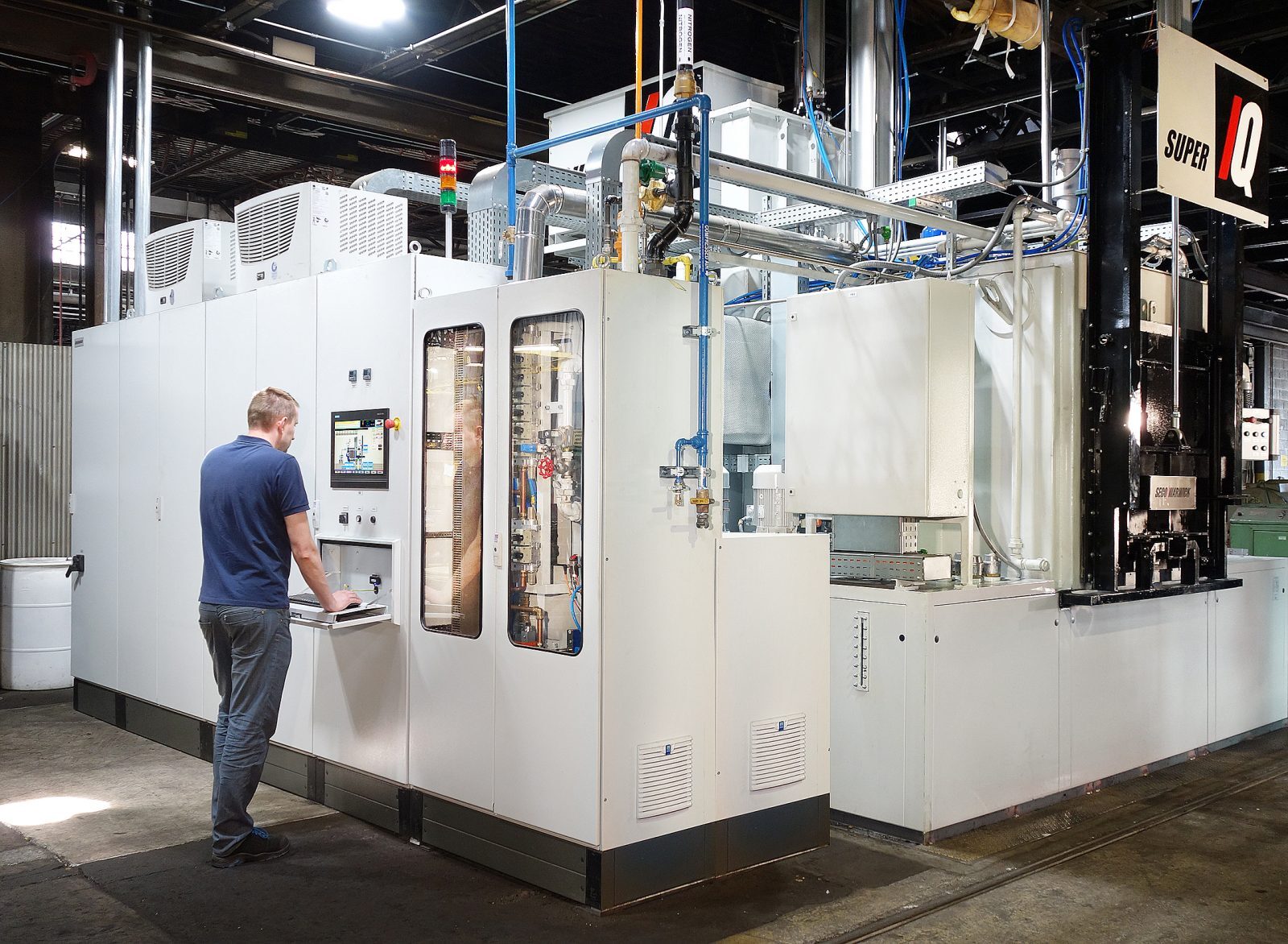

“Rex Heat Treat, a commercial heat treater specializing in the aerospace market, has become the first company to install and commission the new Super IQ® Gas Carburizing furnace. Over the past several years, Rex has commissioned several new SECO/WARWICK Group vacuum furnaces  at their Lansdale, PA location as part of a plant modernization initiative. So, when Super IQ was introduced in 2019, it represented another opportunity to upgrade their through-hardening and carburizing capabilities alongside their legacy harden and temper furnaces, while using their existing loader, baskets and washing system. Super IQ was designed specifically to eliminate the need for endogas, and its inherent flames and carbon monoxide dangers. Instead, Super IQ allows clean processing and can even achieve higher temperature carburizing to speed cycles and improve yields in certain steels in a clean and cool manner. Parts also come out much cleaner and brighter.”
