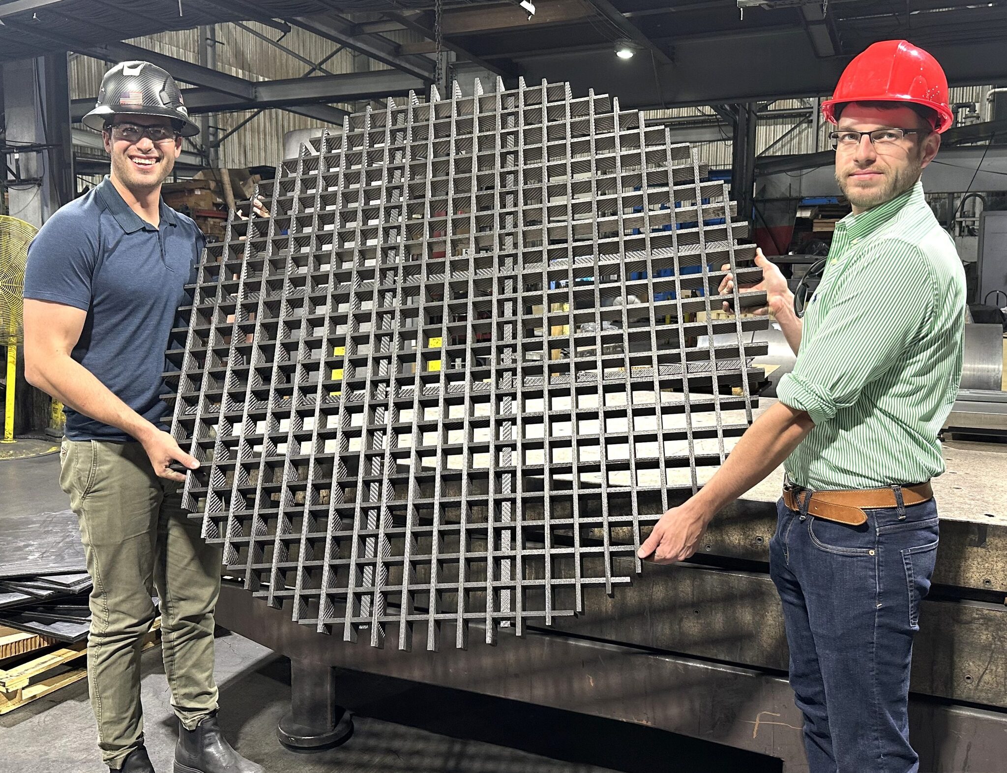

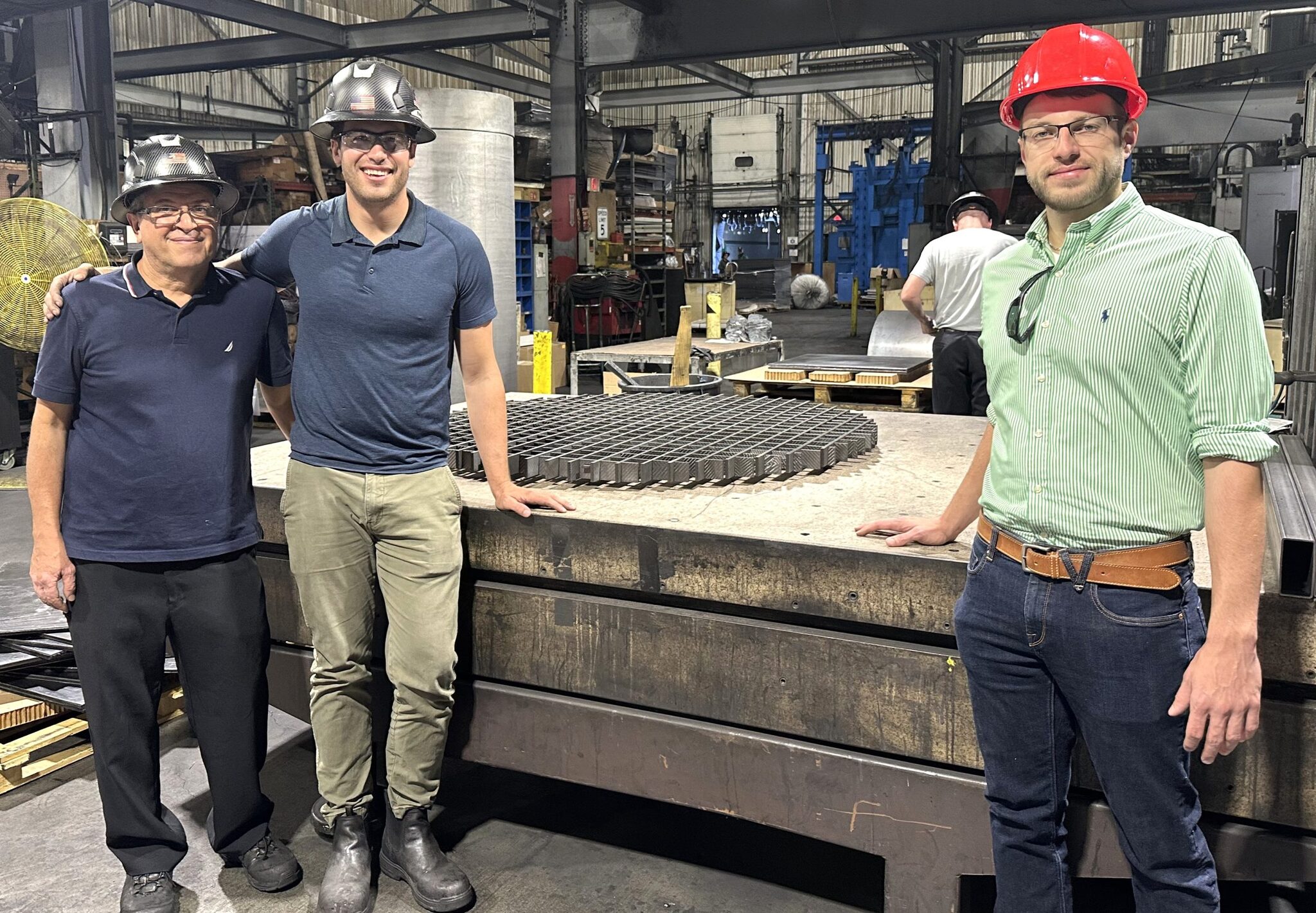

More production equipment is in the process of being installed and brought on line, and the growing product line was obvious. As an example, Daniel Broodo, Director of Technology and Mehrdad Jafarabadi both of “Americarb” showed us this 48″ diameter Carbon/Carbon fixture designed for use in a large bottom load vacuum furnace. While this type of fixturing has to date represented a very small portion of the North American heat treatment industry it is growing as the advantages become more obvious to end users.
