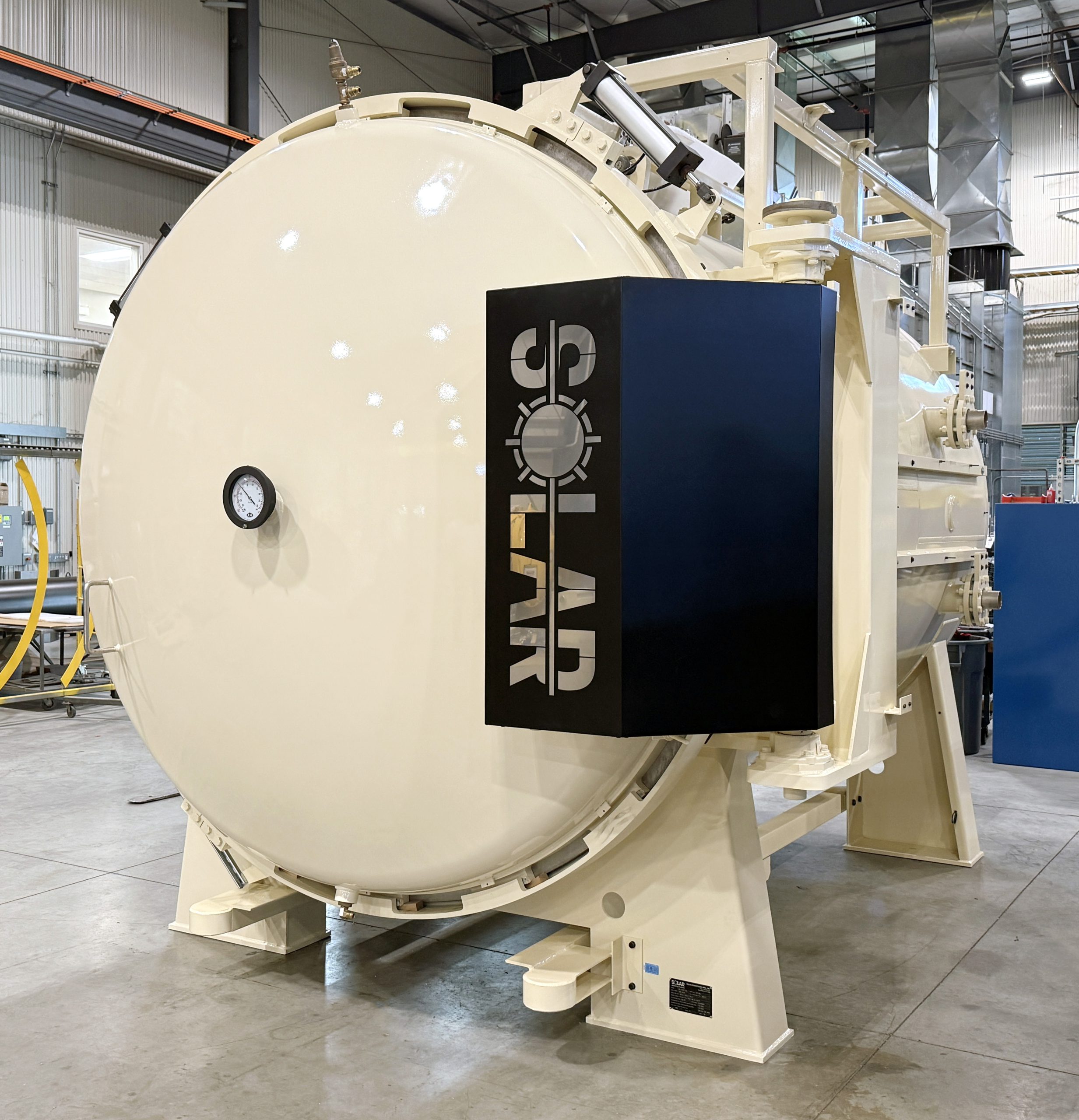

The delivered system features a graphite-insulated hot zone measuring 48” wide × 48” high × 60” deep, capable of reaching temperatures up to 2400°F (1370°C). The furnace can accommodate workloads up to 5,000 pounds and includes an internal gas cooling system that provides rapid 2-bar nitrogen quenching, powered by a 100 HP motor with variable frequency drive control.
