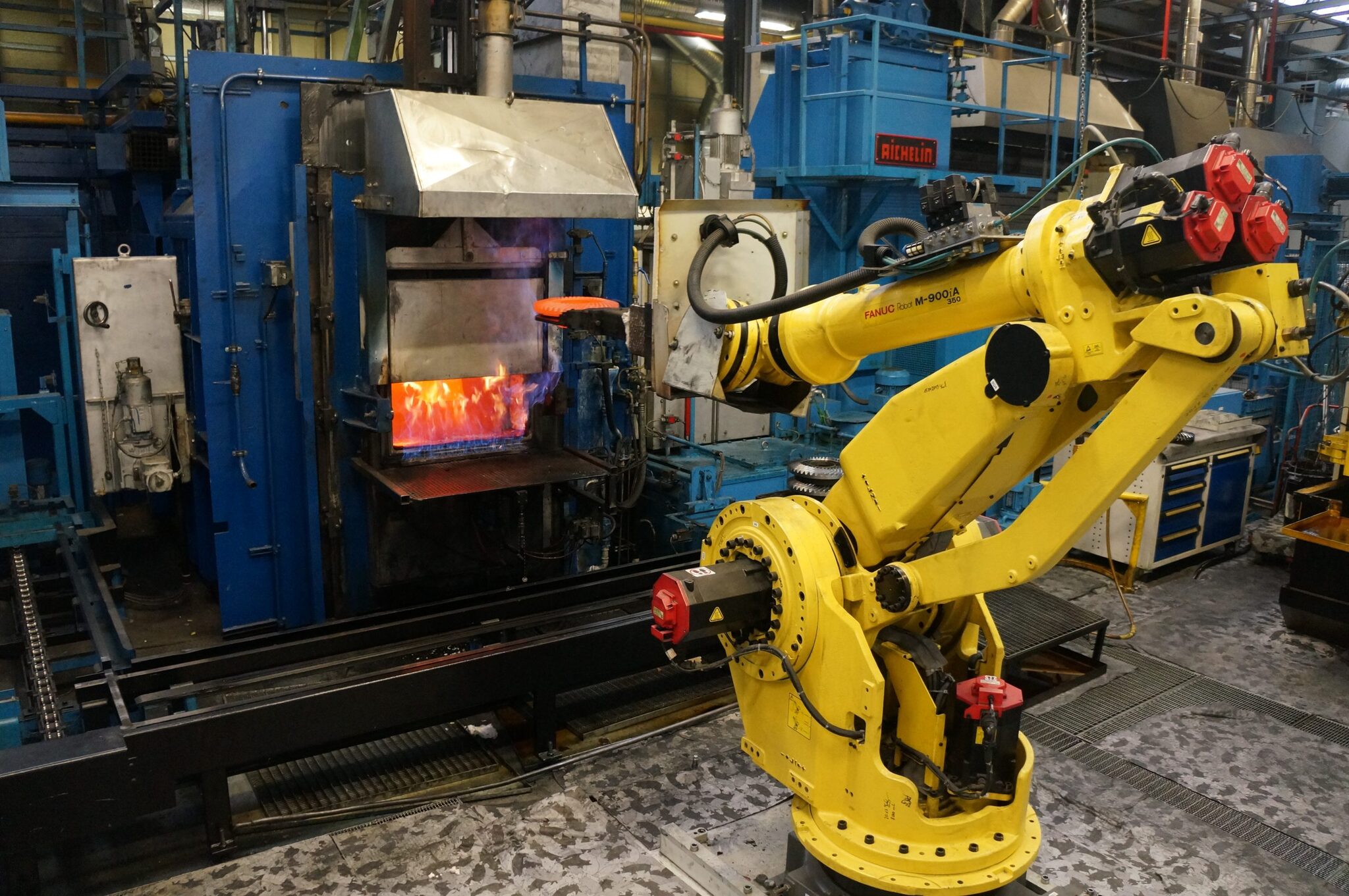

Today we have another example, this from in-house heat treater “AGCO/FENDT”, in Marktoberdorf, Germany-a manufacturer of tractors. This example is quite common in that press quenching applications rely heavily on robots-we would assume because this is because this is single part processing of high end parts. What you are looking at in these photos (taken by Gord Montgomery of “The Monty”) is an automated press quenching cell. This is dedicated to a small group of transmission components requiring the tightest specs on distortion and this cell is 100% automated-parts go in one end and robots take over all of the loading/unloading. We can’t tell you off hand who supplied the press quenching system, there are two major suppliers of press quenching systems in Germany, “Wickert” and “HEESS” both of whom do a very good job.
In this case parts are removed from an “Aichelin” rotary hearth furnace and transferred to the press quench system via a robot-look closely and you can see a “heat shield” attached to the robotic arm just behind the “gripper”. Similar robotic systems can also be found in heat treat applications for clutch plates, bearing races and a wide variety of gears.
