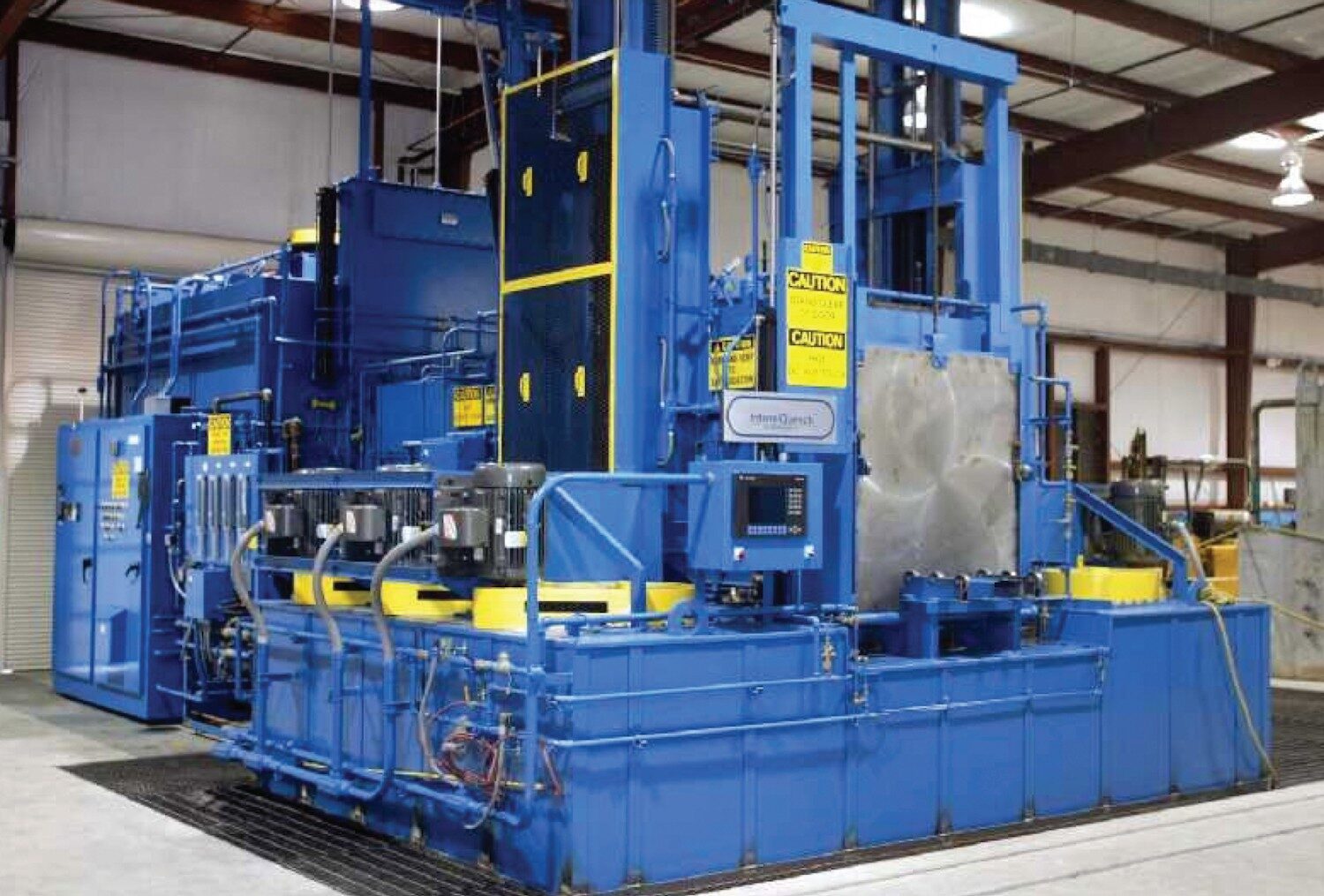

IQ Technologies Inc., of Cleveland, Ohio, USA has for a number of years been marketing a process called “IntensiQuench”, a very interesting and promising process using water as the quenching medium. While the process offers some advantages over oil or polymer quenching it has never quite achieved “mainstream” acceptance. According to this press release Induction heat treat supplier Ajax TOCCO Magnethermic has acquired the assets of the company. The attached photo shows a batch IQ furnace set up for the “IntensiQuench”-this furnace was located at Euclid Heat Treating in Euclid, Ohio.
