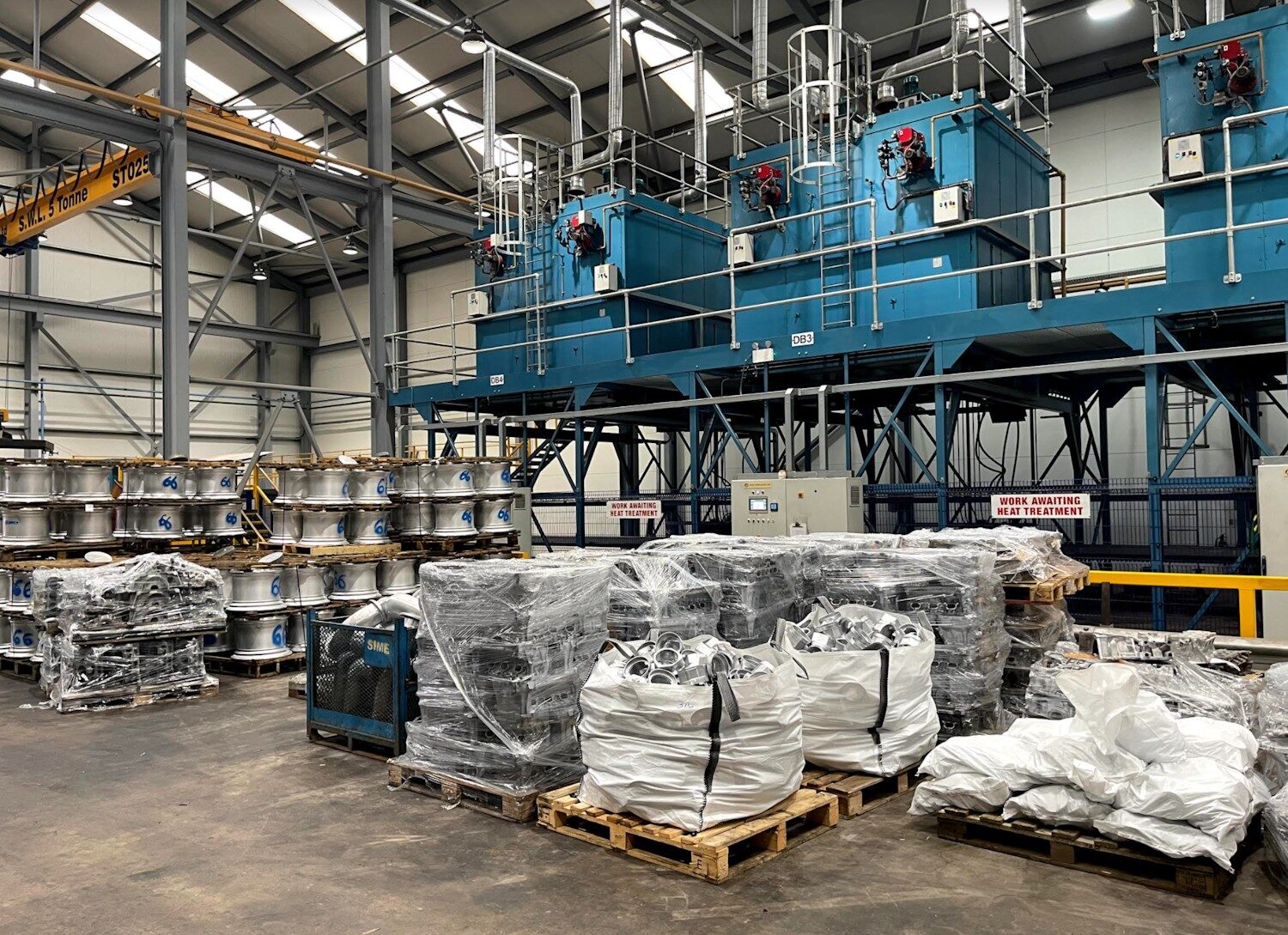

JANUARY 2020 PRESS RELEASE; “Heat Treatment 2000 Ltd./UK. We are about to announce the opening of a new  £3 million heat treatment facility for aluminium processing. It is sited adjacent to our existing facility and complements our current aluminium capability and the 300 tons per week of fasteners and presswork we currently heat treat. The investment consists of a suite of automatic computer controlled rapid quench furnaces capable of taking up to a 3 ton charge which can be quenched in temperature controlled cold water, hot water or polymer. The latter is followed by and agitated rinse and hot power wash to ensure product cleanliness. This is supported by new precipitation ovens with automatic door opening. Furnaces are a combination of gas and electrically heated opening up new opportunities as well as meeting increased demand for our services. Our investment doubles capacity giving us one of the largest processing capabilities in the UK. Bar code tracking and scanning have also been introduced providing live data which can be accessed remotely.”
