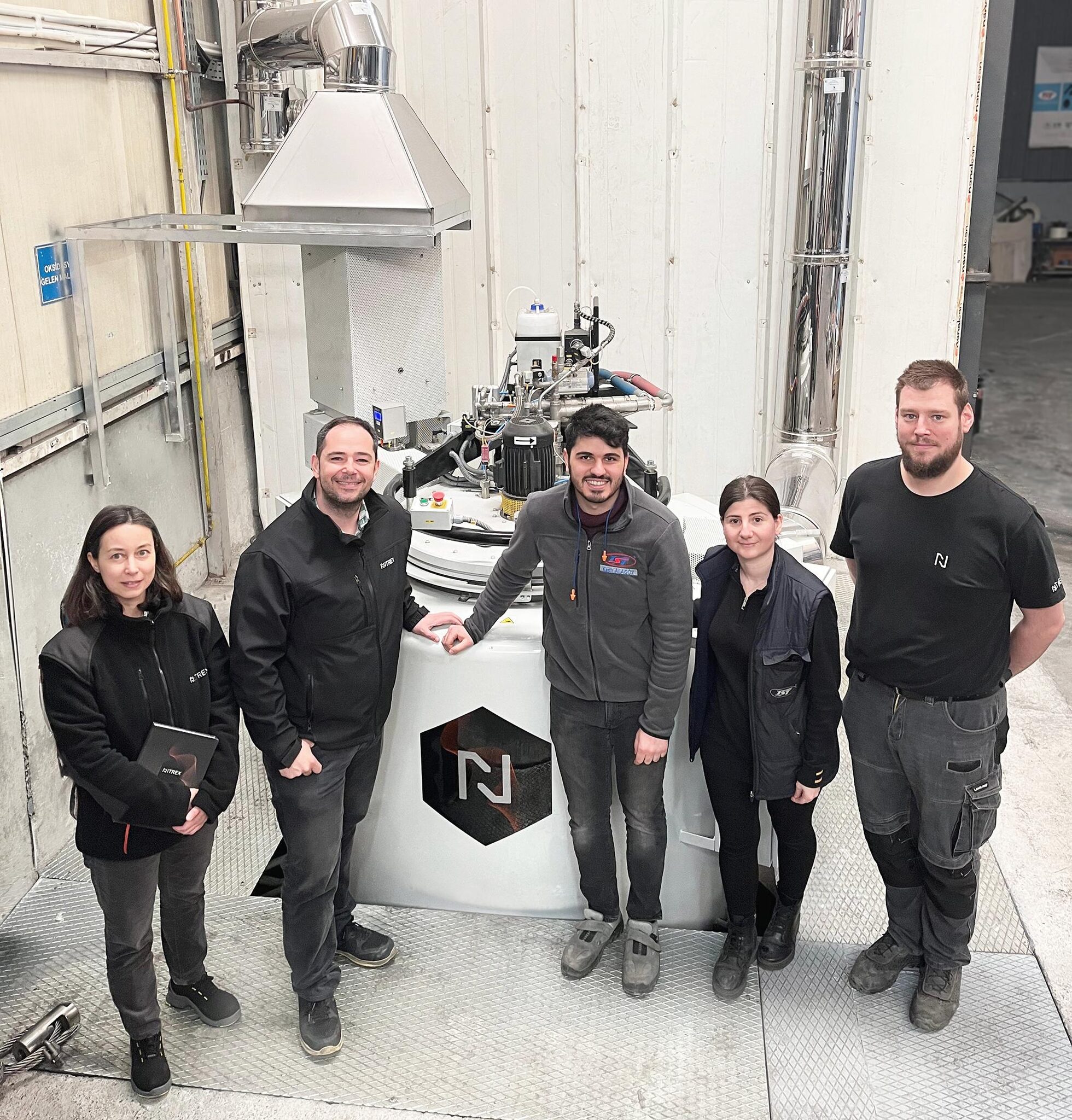

“T.Ş.T Lift Amortisör recently upgraded its gas spring manufacturing in Bursa, Türkiye, by integrating a Nitrex nitriding/nitrocarburizing system. This move signifies the company’s commitment to adopting environmentally sustainable practices within its operations. Through this upgrade, T.Ş.T Lift replaces traditional salt bath nitrocarburizing with Nitreg® technology to enhance both the quality of its spring products and the efficiency of its manufacturing facility using a greener alternative.
The Nitrex system offers a comprehensive solution featuring three advanced heat treatment technologies that enhance the customer’s production capabilities: Nitreg® for controlled nitriding, Nitreg®-C for controlled nitrocarburizing, and ONC® for in-process post-oxidation, tailored specifically for treating gas spring rods for automotive, industrial, and furniture applications. These technologies ensure precise control over uniform case depths and nitride / nitrocarburizing layer formation, enhancing the mechanical properties of the gas spring rods. While Nitreg® and Nitreg®-C enhance surface hardness and fatigue resistance, ONC® improves corrosion resistance and the aesthetic appeal of the finished product.
The batch-type furnace, equipped with an accelerated cooling system, is a nod towards efficiency. It shortens process times, expediting lead and delivery times while optimizing furnace utilization to drive cost savings. Additionally, since the system operates at lower temperatures compared to salt bath nitrocarburizing, it minimizes part distortion and eliminates the need for post-finishing operations by delivering a cleaner surface, streamlining the manufacturing process.
