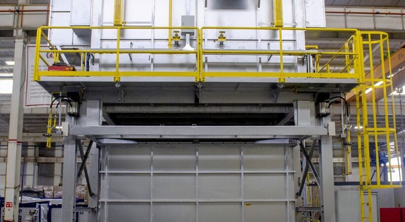

“Nutec Bickley has manufactured a heat treat drop-bottom furnace designed for heat treatment of aluminium castings. The furnace will shortly be installed and commissioned at a facility operated by a multinational power solutions corporation. The custom-designed furnace is indirect gas fired using radiant tube burners, and this project also incorporates a motorised quench tank, rails, movement system and load/unload platform with elevator device.
The furnace will have a load setting of 123cm wide x 91cm high x 358cm long. This will accommodate up to three baskets, equivalent to around 1635kg of aluminium parts per cycle.
Given the nature of the process, this furnace has a single temperature control zone, and it normally operates at 573°C, with a maximum of 580°C. There is an upper limit temperature controller to protect the product and furnace insulation from overheating.
