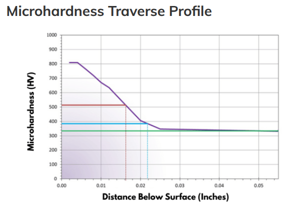

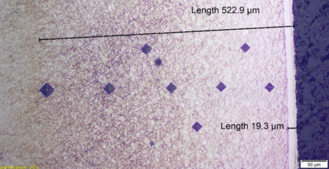

Effective Case Depth (ECD) is defined as the depth to a particular hardness value. On a metallographic mount, microhardness testing (Vickers- HV or Knoop- HK) is performed at standard intervals (this is called a “microhardness traverse”) on the cross-section. The resultant hardness values are plotted against the depth for each indentation. The depth to the desired hardness value is then interpolated.
Figure 1. Graph (microhardness vs depth) associated with Figure 2.
In Figure 1, the red horizontal line represents 50 HRC equivalent (513 HV). The intersection of the red line with the hardness curve (purple) determines the resultant ~0.016” effective case depth (at 50 HRC).

Total Case Depth (TCD) is defined as the full or complete depth of atomic (nitrides/nitrogen or carbon) diffusion. For some steel alloys, TCD can be evaluated visually after etching with an appropriate acid to reveal the diffusion layer. For steel alloys that DO NOT reveal the diffusion layer, a microhardness traverse is performed. The resultant hardness values are plotted against the depth for each indentation. The full microhardness traverse is used to calculate the TCD, based on the extent of hardness drop from near-surface hardness to core hardness.
Note: TCD is typically defined as the depth to 50 HV or 50 HK above the core hardness average. Alternatively, TCD can be defined in other ways, such as the depth to 110% of the core hardness average.
In Figure 1, the green horizontal line represents the core hardness average of 334 HV. The blue horizontal line represents hardness value of 50 HV points above the core hardness average (50 HV + 334 HV= 384 HV). The intersection of the blue line with the hardness curve (purple) determines the resultant ~0.022” total case depth.
Figure 2. Nitrided medium alloy steel showing compound zone (white layer) at the surface and nitride diffusion zone. Hardness indentations shown are produced using Vickers indenter (HV).

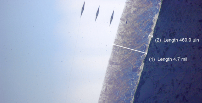

Figure 4. Nitrided stainless steel (17-4 PH) showing sharp transition from case to core. Hardness indentations shown are produced using Knoop indenter (HK).
