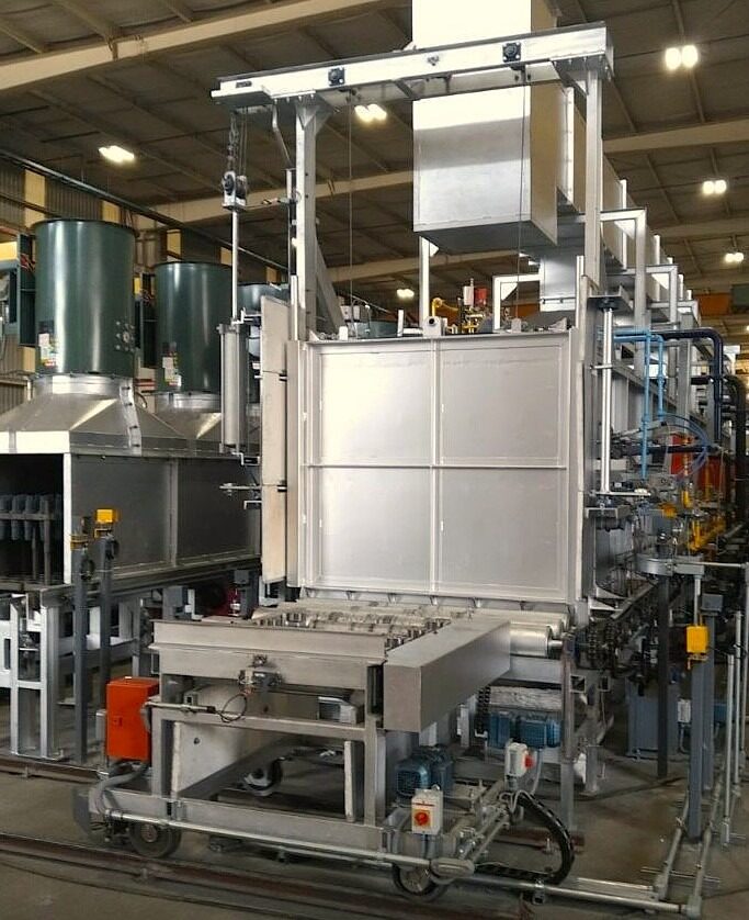

At the heart of the new facility will be a double pusher tray high-temperature furnace (HTF) that will process carbon steel automotive parts. The furnace will incorporate a fully automatic electrical double pusher system with steel trays sliding over rails with idle rolls. Processing two trays across the width helps reduce the length of the line.
This natural gas unit has four automatic temperature zones, each with two high-velocity nozzle-mix burners that provide excellent turbulence and outstanding recirculation within the furnace chamber. The burners are positioned on top of the sidewalls of the unit, mounted to fire horizontally above the load.
The operating temperature is between 850°C and 950°C (1560°F-1740°F). As with all NUTEC Bickley projects, achieving temperature uniformity is a priority, and the broadest aims here are ±5°C for processes below 680°C, and ±10°C at or above 680°C. The combustion program is based on pulsed firing, with all the latest control software for this type of system.

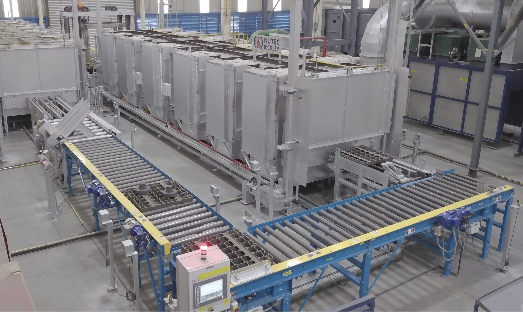

In addition to the HTF, ICC, LTF and BCT, NUTEC Bickley is supplying all the external and conveying equipment for this line, including entrance and transfer cars, complete with car movement system; transfer car tracks; exit transfer cars, with tray dumper unit and car movement; integrated air cooling unit; return conveyor, with electrical dolly system to move trays to the transfer car; and loading station, directly on trays at the transfer car, featuring a carbon steel basket with a lift-rotation movement via a pneumatic cylinder system. The parts handling system operates fully automatically and is linked to the whole process via the Master PLC and HMI."
