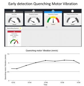

Case #1. Customer Finds Value in PdMetrics® for Older Furnaces
While PdMetrics is usually installed on new furnaces to keep production running smoothly, a common misconception is that PdMetrics doesn’t belong on older equipment. One of our customers decided to invest in PdMetrics for their furnaces which were respectively 18 and 31 years old. The investment was phased in starting with the 18-year-old system first. After testing, the customer was satisfied with the software and decided to retrofit the second furnace.
As furnaces age, the risk and frequency of unplanned downtime increases significantly. During the same week, PdMetrics caught three major events for this customer, including an abnormal vibration issue on the quenching motor. The customer fixed these issues within a day. Early detection allowed the customer to avoid extended downtime and part quality issues. Without PdMetrics, these events are difficult to detect. In this case, PdMetrics showed a significant return on investment saving the customer about $60,000.

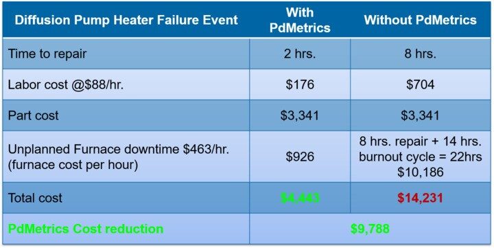

Case #3. PdMetrics® Mitigates Diffusion Pump Fluid Backstreaming
PdMetrics detected a low KW reading on a diffusion pump, meaning one or more of the heaters stopped functioning. As a result, the diffusion pump fluid could not reach optimum operating temperature, resulting in backstreaming into the hot zone. The customer was informed of the condition, but was unable to stop the furnace to make repairs at the time due to production requirements.
After a few weeks, PdMetrics detected the resistance to ground on the heating elements had transitioned from a GREEN condition to a YELLOW condition. A yellow condition means that the hot zone is becoming contaminated and the ceramics need to be cleaned. The customer decided to inspect the hot zone and noticed oil residue was present on the furnace cold wall as well as the bottom of the front chamber door. The customer then inspected the diffusion pump heaters to find that there were indeed issues that required intervention (what PdMetrics informed them of a week prior).
Had they acted upon the PdMetrics recommendations, they could have prevented the contamination and additional furnace downtime. Below is a general cost comparison demonstration with and without PdMetrics.
Situation #1: Furnace was running with PdMetrics; diffusion pump heater failure had been detected early on avoiding catastrophic failure
  • Time to repair: 2 hrs.
  • Labor cost: $176 (2 hrs. @ $88/hr.)
  • Part cost: $3,341
    • (2) Heaters
    • (2) Crush Plates
    • O-ring Kit, cold cap
  • Unplanned Furnace downtime: $926 (2 hrs. @ $426/hr.)
  • Total cost: $4,443
Situation #2: Furnace was not running with PdMetrics (or customer did not follow PdMetrics recommendation)
  • Time to repair: 8 hrs.
  • Part cost: $3,341
    • (2) heaters
    • (2) Crush Plates
  • Burn out cycle: 14 hrs.
  • Unplanned Furnace downtime: $10,186 (22 hrs. @ $426/hr.), 8 hrs. repair + 14 hrs. burnout cycle
  • Total cost: $14,231
In this instance, PdMetrics would have saved the customer $9,788.

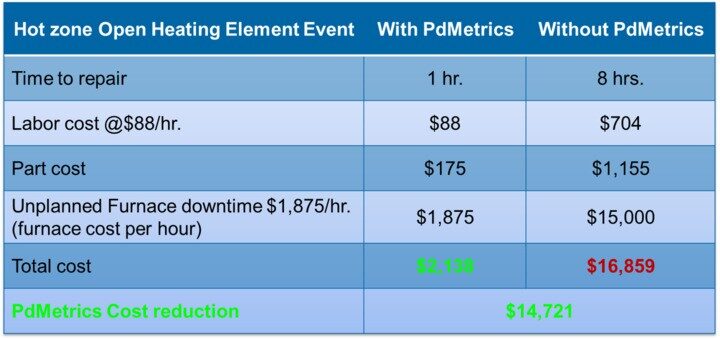

Case #4: PdMetrics® Brilliantly Augments a Fully Lights Out Automated Operation
Recently, PdMetrics detected an open heating element on a customer’s furnace, avoiding excessive hot zone repairs and contamination and furnace downtime. This furnace is implemented into a fully automated line running three shifts per day, seven days a week. The customer was able to halt production to fix the problem.
Without PdMetrics, the open heating element could have remained undetected for at least one additional shift or until the quality team discovered product issues that failed adherence to their metallurgical specifications. Such a situation could have led to full work stoppages and parts recalls. This could have meant 24 hours of lost production and combined quality assurance time invested.
The average cost of unplanned furnace downtime is estimated at $15,000 per shift or $1,875 per hour. We ran a furnace downtime cost comparison with and without PdMetrics based on this particular open heating element discovery:
Situation #1: Furnace was running with PdMetrics; open heating element had been detected early on avoiding catastrophic failure
  • Time to repair: 1 hrs
  • Labor cost: $88 (1 hr. @ $88/hr.)
  • Part cost: $175.00 stud and washer
  • Unplanned Furnace downtime: $1,875 (1 hr. @ $1,875 furnace cost/hr.)
  • Total cost $2,138
Situation #2: Furnace was not running with PdMetrics; melted heating element replacement along with a contaminated hot zone
  • Labor cost: $704 (8 hrs. @ $88/hr.)
  • Part cost: $1,155 (2) graphite heating elements, bolts and washer
  •  Unplanned furnace downtime: $15,000 (8 hrs. @ $1,875 furnace cost/hr.)
  • Total cost: $16,859
PdMetrics saved the customer $14,721 in total parts, manpower and downtime.
