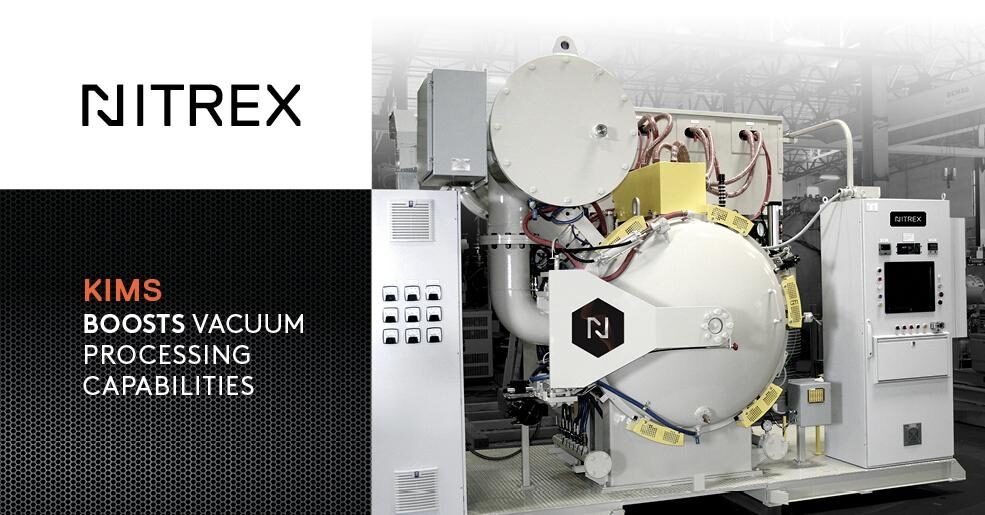

The NITREX vacuum furnace is a horizontal type 2-Bar external quench equipped with a curved Moly wide band heating element arranged in a circular configuration around the main hot zone. This exclusive free-floating design ensures optimum temperature uniformity throughout the chamber. Since the heating elements are in free movement during thermal expansion, there are fewer instances of breakage, twisting, or premature failures. Its work area measures 15″ in width by 15″ in height by 24″ in length (381 x 381 x 610 mm), and it has a heavy-duty “TZM” Molybdenum hearth assembly that supports high temperatures.
The furnace’s ability to process superalloy and high-performance alloy components and enhance their structural and surface integrity is especially important for KIMS. “The NITREX system not only offers this metallurgical advantage but is also robust, capable of running for years, and can support a wider range of R&D projects and metals,” said Nikola Dzepina, NitrexRegional Manager – Asia. “With the ability to achieve higher vacuum levelswith 10-6 Torr ultimate range, the furnace can heat-treat parts at temperatures up to 1,371°C (2,500°F), making it an excellent choice for processing parts that operate in extreme environments such as those found in the aerospace and precision part industries.” The installation and startup were overseen by NITREX’s local representative, Aerotech. The vacuum furnace has been in operation since December 2022.”
