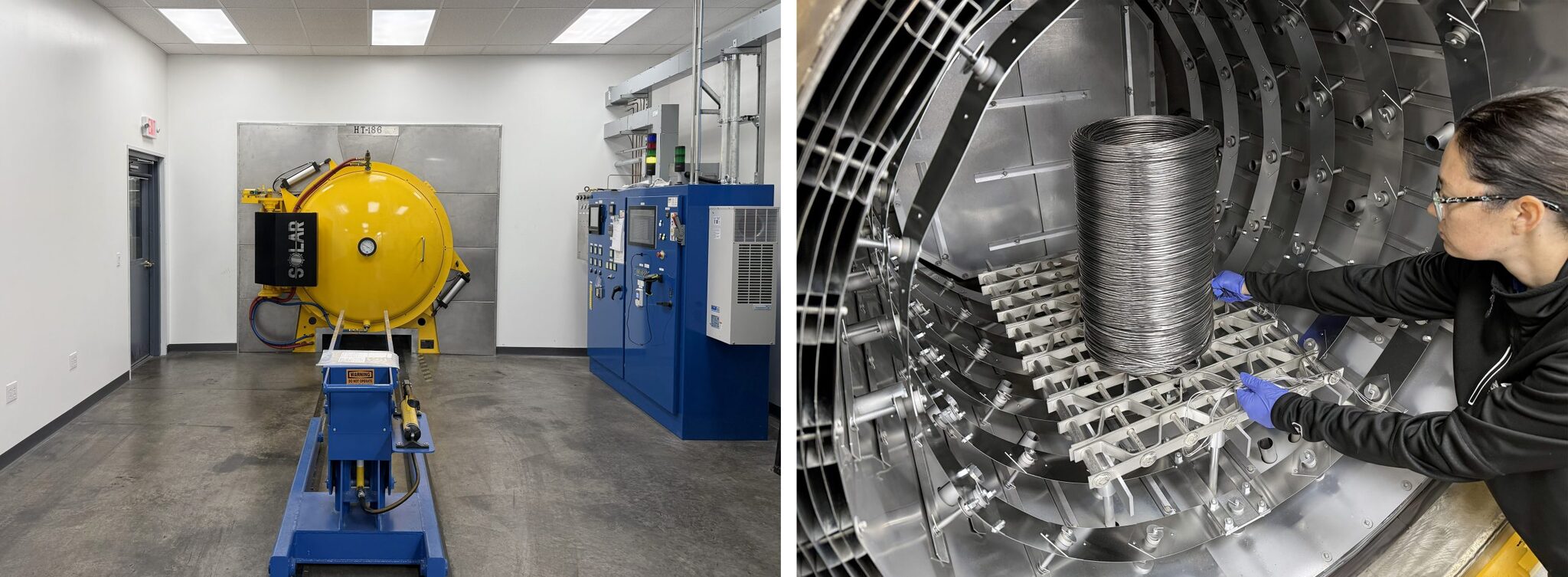

“This installation marks the second all-metal hot zone vacuum furnace added to the climate-controlled processing area at Solar Atmospheres’ Hermitage, Pennsylvania facility. The new system significantly expands the company’s capacity to heat treat highly sensitive materials such as precipitation-hardened stainless steels, nickel-chrome-based superalloys, titanium, and niobium.
Engineered for precision and performance, the furnace incorporates strategically placed isolation valves, an oversized main valve, a high-capacity diffusion pump, and a polished stainless-steel chamber. Together, these features create an ultra-clean processing environment that meets the stringent demands of the aerospace and medical industries. Capable of achieving vacuum levels below 5 x 10⁻⁶ Torr, the system ensures bright, contamination-free results.
