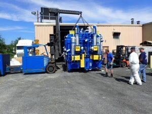

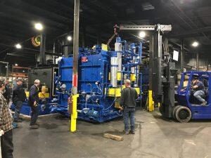

April 18th as part of our regular “Monday Morning Briefing” we mentioned that commercial heat treater Bluewater Thermal in St. Marys, PA, USA was in the process of adding another batch IQ furnace “The Monty Heat Treat News” Monday Morning Briefing | The Monty With the assistance of the “Bluewater Team” we can now provide you all the details about what the firm is adding and what they currently have. “The new equipment being added to our Saint Marys, PA facility consists of:

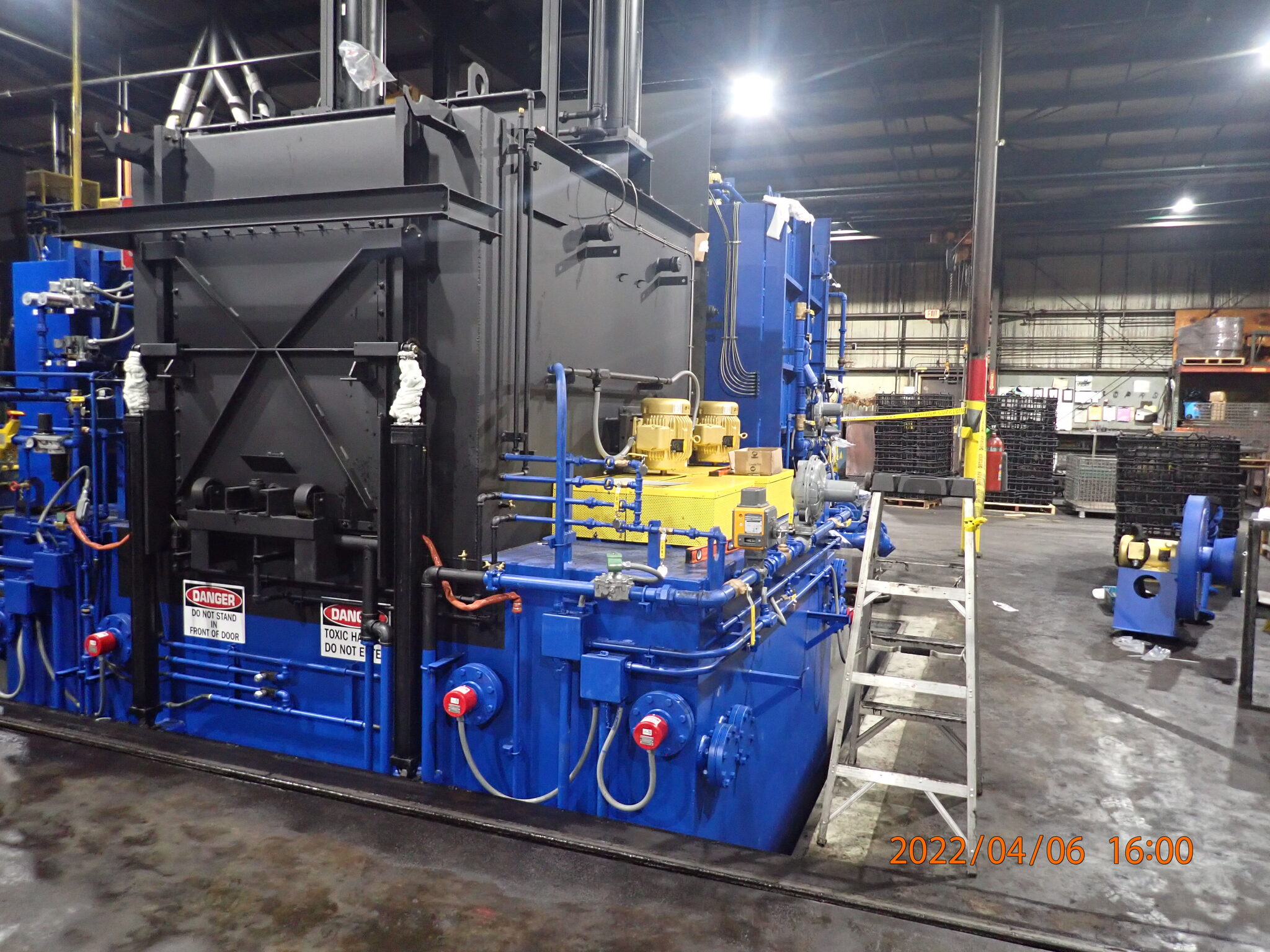

  • Surface Combustion Super 36/72 Allcase Batch I/Q Furnace (36x72x36)
  • Surface Combustion Super 36/72 P/M Uni-Draw (36x72x36)
We took delivery on April 6 and are in the process of start-up/commissioning this week. This is our 5th Super 36/72 Surface Allcase I/Q and our 7th Super 36/72 Uni-Draw to be added to our Super 36 line. We have been seeing significant growth in both our automotive and lawn & garden powder metal business segments leading to the need for additional batch capacity. We also offer:
