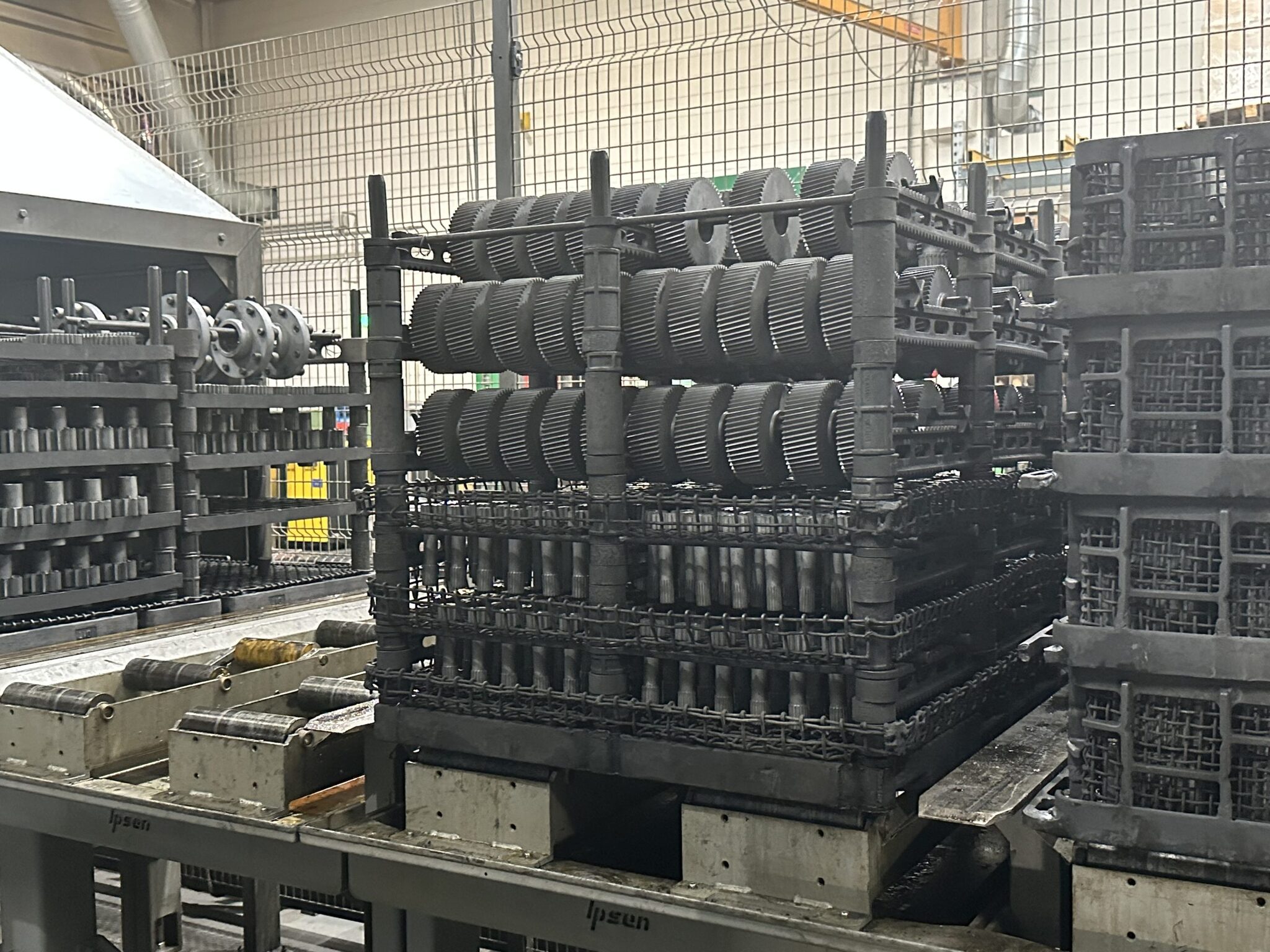

Basically parts are fixtured by hand (or largely by hand) with the fixtures placed in “racks” inside a fenced area surrounding the furnaces, tempers and washers. From here the operation becomes completely automated with a PLC controlled charge car moving the fixtured parts from the “racks” to the furnaces, washer and tempers before being unloaded and moved to a “finished” parts area.

The end result is that in 2021 the firm installed a Sealed Quench furnace line (batch IQ to our North American readers) which consisted of 2 high heat furnaces, one endothermic generator, one washer and two tempering units all supplied by Ipsen of Kleve, Germany. This installation proved to be such a success that in 2022 the company added another high heat furnace followed in 2024 by one more high heat furnace, one more temper and one more endothermic generator.
Each of the high heat furnaces has working dimensions of 760mm X 1220mm X 760mm (30″ X 48″ X 30″) and a weight capacity of 1,000Kg (2200 pounds)-all of the furnace do strictly carburizing. Each of the furnaces is heated by natural gas although the newest furnace is capable of heating with both natural gas and hydrogen.
