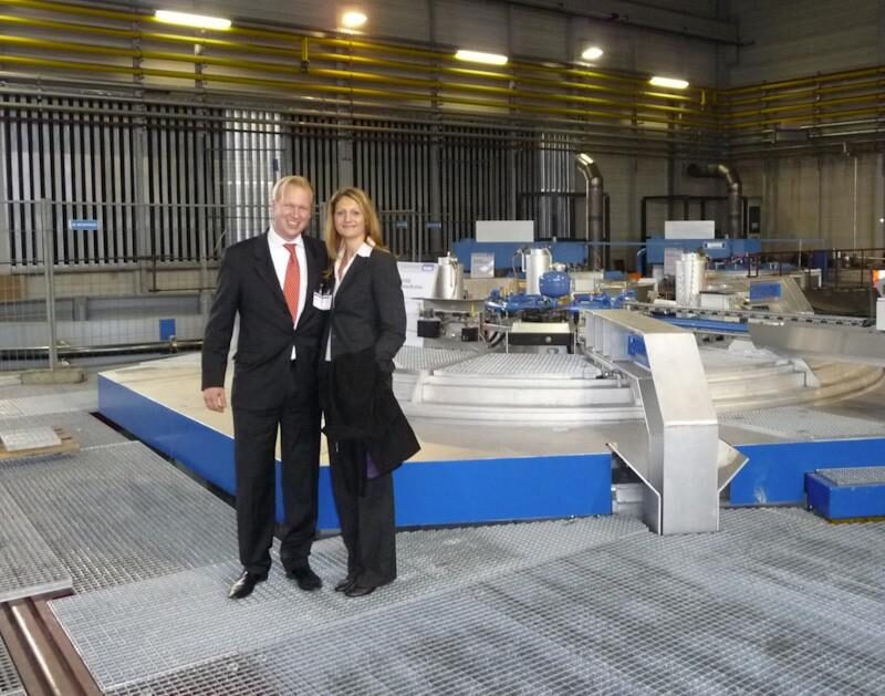

Is it true you have built the largest pit carburizing furnace in Europe?
“Yes, no one else wanted to or could build this furnace and we took on the challenge. This project was very exciting. No one had ever built a retort with a diameter of 5.5 meters (16.5’) before. As far as I know, such large furnaces were always built without a retort. We love the challenge! (Editors note; This furnace is located at commercial heat treater “Reese” in Germany and is very impressive).”
