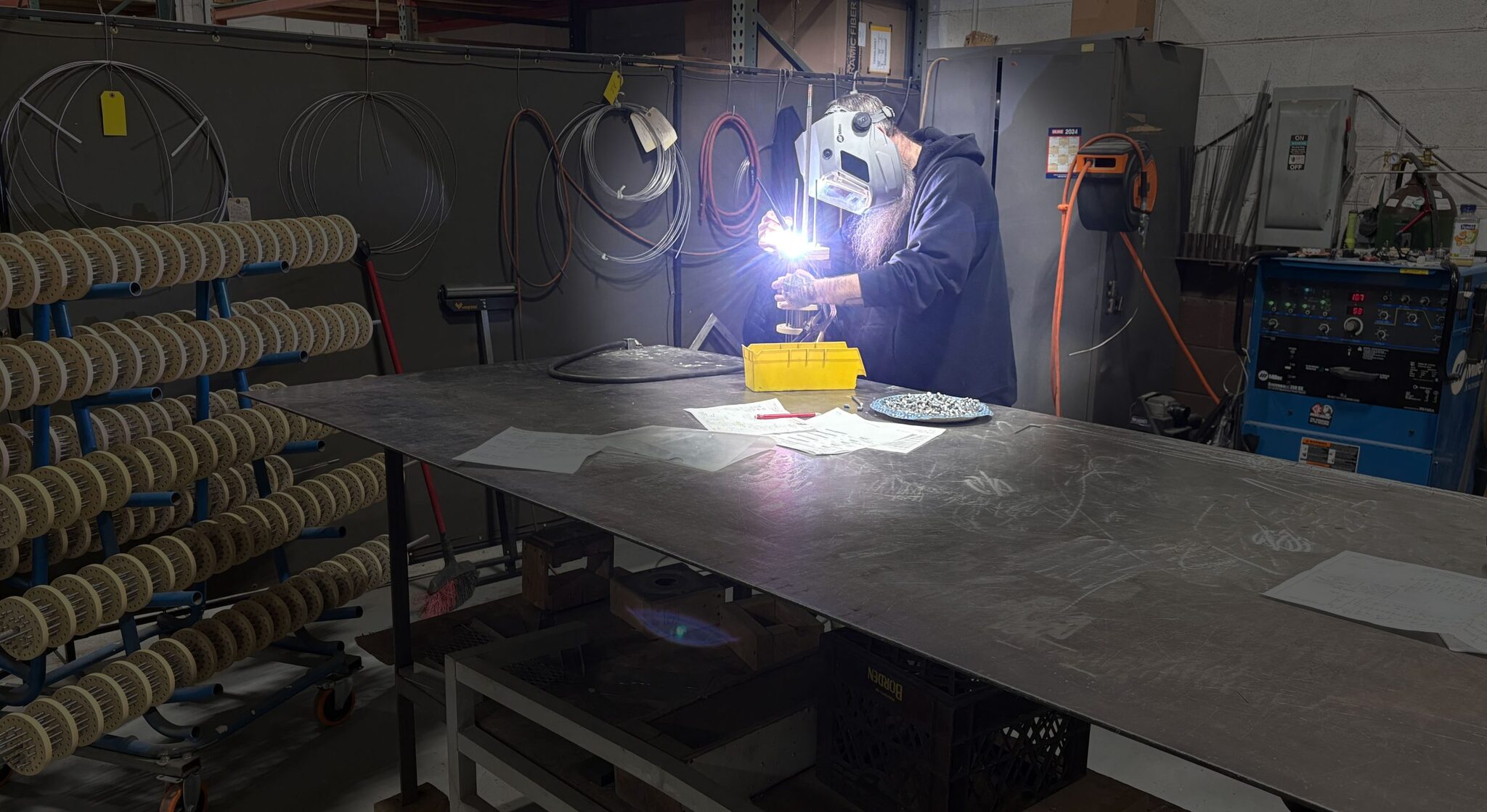

“Pretty much everything we do at US Element ties to heating elements, and historically, it’s all been custom—designed and built to order. We design & build products like bayonet elements and radiant tubes, even full furnace layouts with mounting hardware, all in 3D. But we’re shifting gears a bit. Take our plug heaters: designing them used to take 1-2 weeks. Now, by standardizing sizes, we’re slashing that time and speeding up the process. You can see some of our horizontal plug heaters in the image I shared—and these can be tweaked as needed. We also repair open-coil heaters, saving customers 25-50% compared to new ones. For furnace OEMs, our new semi-standard options mean faster turnarounds right from their design phase.”
