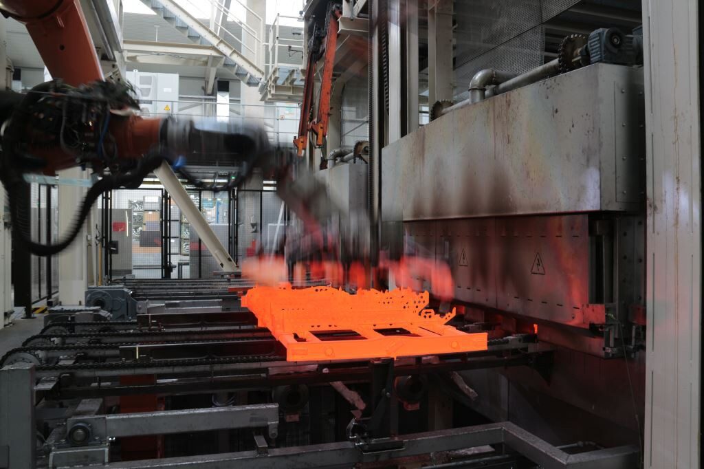

 I understand that Aichelin has a new product which you are quite proud of “heatXpress”-could you please tell us why you are so proud of this particular system?
The reason we are so proud of the new product, heatXpress, is easily explained: The step chain furnace has 10 major advantages compared to existing PHS (Press hardening Steel) heat treatment solutions.For example, the durability of the step chain transport system is more than 4 years in contrast to traditional systems using rollers, which must be replaced much more frequently.  Another example is the transport accuracy at every stage since there is no build-up of AlSi on the chains in the furnace.  A final example would be the tailored property options combined with the very short cycle times, which create an important advantage for companies who are looking for cost-effective PHS manufacturing. With our new product, heatXpress, AICHELIN has the right and best product for all PHS requirements now and in the future.        
