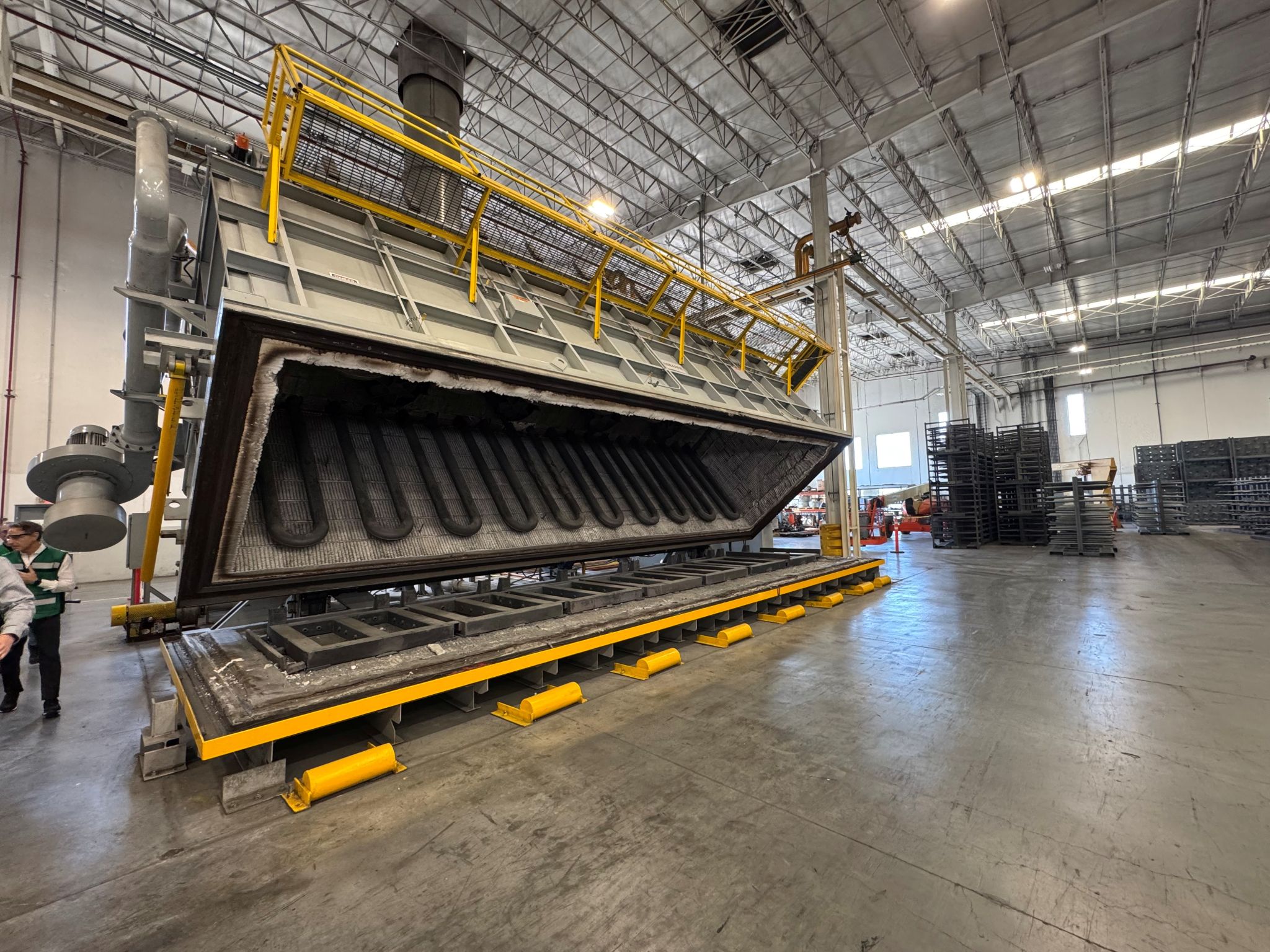

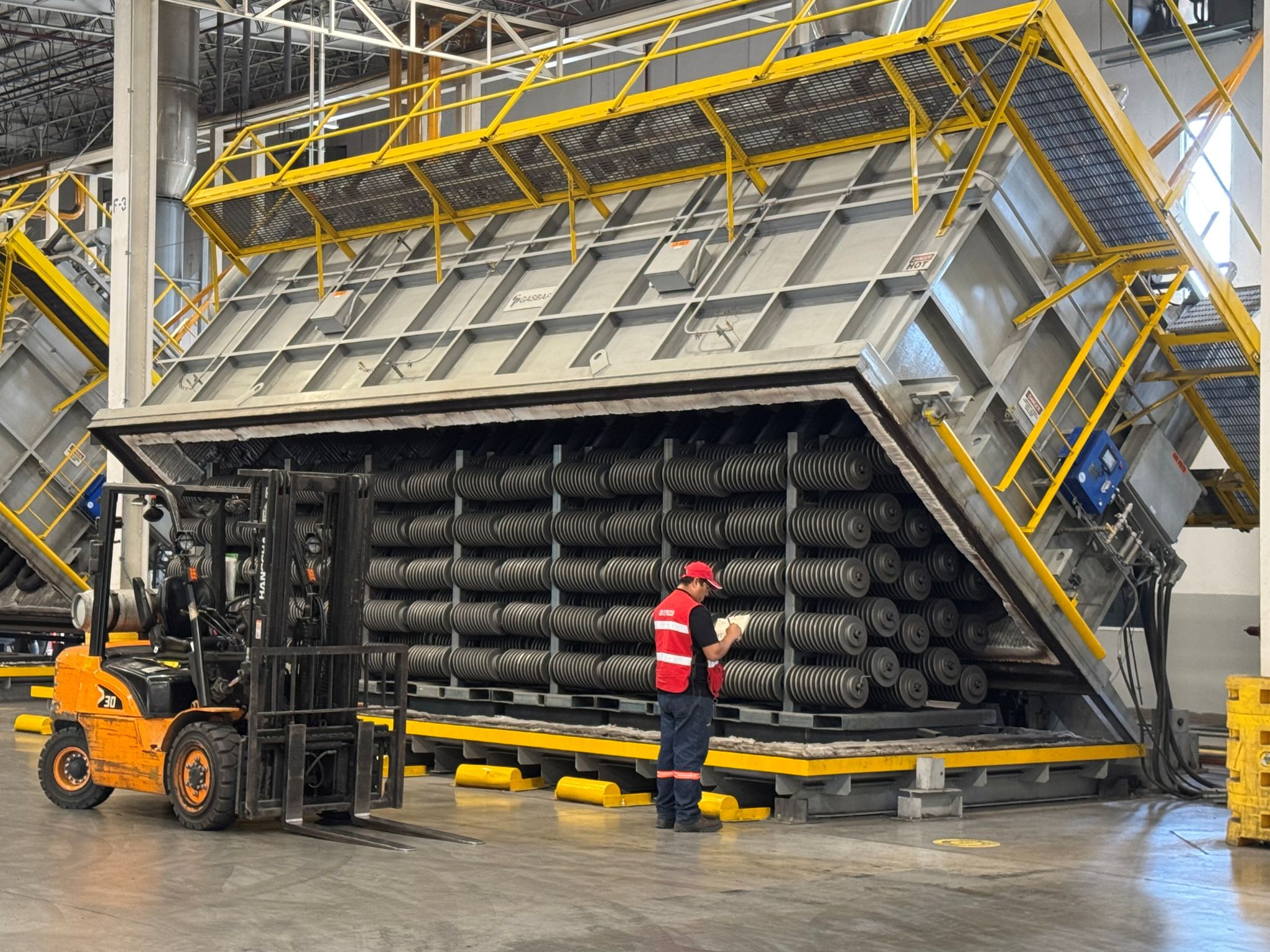

This success lead another other commercial heat treaters to enter this market, US based “Paulo” (now part of “Aalberts Surface Technologies”) set up a plant in “Monterrey, Mexico” in 2018 offering the same process in the same furnaces. The subject comes up today as “Aalberts” has recently been “showcasing” the plant, this includes these very interesting pictures showing one of the furnaces both empty and full.
