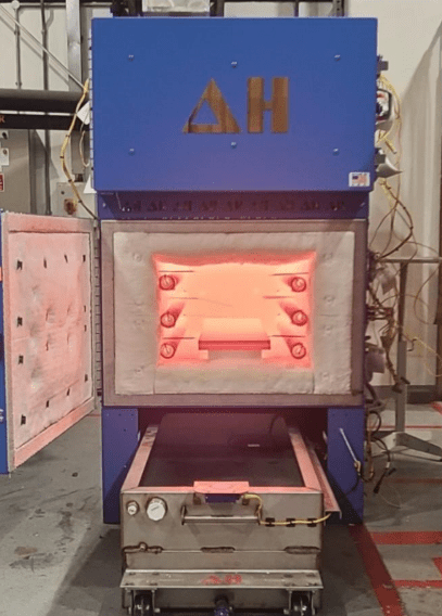

The dual-chamber system features:
· A radiant heat lower chamber (1,000°F–2,000°F, 12”W x 12”H x 48”D TUS volume) with inert atmosphere
· A convection heat upper chamber (200°F–1,200°F, 18”W x 12”H x 48”D) capable of rapid cooling from 1,000°F to below 200°F in under 30 minutes, allowing solution heat treating and aging (T6) in the same chamber before part freezing is required
· A dual-bath quench tank supporting both water and oil quenching
· Honeywell controls with MiniTrend recording, Instrumentation Type C (upgradeable to Type A & B), and secure batch data logging including soak times and quench delay recorded to 0.1 second to ensure full compliance and accountability

Final testing confirmed AMS2750 compliance with the convection chamber achieving Class 1 (±5°F) and the radiant chamber Class 3 (±15°F) uniformity. PMEL completed all calibrations, certifying the system for immediate aircraft parts processing.
