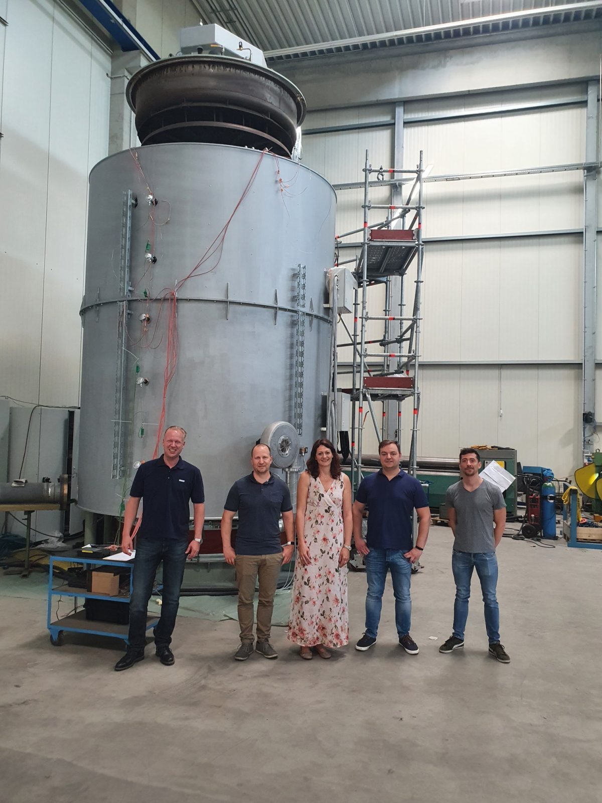

Rohde has delivered today a gas carburizing furnace with batch table and useable diameter of 2 m, and a depth of 3 m (79 x 118 in.) to Hanomag Lohnhaerterei in Hannover. The furnace is equipped with 5-zone heating (400 kW) and ROHDE online diffusion for carburization depths of up to 20 mm, carbon potential control via oxygen probe and gas analyzer. The picture was taken after the successful pre-acceptance warm test at the test field of the Rohde factory in Hanau.
The picture shows from left to right: Joern Rohde, Lutz Sperling (Hanomag), Natasha Rohde, Christian Gorecki (Hanomag), Maik Luedke (Hanomag).
