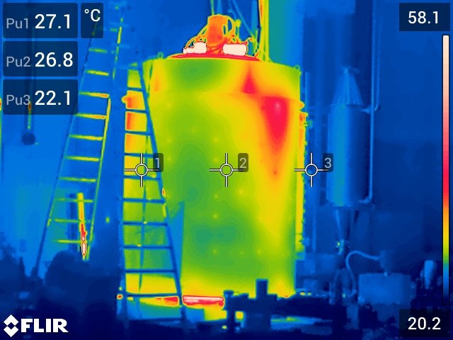

Special attention was paid to achieving maximum energy efficiency. The high-quality thermal insulation and optimized furnace design ensure that process heat remains exactly where it is needed: inside the working chamber. The thermal image shows the furnace after 4.5 hours of operation at 1,150 °C. The low external surface temperatures at the measuring points — approximately 26–30 °C — clearly demonstrate the excellent insulation performance and efficient use of energy.

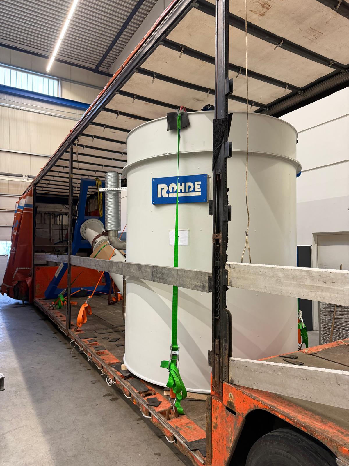

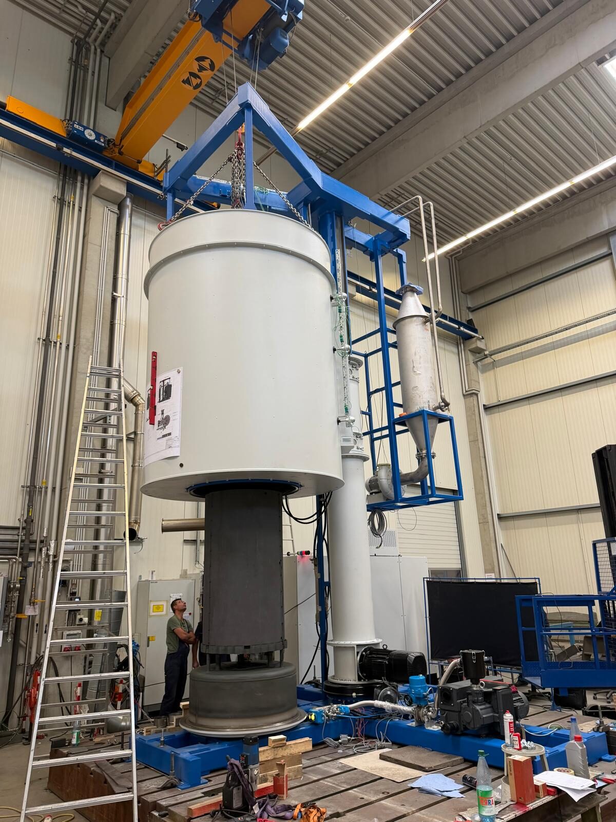

From loading and transport to assembly and final integration, this project demonstrates how modern furnace technology combines high process temperatures, safe hydrogen operation, short cooling times and sustainable energy efficiency.
